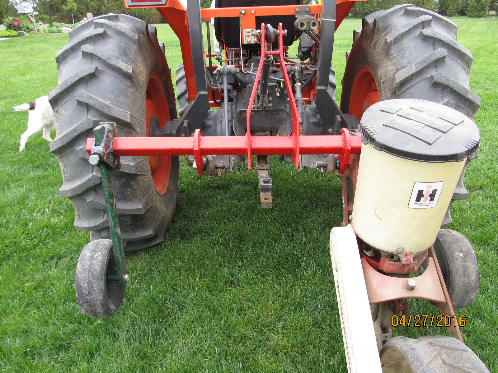

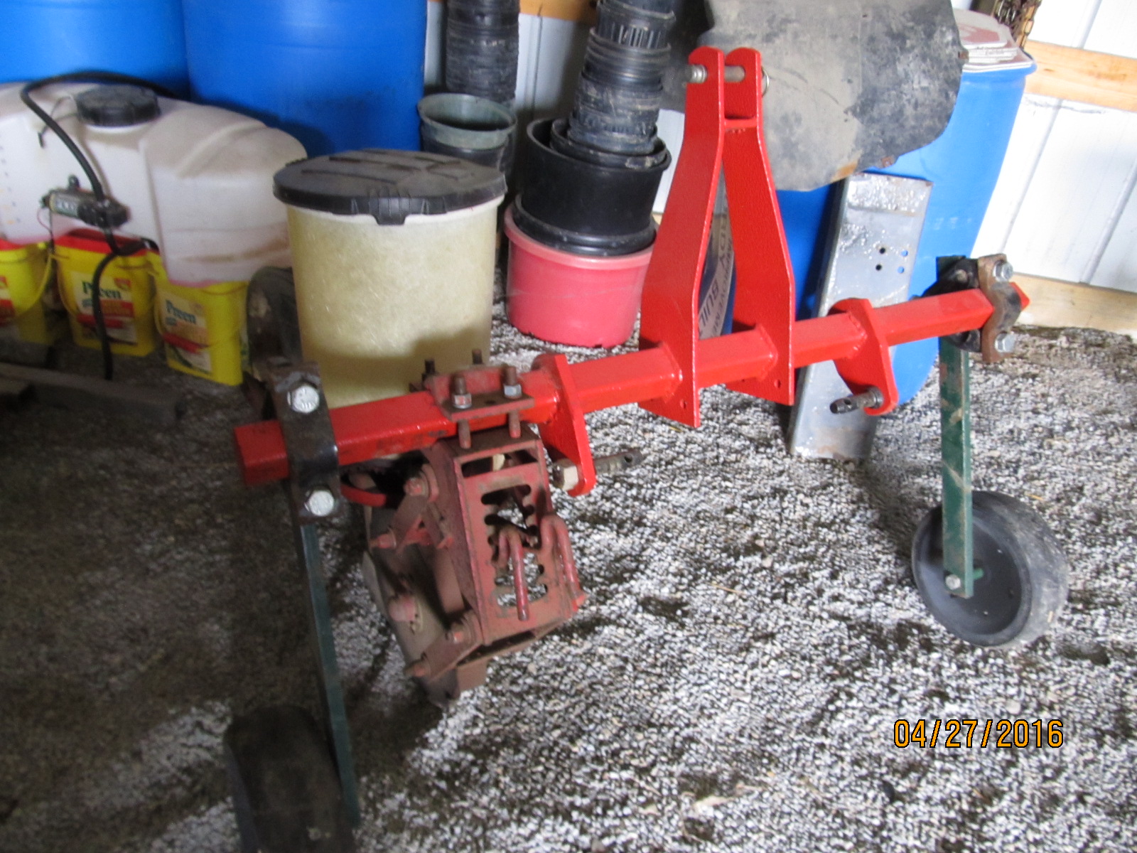

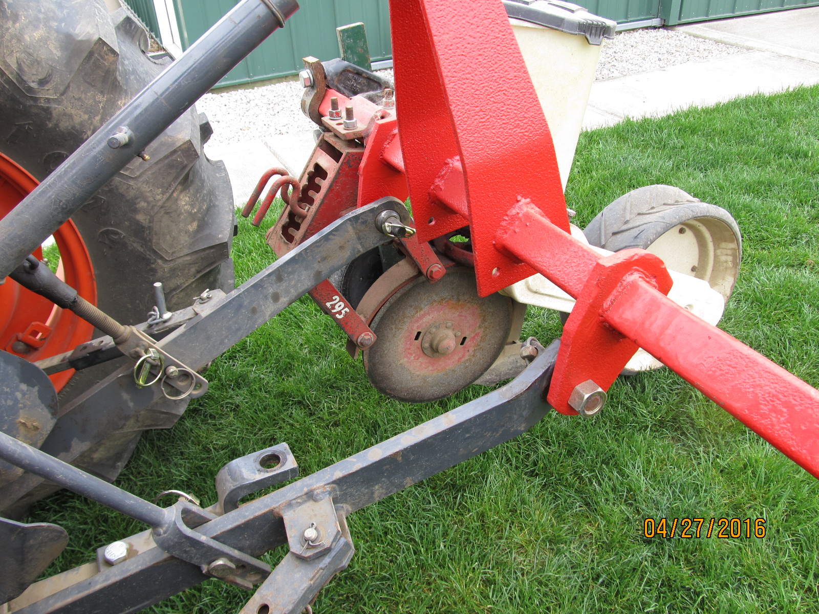

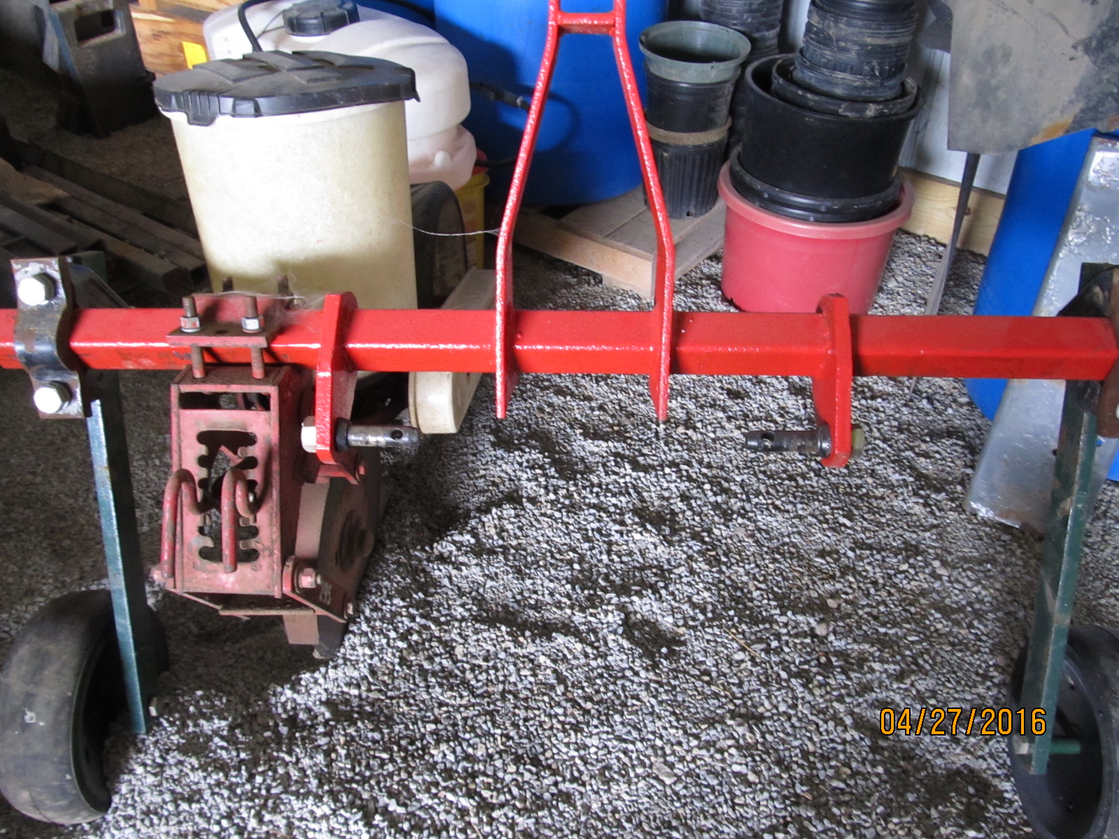

Forgot about this until I got ready to plant sweet corn. The frame is an old Ford cultivator toolbar that I turned the pins in on for clearance with the planter. That way I plant one direction and then turn around and head back in my tracks for a 30" row center. I think--but not certain--that it came from the factory with the same toolbar for cat I and II. Cat I had the pins turned in and Cat II turned out.
Anyway, I brought this in the barn and checked for lateral slop from the arms being closer together. There was some, but not as much as I expected. Just an FYI.
