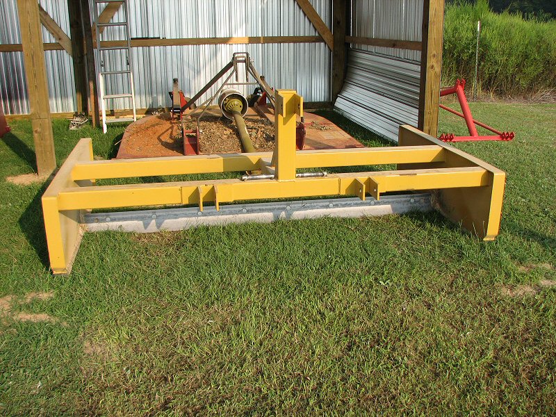

Got any pictures of your setup? Sounds interesting.

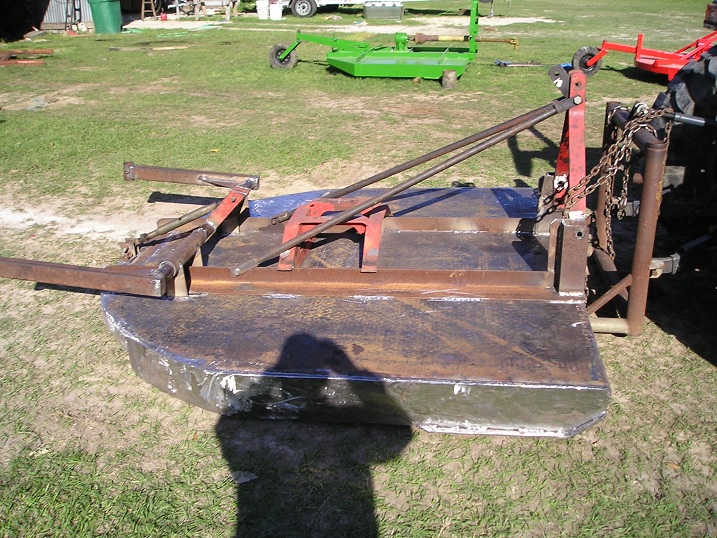

Here is mine. Photo of it when building a new deck and using the old gearbox and stump jumper. I had them change it from a single rear wheel to a dual to help keep it level AND help carry the 1500# load.
   / Any reason not to turn implement 3 point hitch pins inward? PIC #22
I don't think I do. I'll see if I can get some today if it's not raining too much around here.
