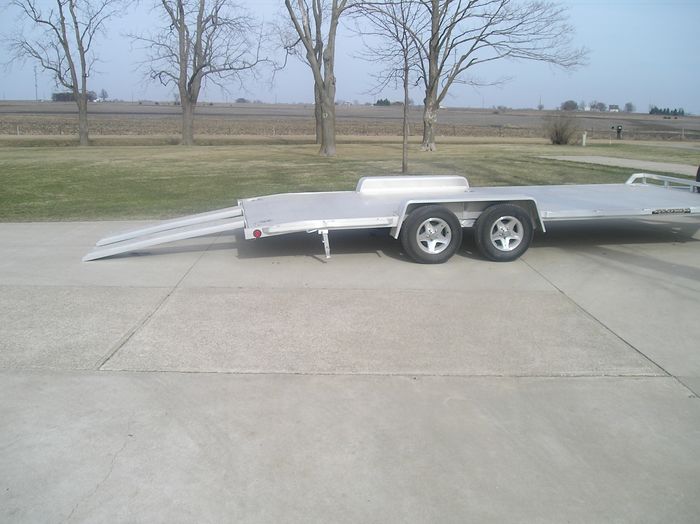

Ooohhhh.. That's very nice! :drool:
CADplans- I asked the dealer selling it about that and he said it was GTG. But that's definitely worth reaffirming with .gov, to be sure. d:^) Jake..

I just purchased a PJ 20' Buggy Hauler that has the wide deck. Only downside is the way PJ builds it with double rows of heavy channel down each side and the diamond plate to add the extra width adds a bit more weight for the size. But am very happy with it. Like you said the drive over fenders seem pretty roughed. I like I can load pallets from both sides. I thought about a deck over but carry a lot of vehicles and didn't like the thought of driving them up on a deck over. When I bought it I was at dealer looking at a tilt deck, but liked the buggy hauler better.
   / Any reason to NOT get the wider trailer?
#23
That's what I saw when I was talking with the dealer. The trailer itself is a little over 2300#.
But I reckon ya need the metal to hold yer stuff up off the pavement. ;)
I'm sure they don't just put extra material in it cause they like making less profit. :D d:^) Jake..
