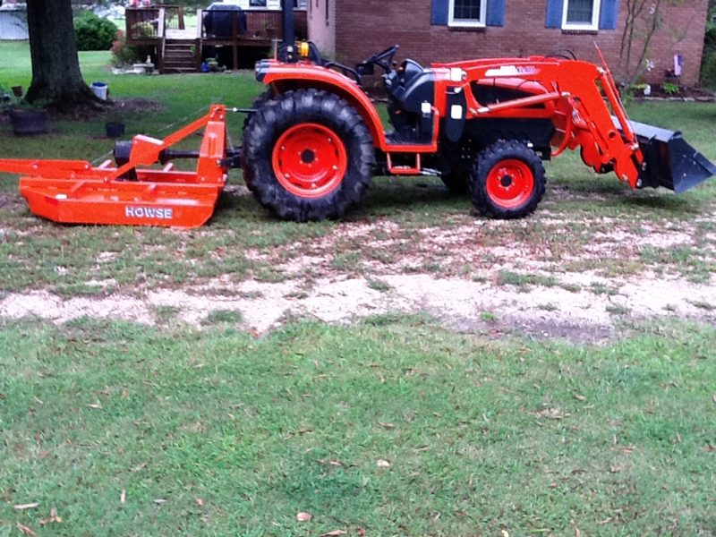

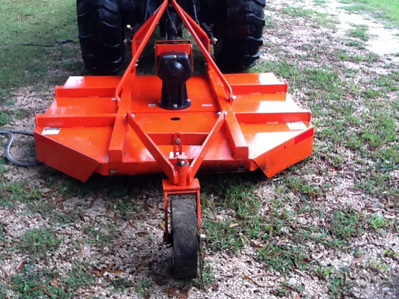

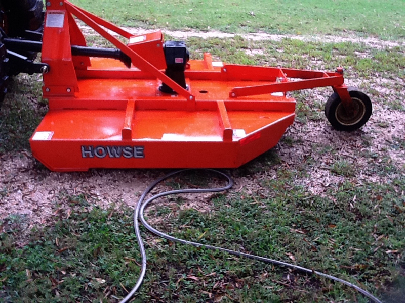

$500 scrap plus $899.90 plus "0lder sheet metal worn out, welded everywhere" would have me looking a heavier unit. Will try to post picks of new unit I bought within a few hundred of where you are.
Decisions, decisions.
RJ
Hope these help. Sometimes I buy new when the repairs get to be within a few hundred dollars of new. it is one of Howse's heavier duty models. I believe it was the 6100T. Just over 1000 lbs...100hp gear box and 3/16 inch steel reinforced with 3 inch tubing. My cost was $1800 but that's regional just like all implements. Good luck.p.s. I am in no way affiliated with anyone. Just like the best value for my money. Time will tell on this one.
