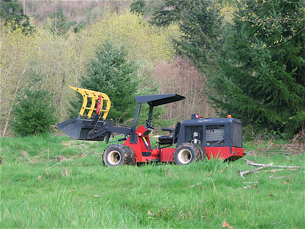

Carl, We would like to see a picture of your grapple. Did you buy it or build it?

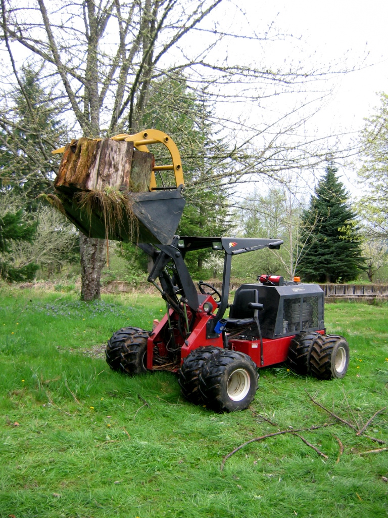

Purchased from Lackender Fabrication. Also bought the bucket from them as well. I don't have any specific photos of it. Hope these explain.

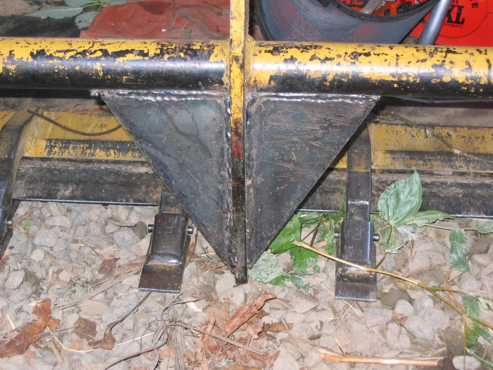

Also, I have added spacers on the teeth, triangle spacers. I kept bending the teeth....

Carl, Thanks, I had not seen the bucket and grapple before. Looking at the first picture, I think I can understand why you are breaking that swivel eye off the link rod. The geometry seems wrong. The lower leg on the rollover link has a mechanical advantage, and when the bucket is tilted up, that swivel eye becomes a weak point. especially when you push the bucket into a pile of dirt or whatever. Logically, if the link bar was hooked up higher on the bucket, you would have a better situation, Although I understand that the geometry to the Quick-Attach is fixed in place. I have the 3 pt hook up, and some of my attachments have a different placement for the lifting lugs. The closer the top lugs to the bottom lugs will give faster response, and the more separated, will give more force.
