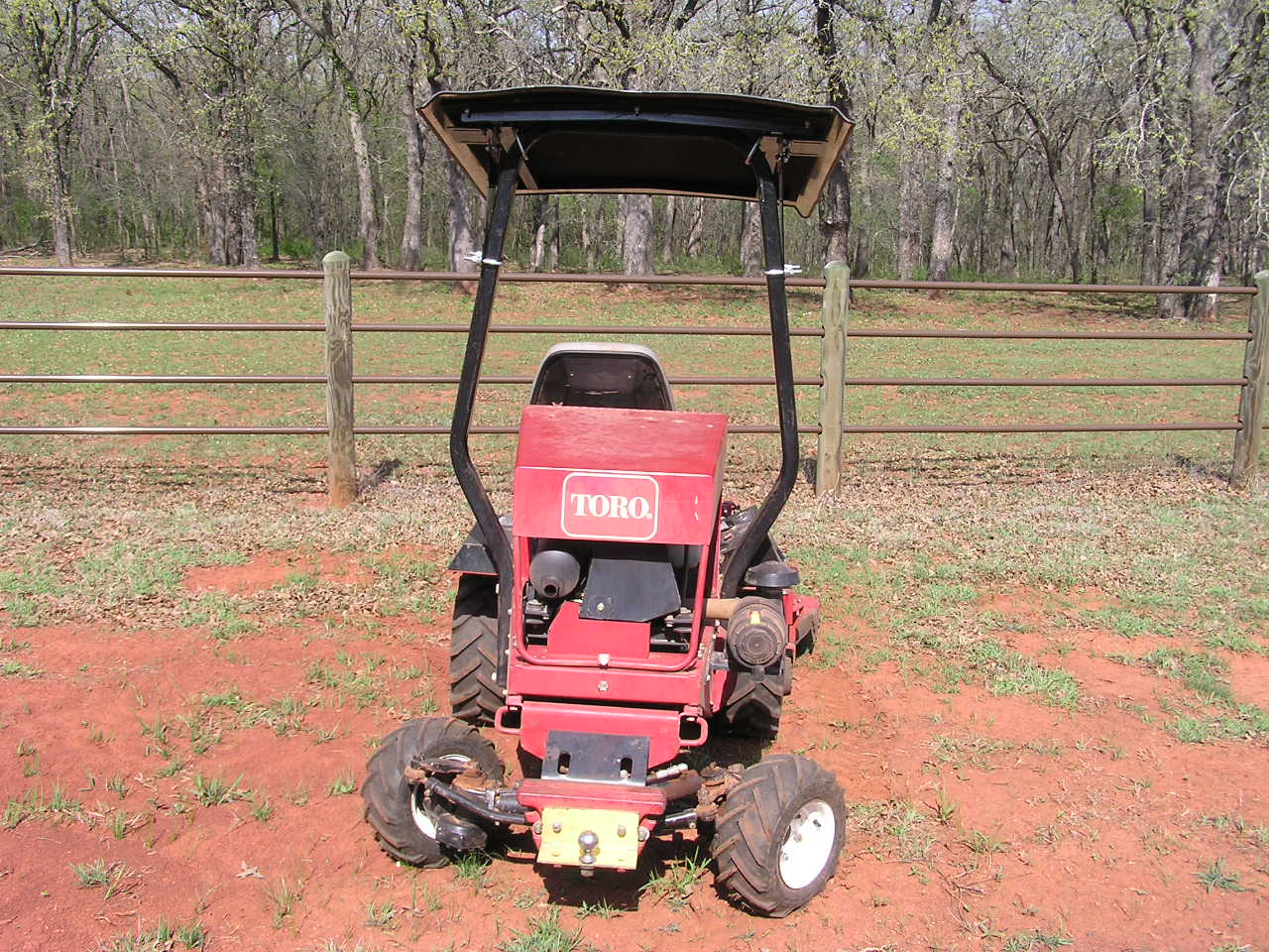

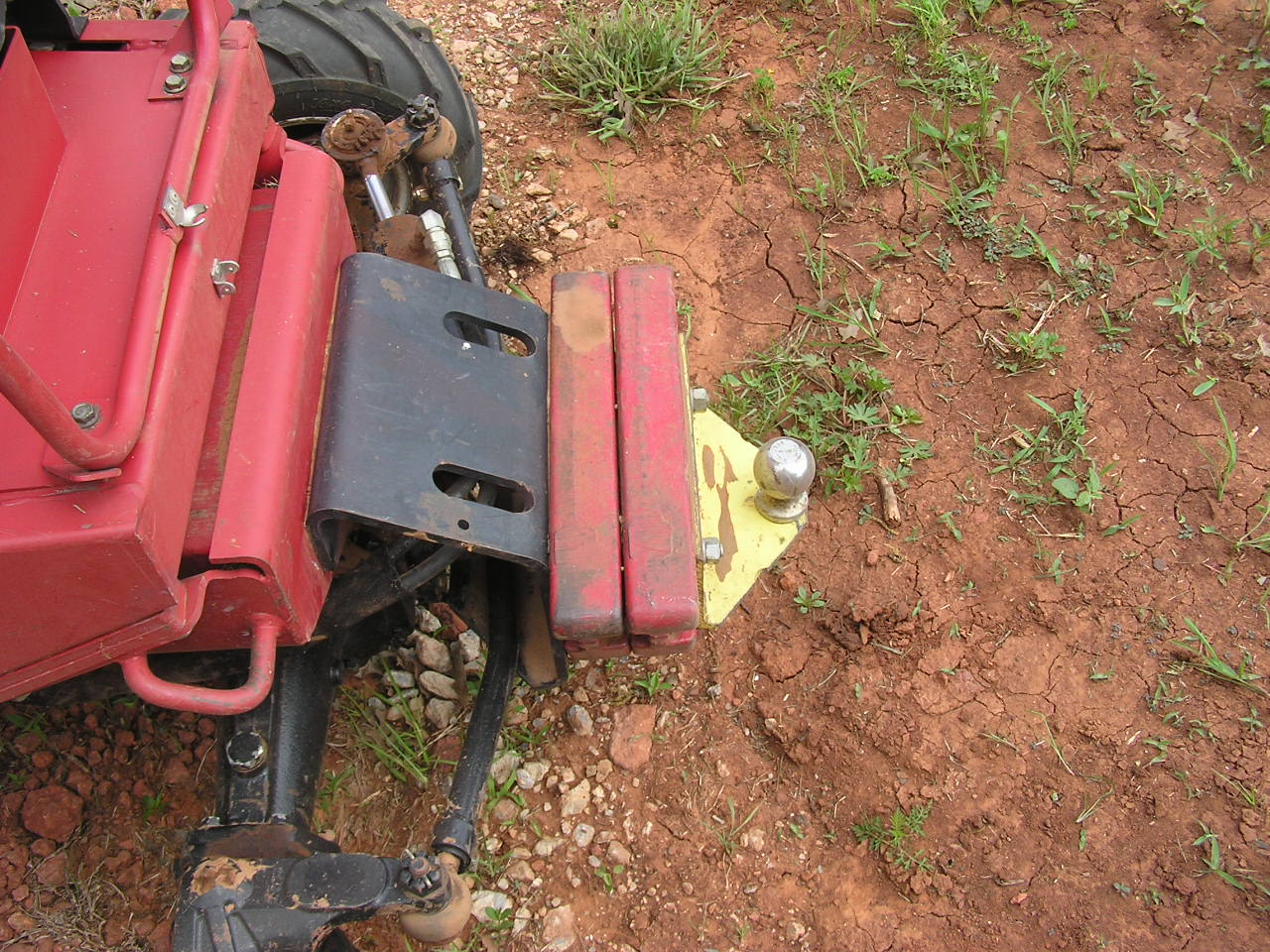

The trailer tongue hits the corner of the ball mount on sharp turns. :thumbdown:
Cut the corners off with the recip saw. :thumbsup:

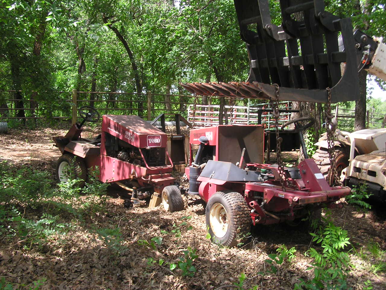

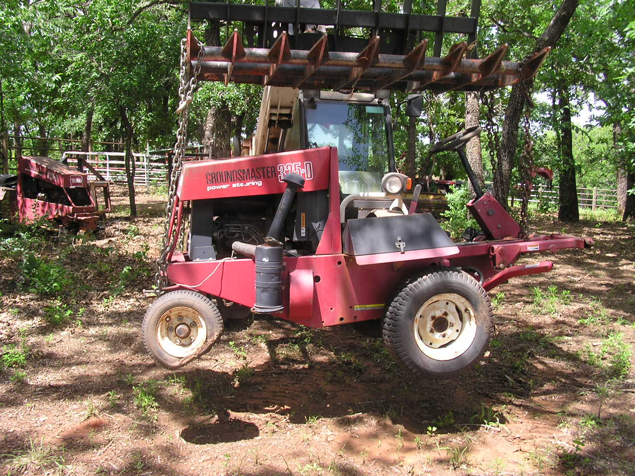

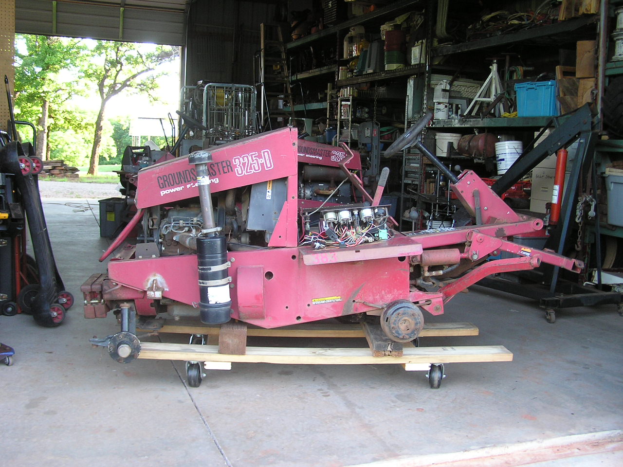

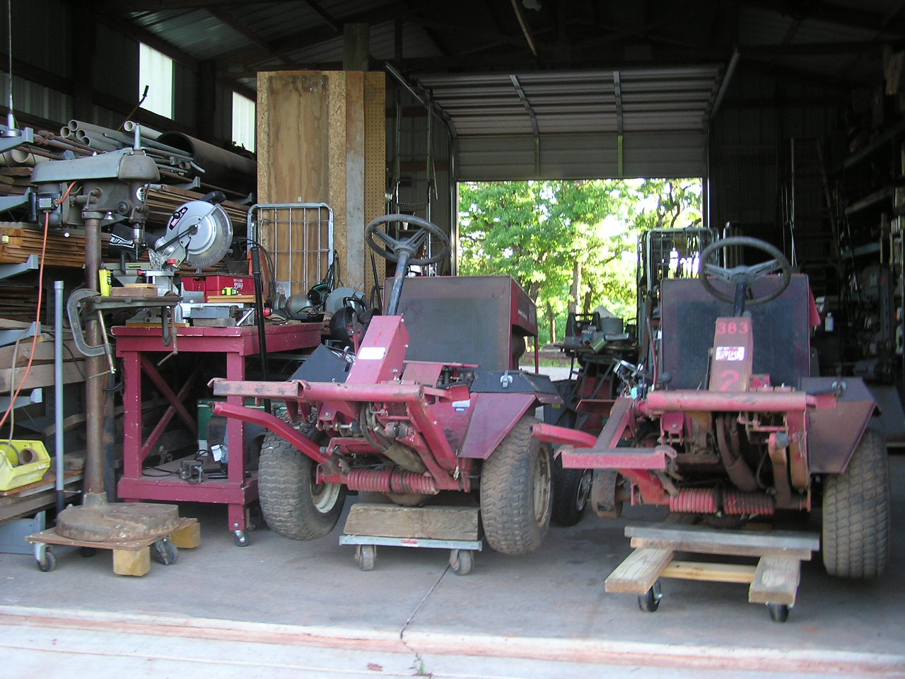

Moved the parts machines into the shop, now they are on dollies.

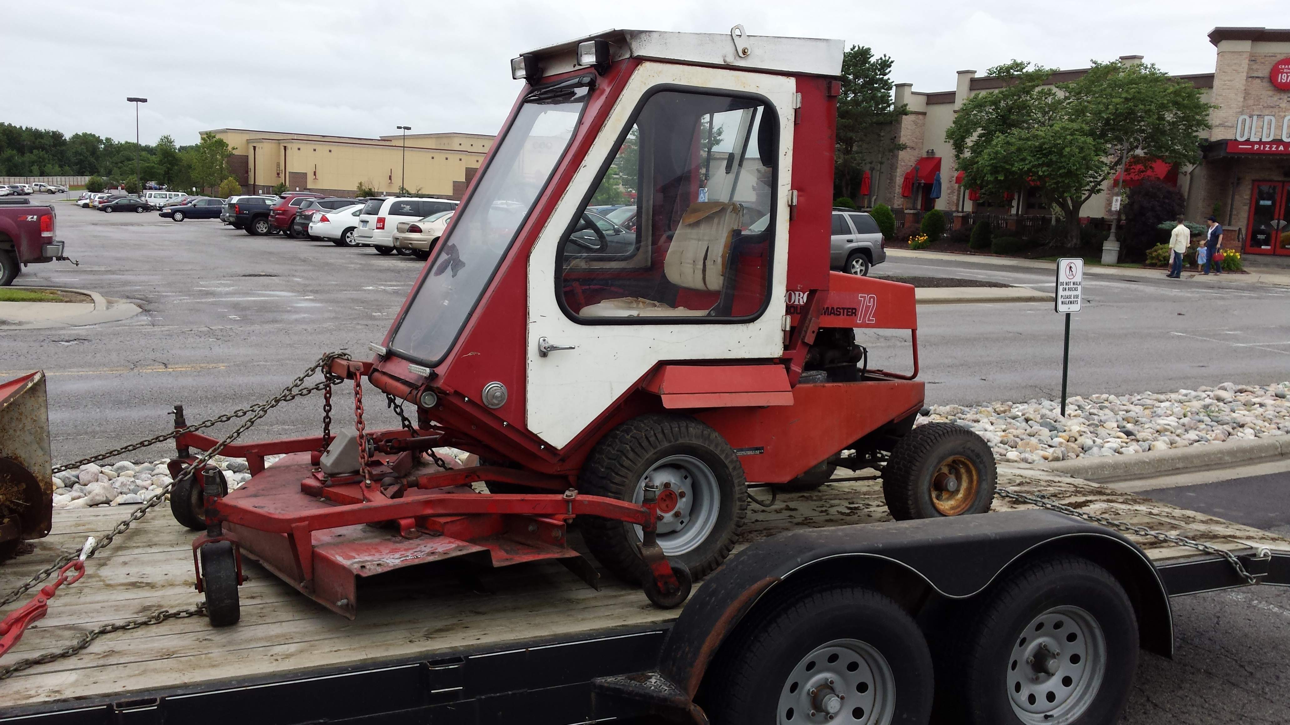

Just bought my first Groundsmaster 72. With a 48" McKee Snowlander snow blower and cab.
Here are pics of it on the way home.
Excited to see what else I can do with it, like build me a lift also.

Congratulations. I like the horn. :thumbsup:
What engine does it have?
TORO has a great Website with links to manuals and parts.
That looks like the same deck as my 300 series side discharge deck.

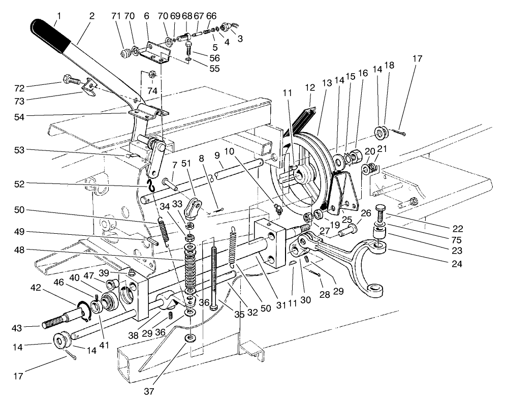

For you ground master guys , what speed does that front pto turn , I have a line for a blower off one and wanted to put on my 3 point hitch . Matt
   / any toro groundsmaster fans on here? #30
Considerably faster than 540, My recycle deck manual says 1810 RPM at 3200 engine RPM.
The engine pulley, #27 is a little smaller than the pulley #13, on the PTO shaft #43.
