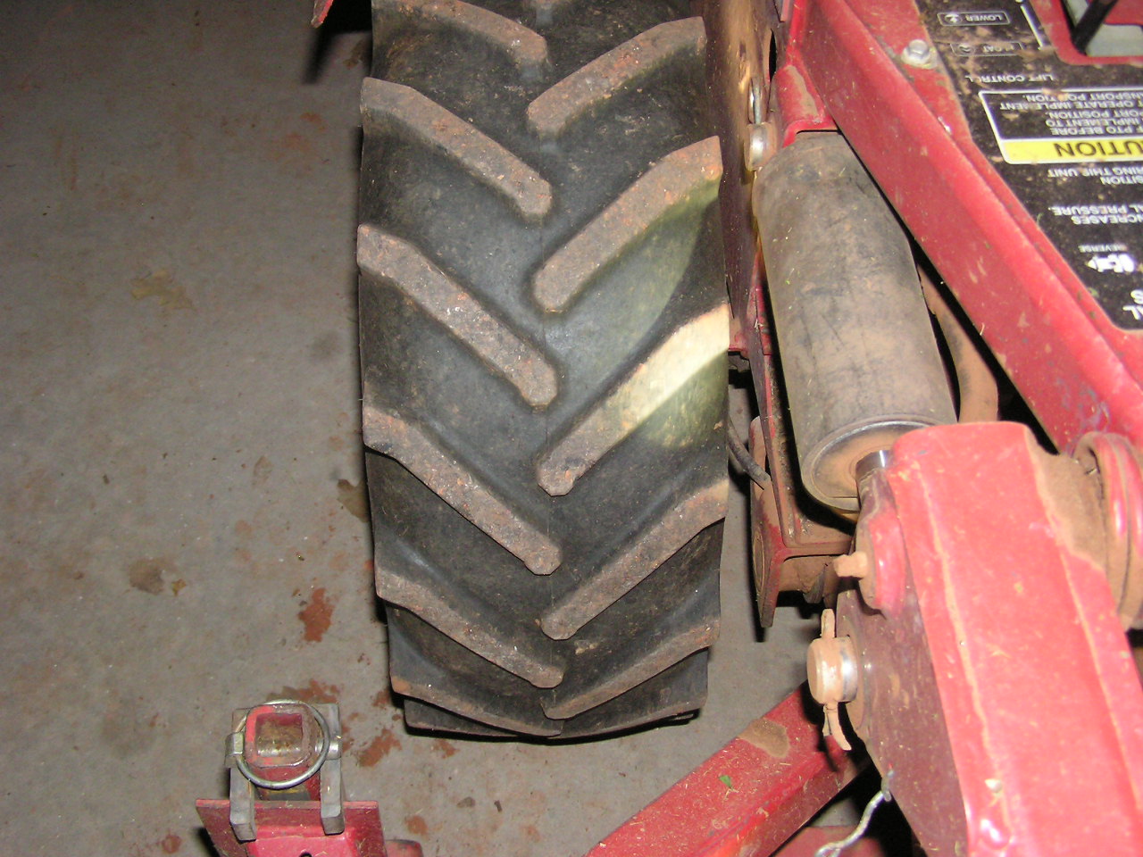

So, back to those R1 tires.. Been looking everywhere and no can find! The ones on my mower say 20x8-10, all I can find are 20x10-8... any clue if they would work? What size are yours?
Your tire size is 20 inch diameter, 8 inches wide on a 10 inch wheel. So a 20x10-8 would not work.
Mine are on a 12 inch wheel, I will try to check the diameter and width tomorrow.

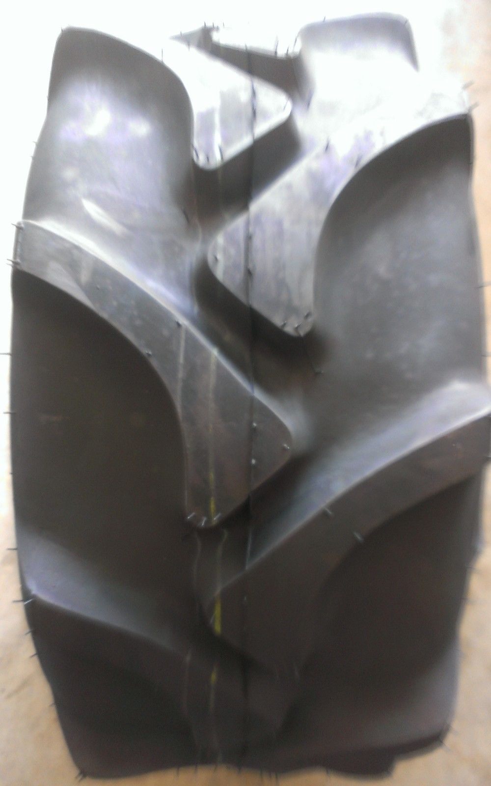

What do you think of these? they are the onlyones I can find in this size that aren't turf tires, they seem pretty coarse though.
2 2x8 1 4 Ply Kenda K378 AG Traction Tires 2x8 1 2 8 1 81 4AGR | eBay
Yep, too coarse, made for mud.

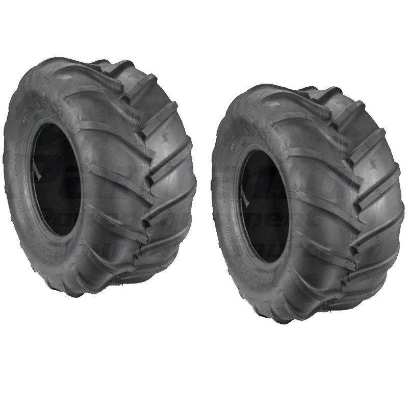

Measure the physical size of your tire and see if these might fit: New Set of 2 Kenda 22x11x1 Bar Tread Tires Grasshopper 482483 | eBay

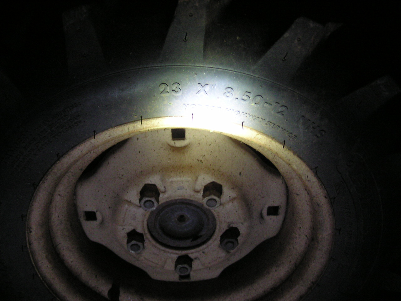

They are 23 x 8.50-12.

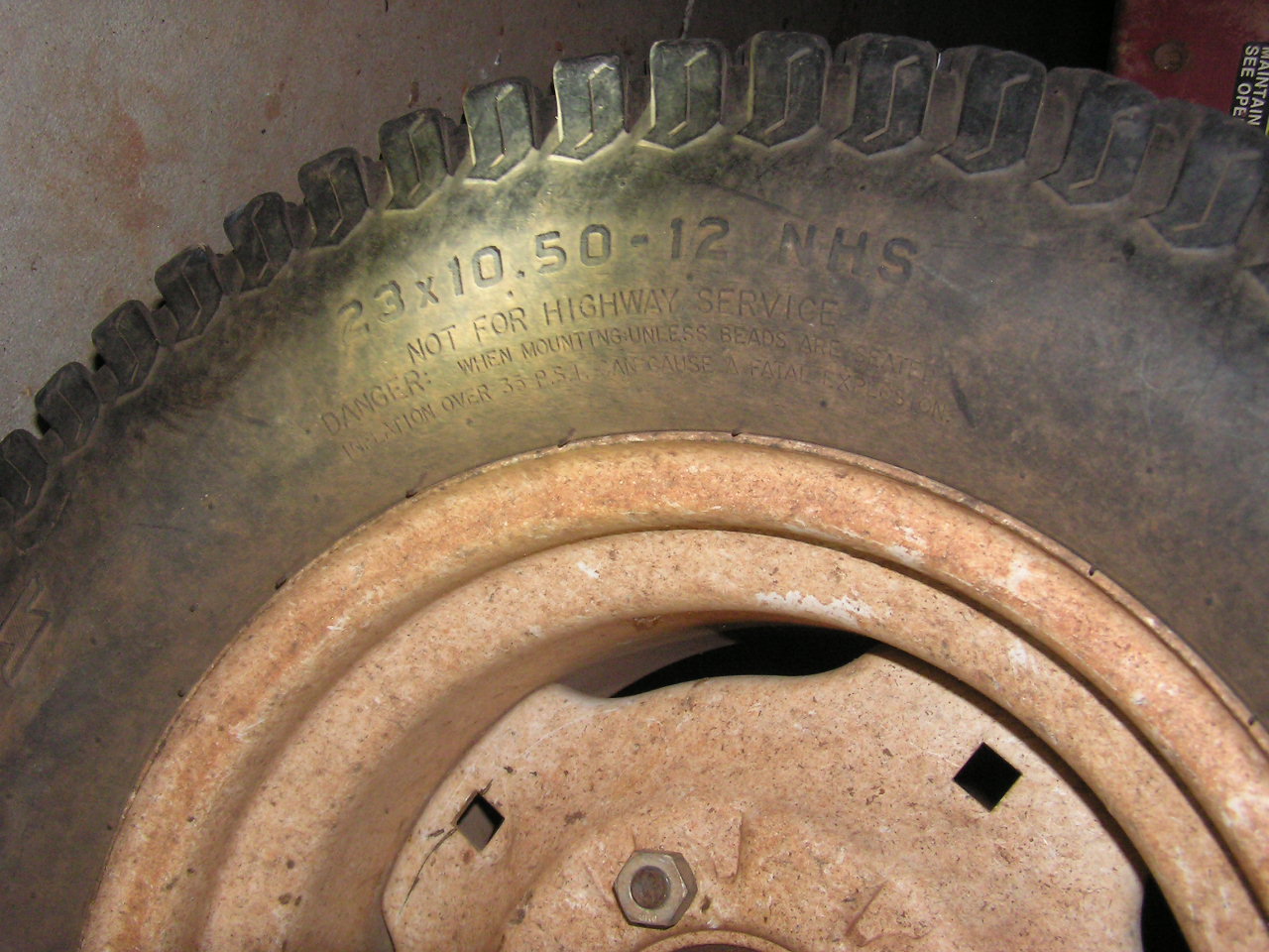

The 1996, 325D has 23 x10.50-12 turfs that are wider, on a wider wheel.
