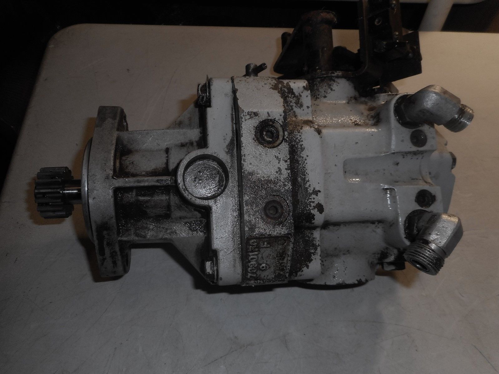

EBAY PUMP.jpgFinally got the Hydro problem on my 325D fixed. The pump was getting too weak to lift deck and hard to steer.
Instead of taking it out over the winter, bought a EBay pump for a spare, $430. It looked so good ,decided to
just try it. Just primed it with clean oil, and swapped. It works great ,now lifts deck even at lowest throttle, and
steers soo much easier. Happy Mowing

View attachment 552405Finally got the Hydro problem on my 325D fixed. The pump was getting too weak to lift deck and hard to steer.
Nice catch Carl. A working transmission with a good charge pump will usually fetch around the $700 mark. A refurb will run around $1,600. If you're lucky enough to find a new unit (I was told by Sauer-Sundstrand they don't make them anymore) they're about $2,000+.
