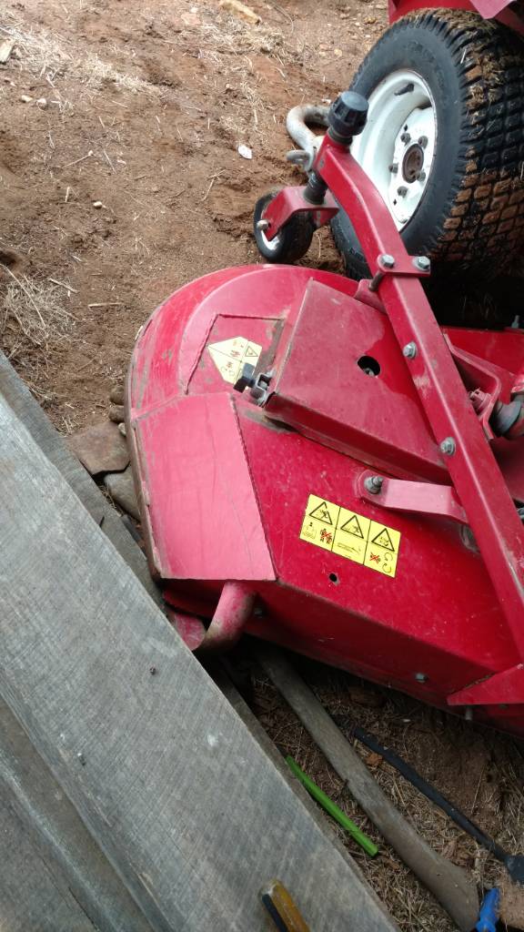

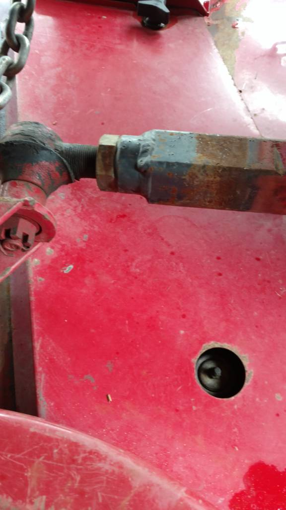

I notice the front of the deck all bent up and the left deck arm has been welded. Could be an incompetent operator or it could be a drive/brake issue. i would check it thoroughly. A ding or two on the front fo the deck is not abnormal but that is excessive and why did that deck arm did not break with a bump.

The deck arm might make me nervous. I might be inclined to replace it with a used part. I haven't had a deck yet - on anything - that I didn't have to repair. I try to use stainless for patching and rebuilding. It's not that much more expensive and holds up a lot better in the long run. We tend to keep stuff forever and a day.

I guess I have had my Deines for 20 years now and the front edge of the deck has a couple of dings on it - not that it has not bumped things but certainly nothing close to the dents shown in these photos. Mine has been driven by many people including my kids. I did have one front corner of the deck tat my wife caught on something that I have weld repaired but that was a very attributable cause. 1300 hours on it mowing around a lot of obstacles. my point being deck repair should not be normal.

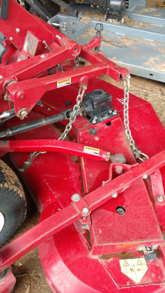

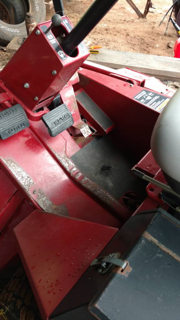

I took some more pics. That arm to me was repaired by the best welder I've seen or it is factory. Doesn't look like a repair. The deck was repaired in the front. The unit was from a city. The hour meter was replaced and shows 150 hours. The owner thought I was asking about another unit he had for sale. That is where the 455 hour came from. I checked the oil and filters. They had been serviced. The oil looked new. It runs out great.

Still would rather have this than a residential zero turn. I will used it to trim areas I can't get close to with the 75 and 6 foot RFM. IMG_20180528_132933029.jpegIMG_20180528_132639201.jpegIMG_20180528_132752053.jpegIMG_20180528_132819345.jpegIMG_20180528_132811661.jpegIMG_20180528_132712171.jpeg

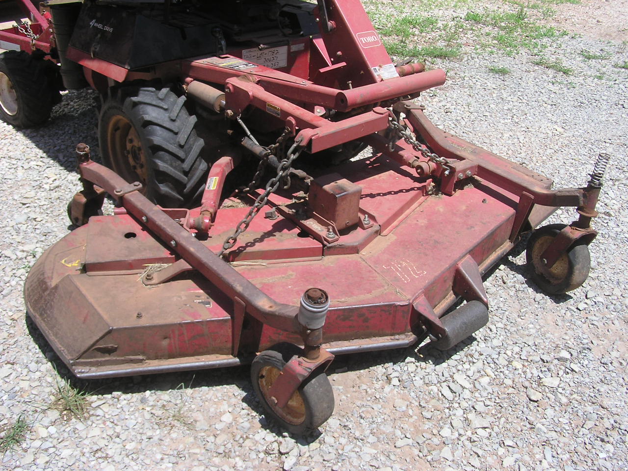

:thumbsup: That is going to be your favorite mowing machine. :D
The brake cables tend to rust and not move, if not lubed.

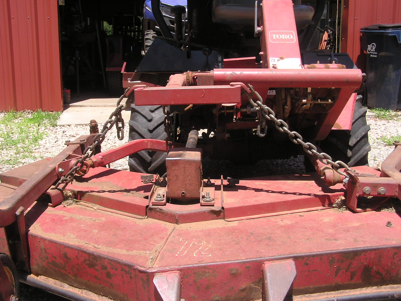

You can shorten the deck lift chains to raise the deck higher. Mine are using 11 links on the left and right:
Adjust the back chain short as possible without causing contact with the driveshaft when raised:
Your model number is 30788, the first part of the serial number indicates what year it was made, starting in 1988: Toro Master PartsViewer
