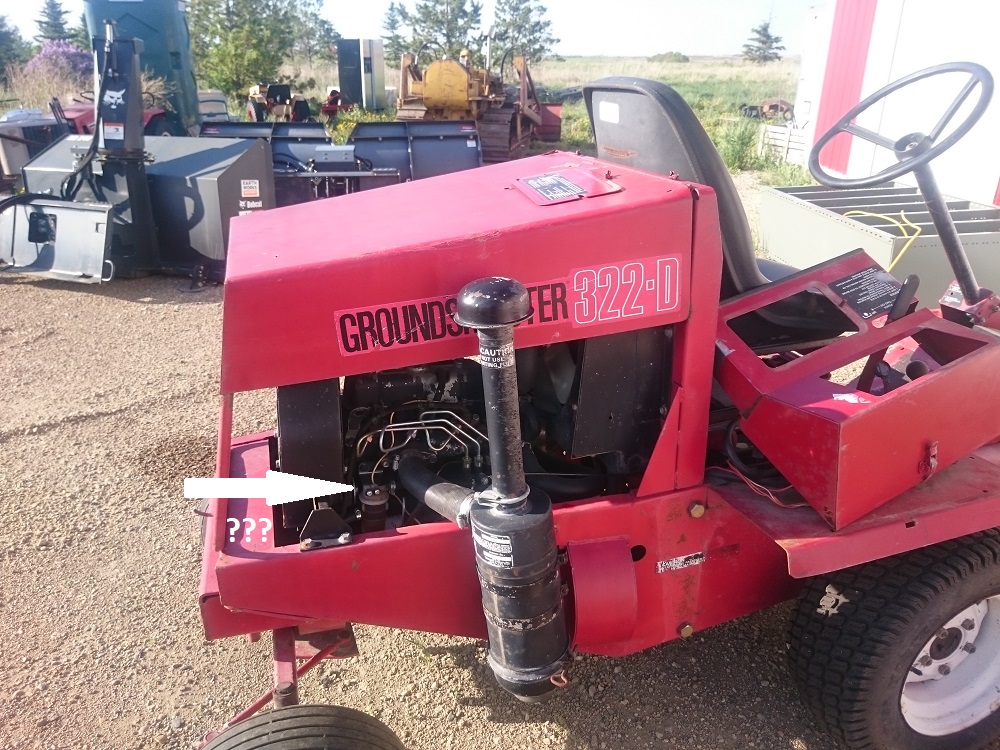

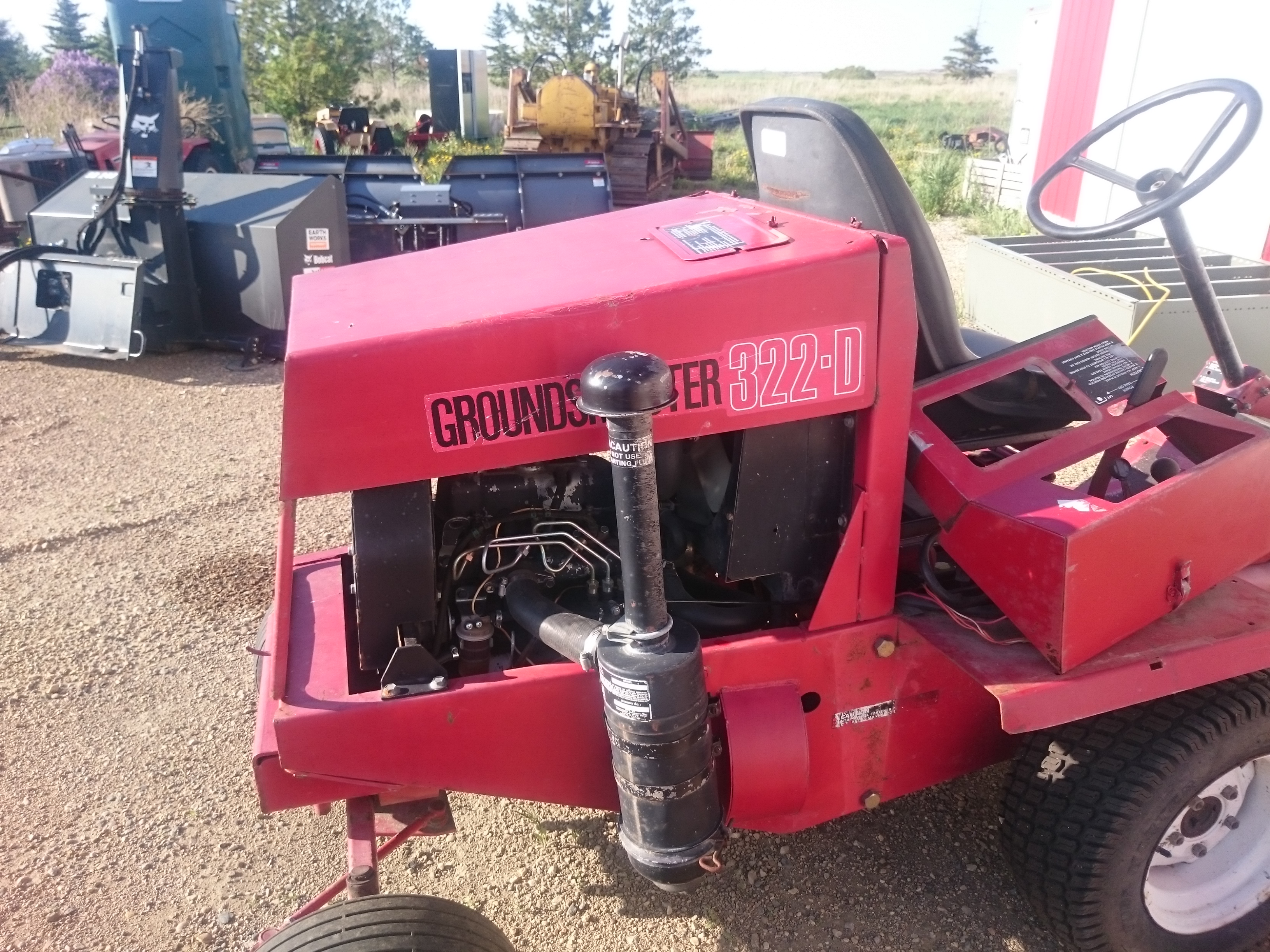

picked up a 322-D model for a project, it had pieces missing, from the previous owner it ran good, he decided to change oil and fluids, then it would only start but no power for movement or blades, after several attempts the starter died and he gave up with it.
thus far put all parts back on, fixed the electrical to the solenoid and replaced the starter brushes, re connected the hydraulic lines he removed and as best the wires in the panel, thinking he tried to short wires to bypass the key switch
as of now it cranks, looks like fuel is getting there as white smoke sometimes comes from exhaust but not firing, fuel pump is pumping and getting to the block.
have not tried removing the fuel line to injectors to confirm fuel is getting to injectors but I see no fuel cutoff on the block, the throttle moves as it should but do not see a solenoid, there is a lever of sort with spring return but nothing attached, is there a cable for fuel shut off I am missing?

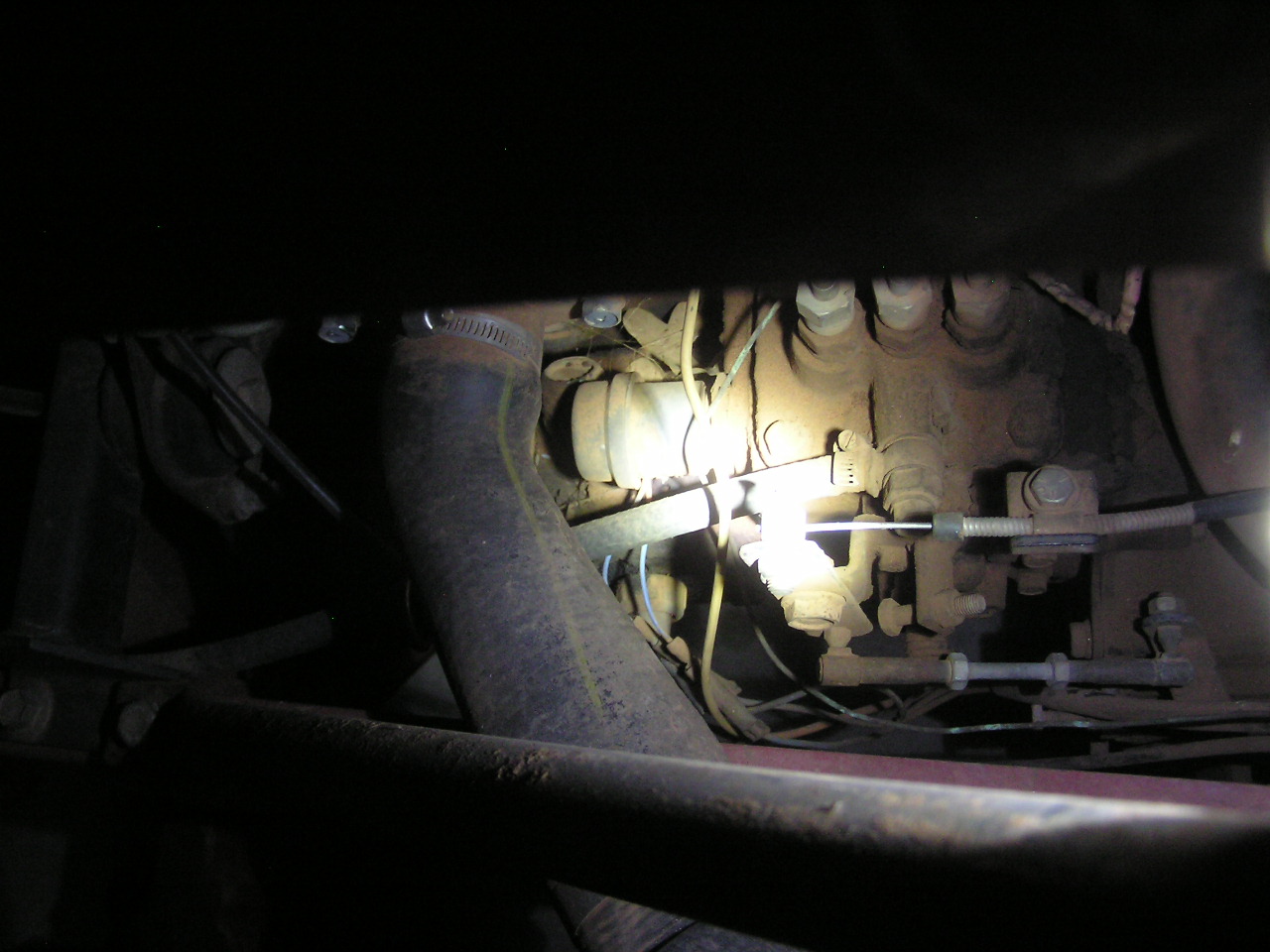

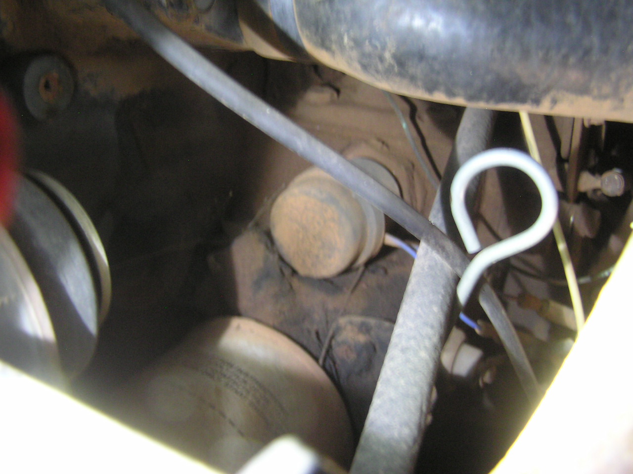

Here is the fuel shutoff on my 322D. Power is applied on the blue wires. You can also push in and hold on the rubber cap to stop fuel flow.
Is this a fuel pump that has been added?
The stock electric pump is on the left frame rail next to the fuel filter.

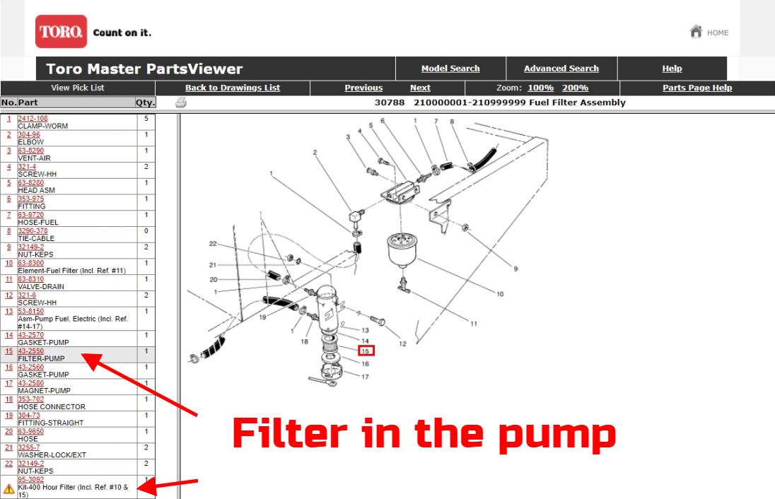

On aT LEAST ONE OF MINE, THERE IS A LITTLE FILTER built into the pump housing. I think it was on the bottom
   / any toro groundsmaster fans on here? #374
Yep the parts list shows it:
View attachment 556483 View attachment 556484
you asked if its a fuel pump, its actually a filter, clear cylinder type
