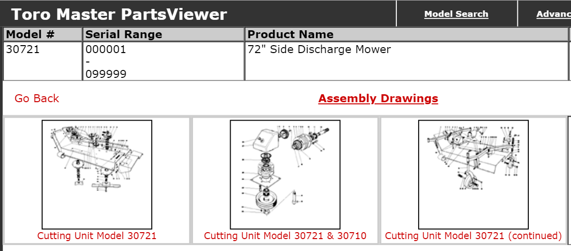

The 30721 is the first SD deck. 30722 is the newer version for the 300 series. Looks like it's from the 3rd year of production: Parts List...

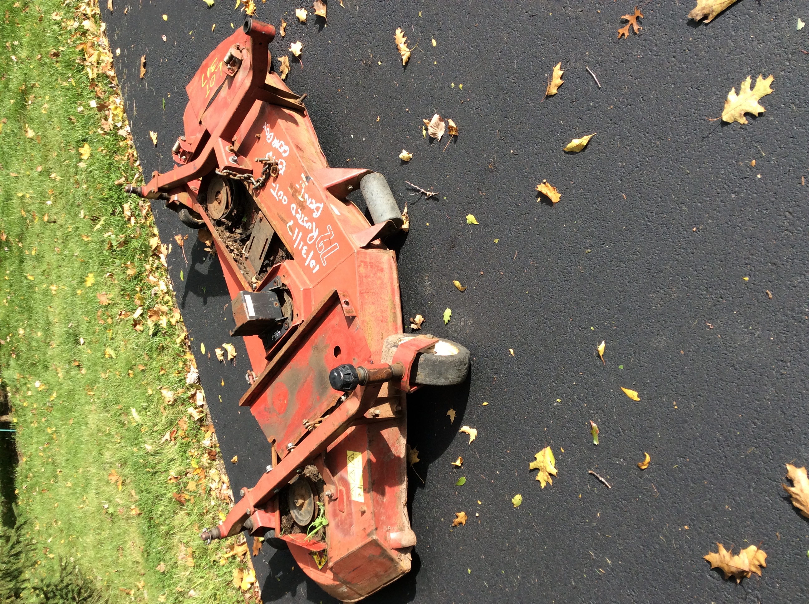

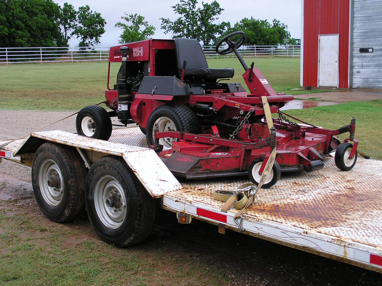

Got mine on eBay in May, 2005. It came from a city parks department. They had welded a solid steel bar across the front to strengthen it:

Do you happen to know the difference between the old style and new style decks? The two parts decks I’m getting are the newer style.
   / any toro groundsmaster fans on here? #504
Nope, no experience with the old style. It may be the same shell. You can compare part numbers on the Parts Viewer.
One visible difference is the front center roller. There is also a rear center roller under the deck.

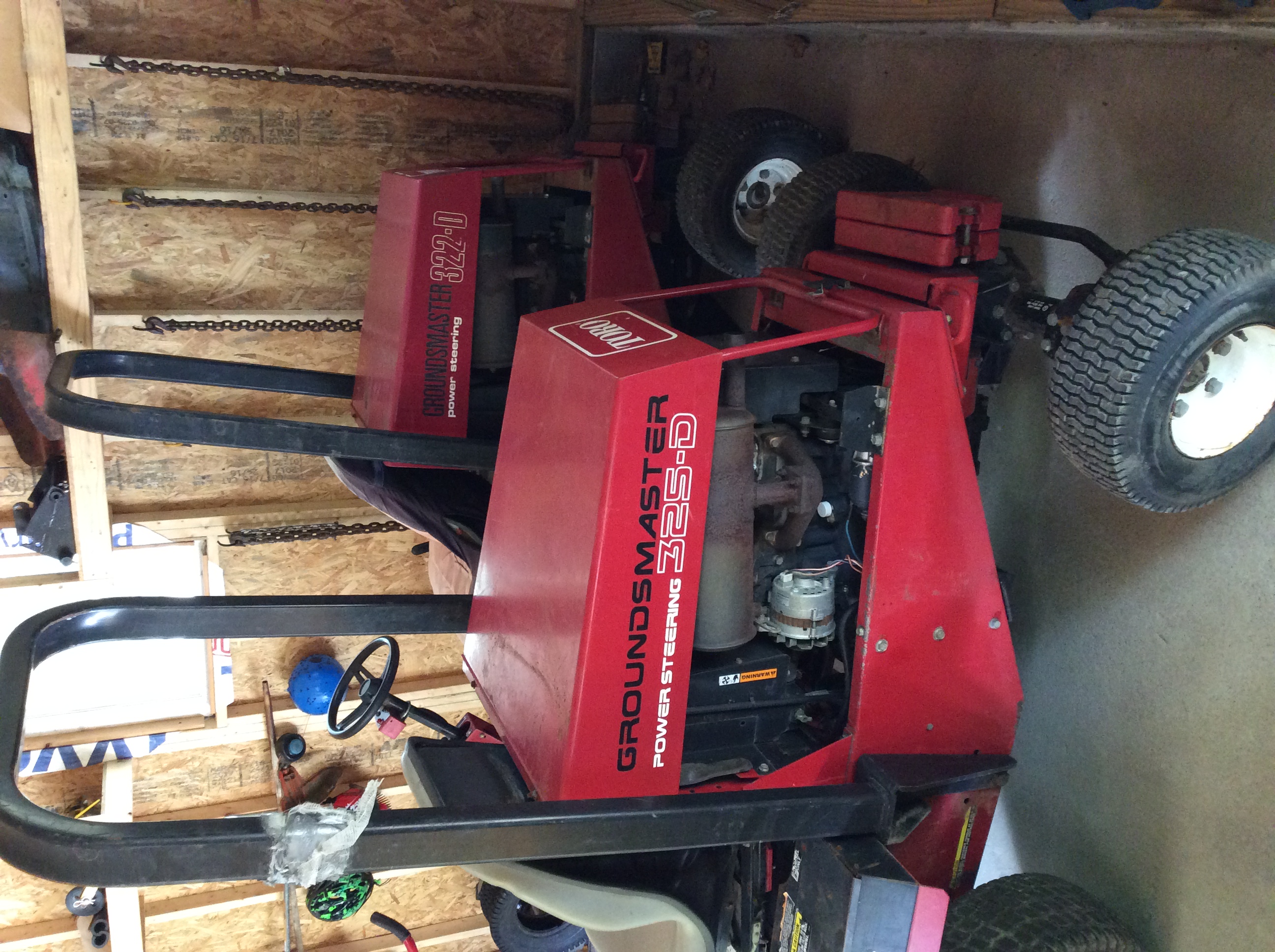

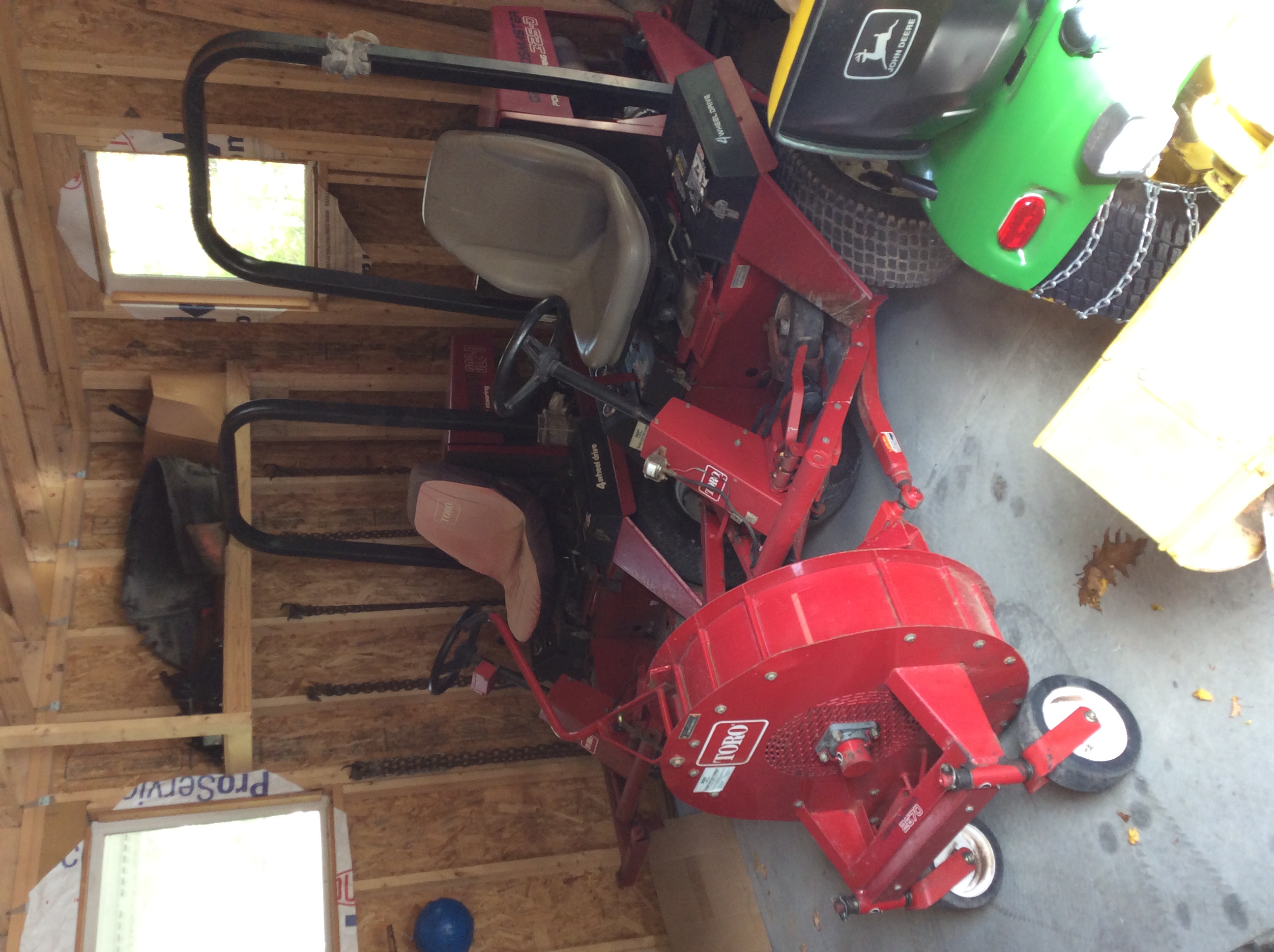

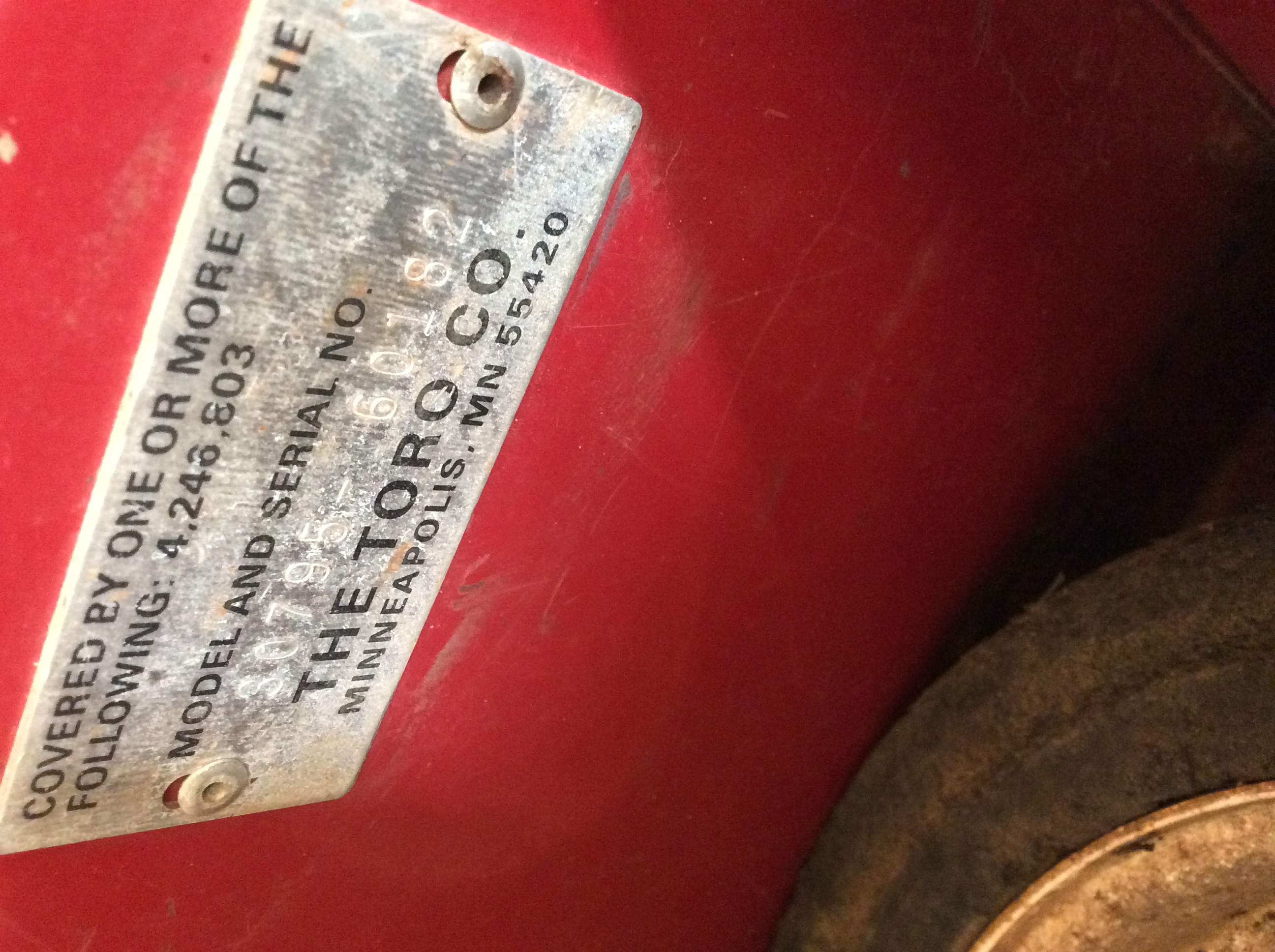

The new additions have arrived!
The 322/325 tucked into their parking spots.

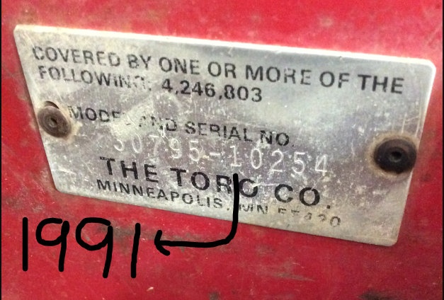

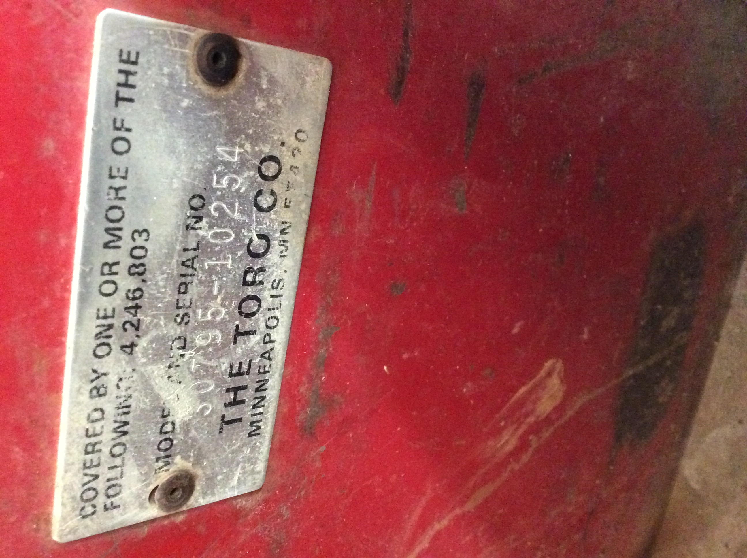

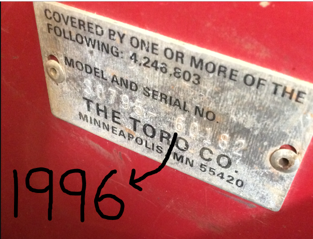

ID tags for both machines. Can anyone tell me what year they are?

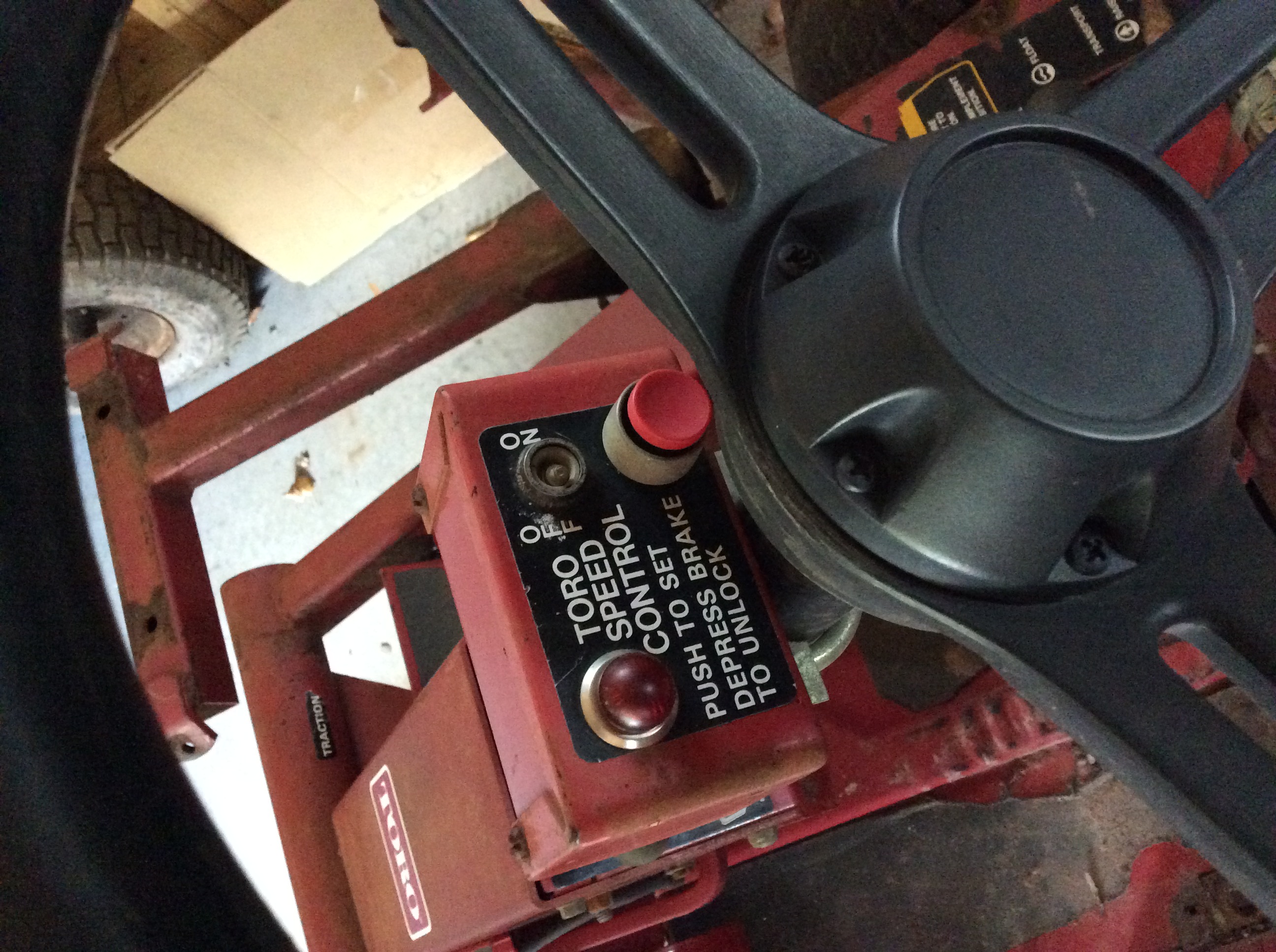

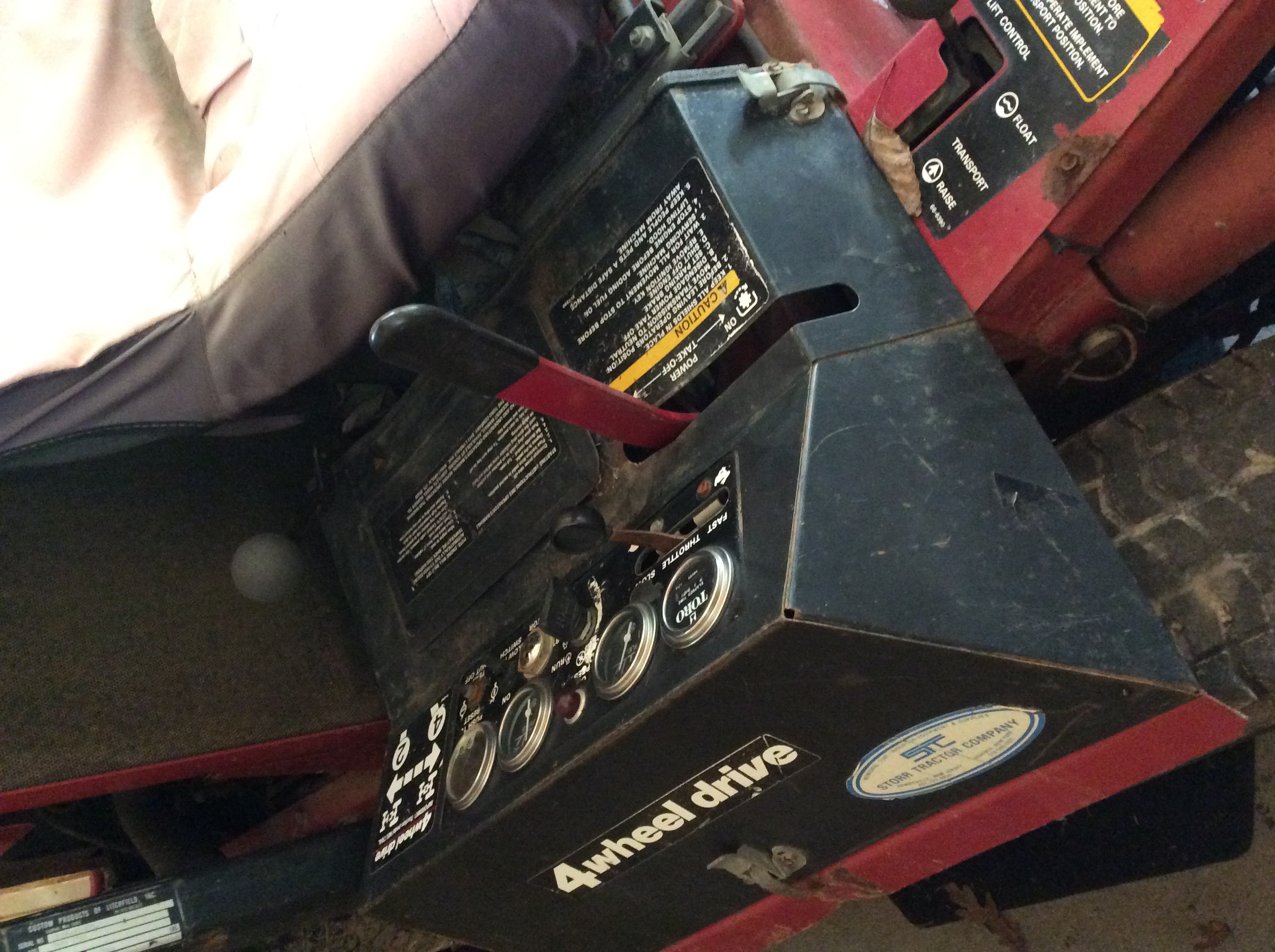

The 322 has some uncommon upgrades. The manual 4wd engagement for full time 4wd, and also some kind of cruise control on the pedestal.
Super excited and can稚 wait to roll them into the shop for some much needed adjustments and maintenance.

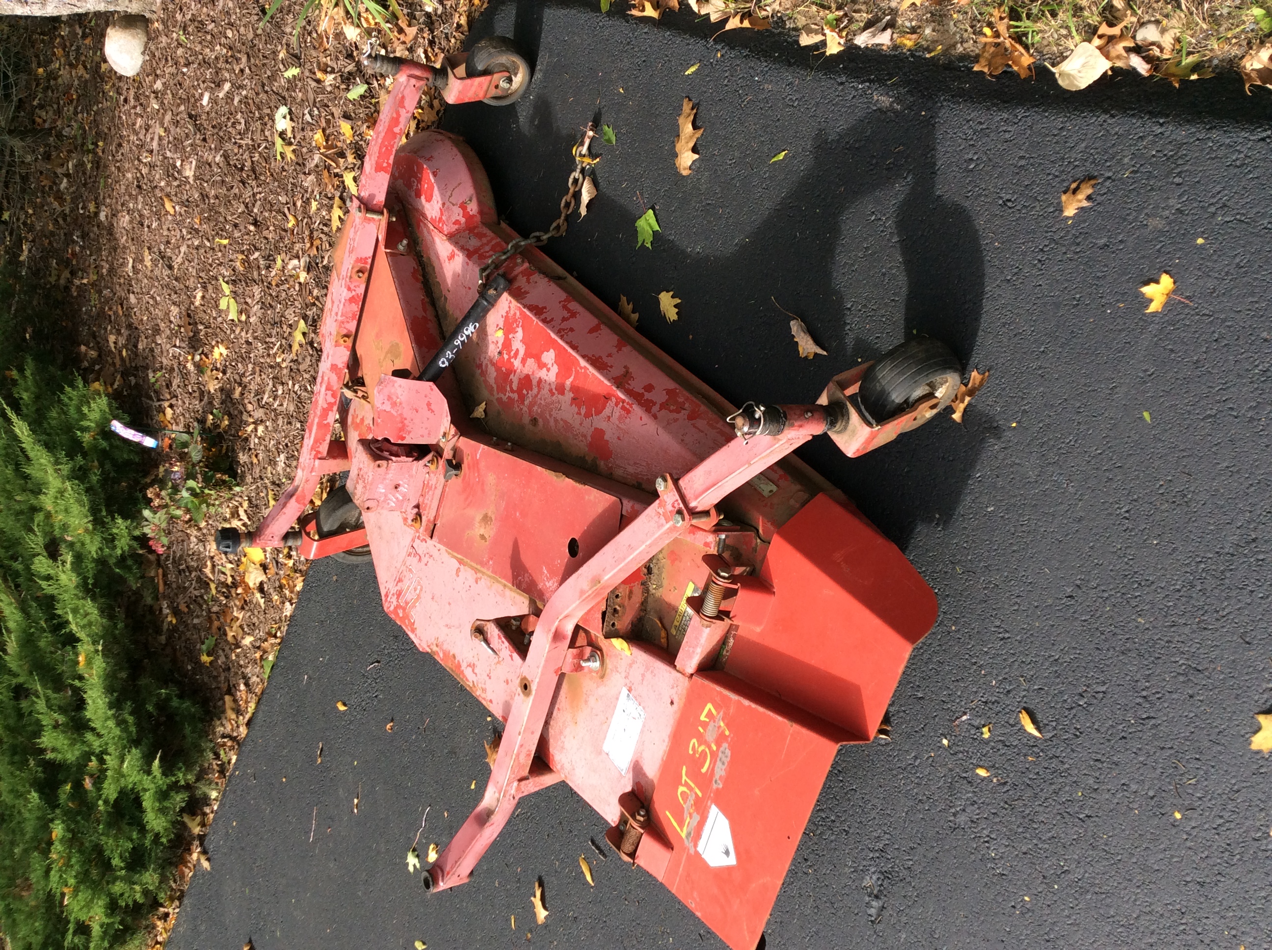

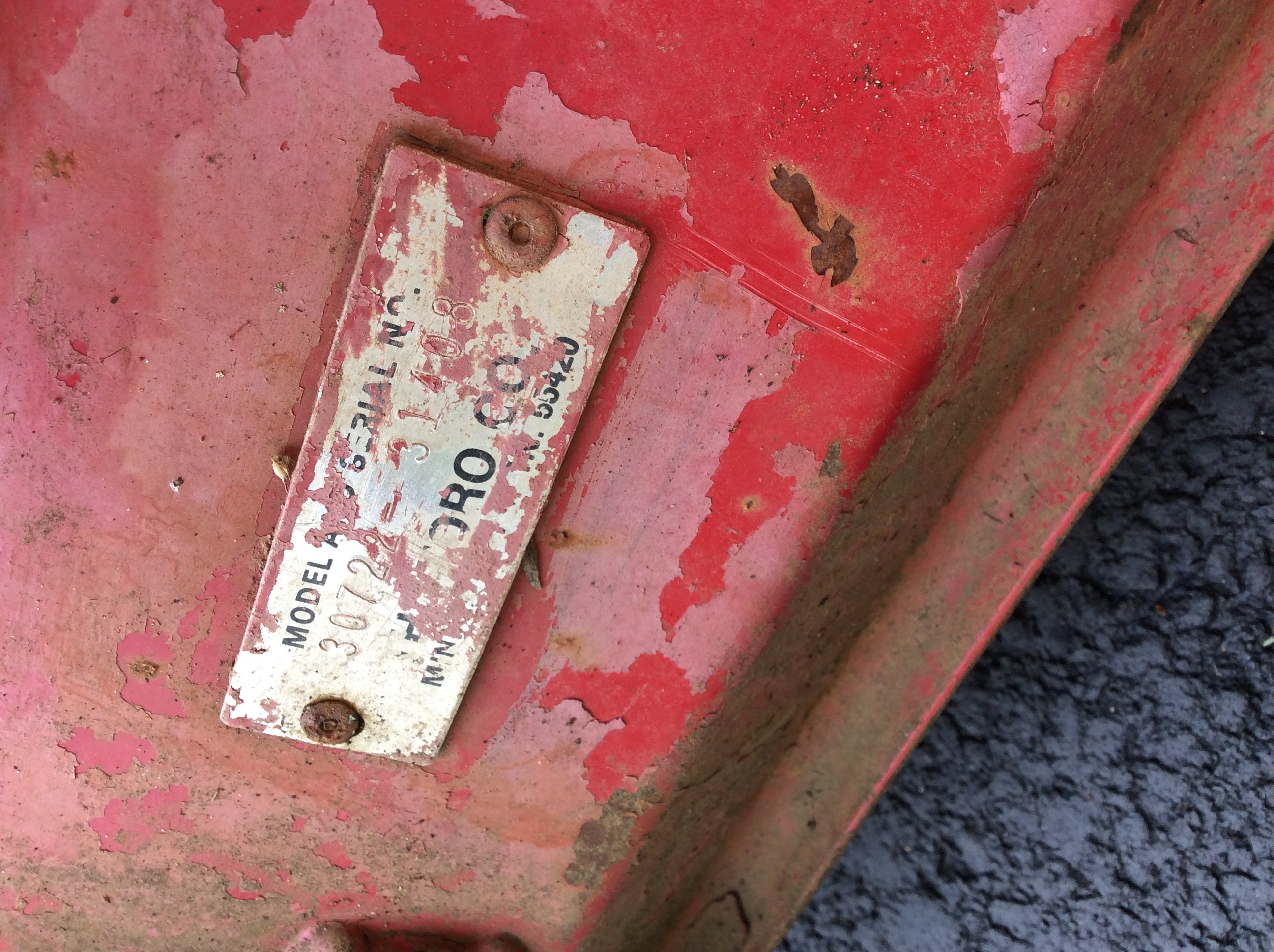

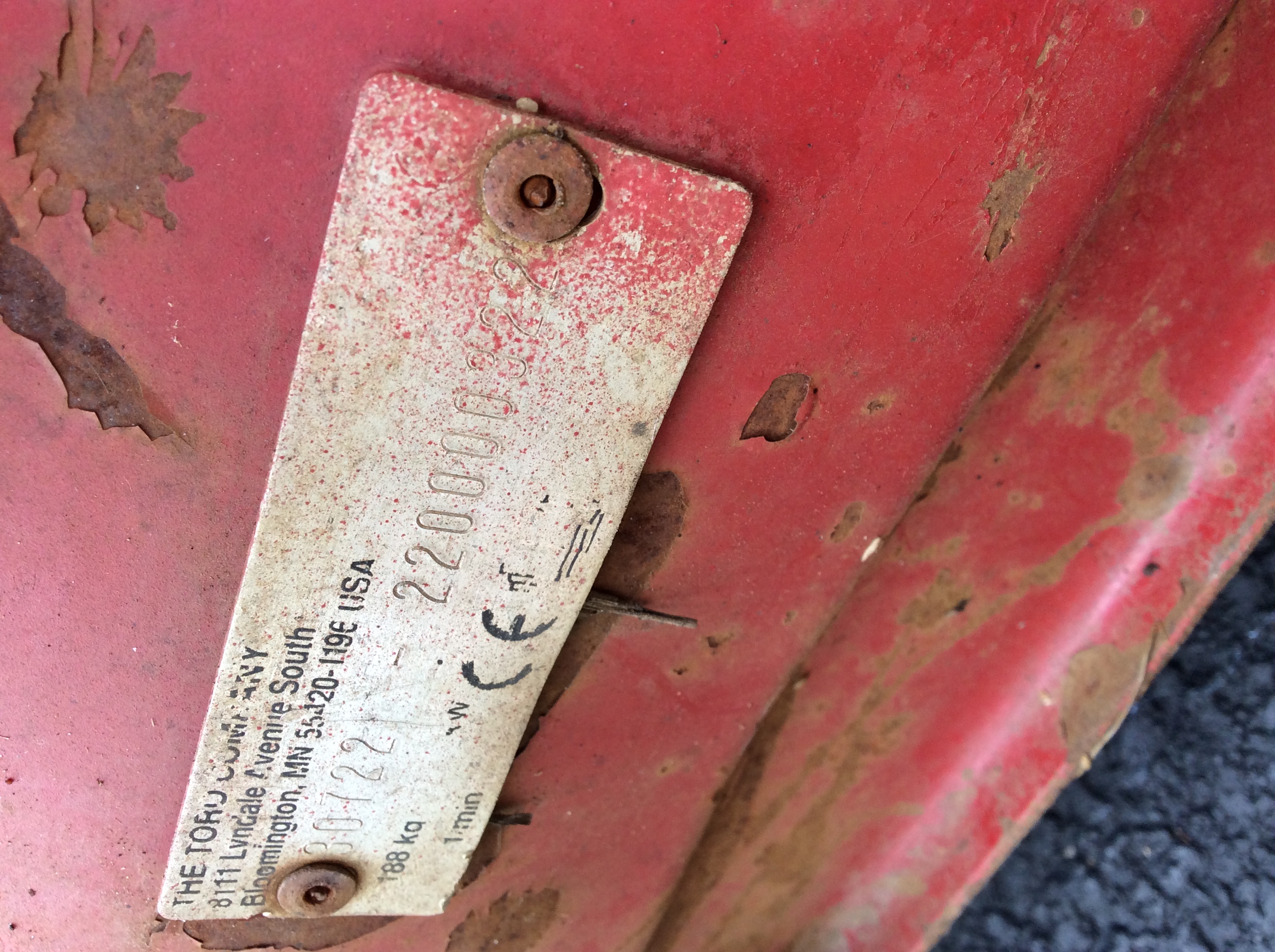

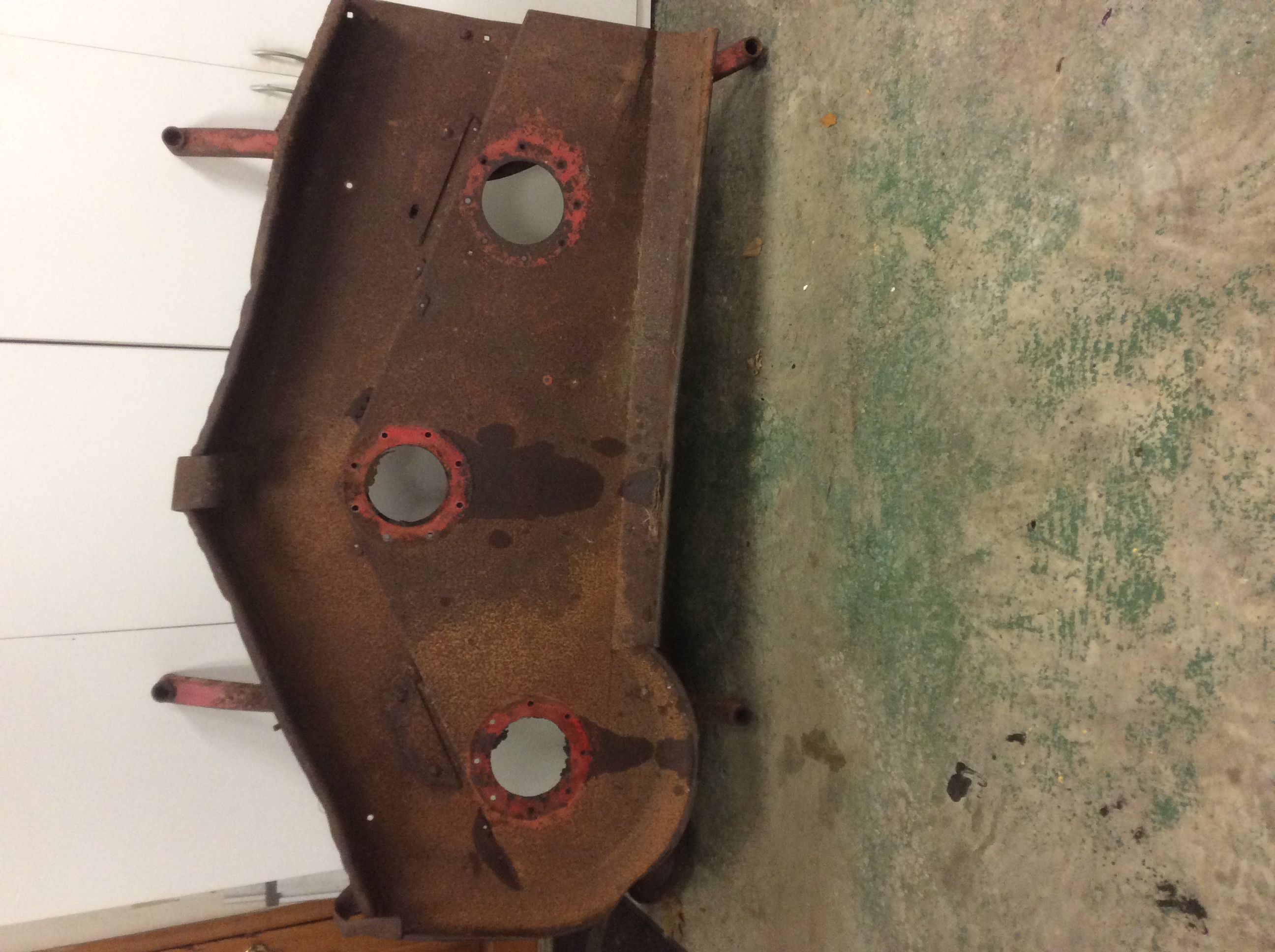

Also received the two parts mower decks. They are both 30722 models.
They are both rotted through in several areas, which is a shame, because one of them is fairly straight with good spindles and hardware. Plan is to salvage the mechanical bits and transfer them to my older 30721 deck shell I am currently rehabbing.
The ID tags for both parts decks. The scrap man is going to love me.
From what I can see, there are several differences between the older and newer decks. Newer decks have a different gearbox, roller underneath, roller on front lip, baffling underneath, and different style gauge wheels. There may be more, but that’s what I’ve found so far. I’m hopeful everything will swap over, will keep everyone posted.

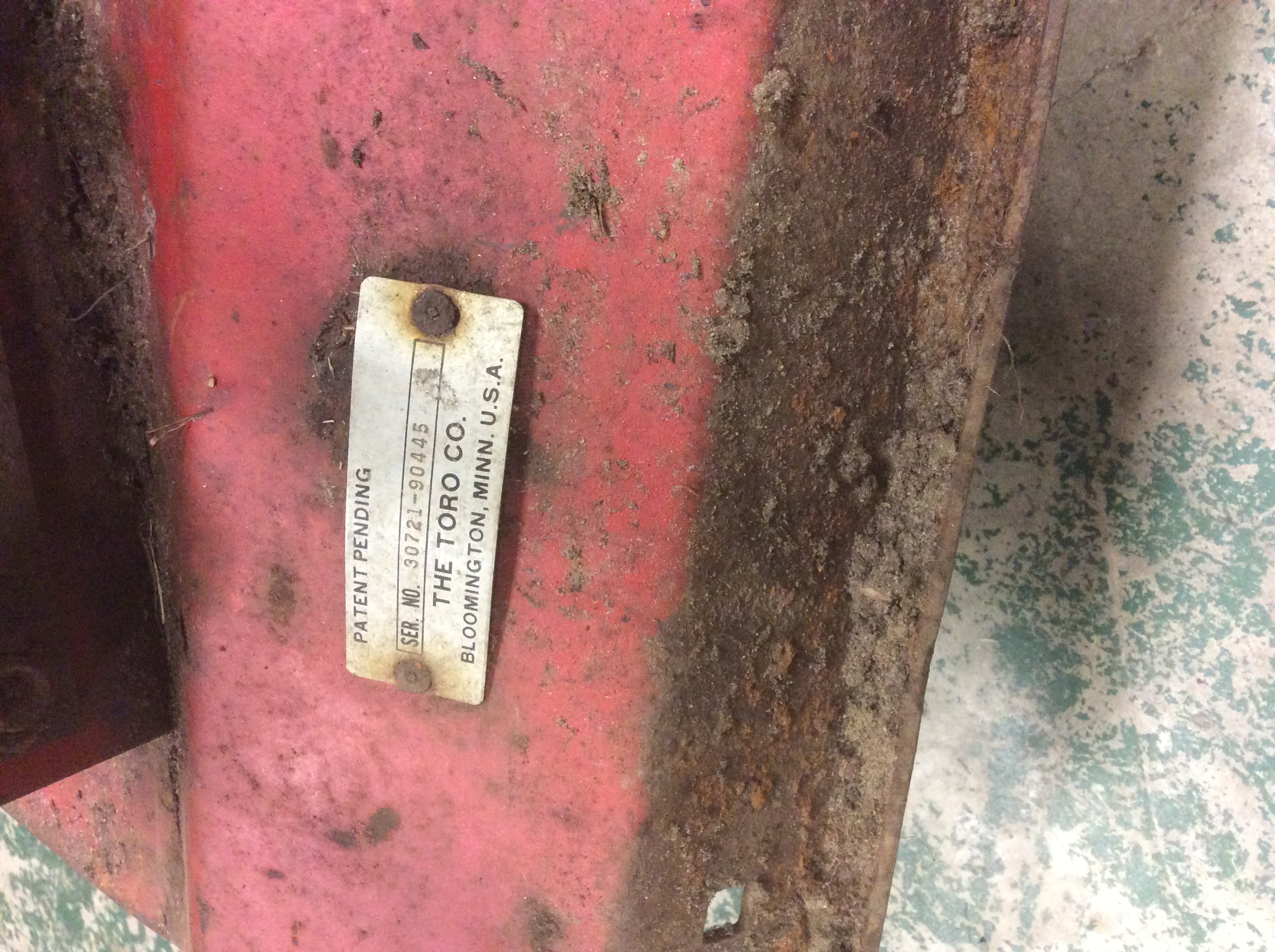

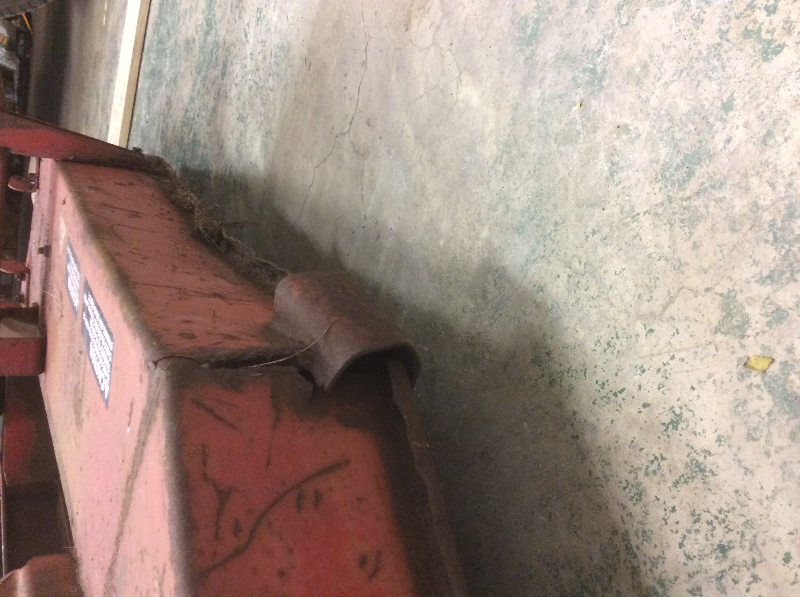

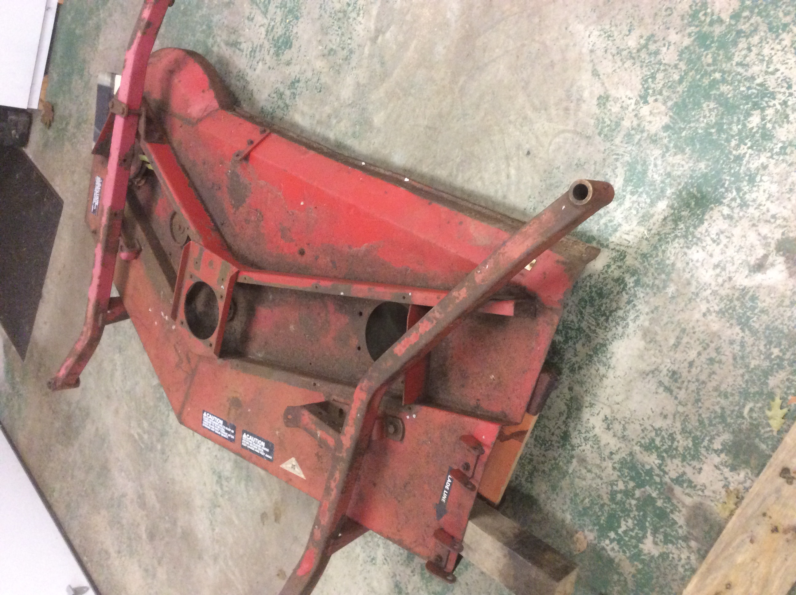

I picked up my new/used deck today from Craigslist. It is in pretty good shape, some cracks, dents, bends...the usual abused equipment issues. The good news is there is little to no rot, lots of rust, but no cancer issues.
The deck as received.
Standard 72” SD. 30721 model number.
Going to have to spend some quality time with the mig to fix the cracks and reattach various skid pads and such.
Spindles pulled. Not looking forward to doing this on the rotted decks I’m going to be using for parts. These were hard enough to get off and there wasn’t much rust.

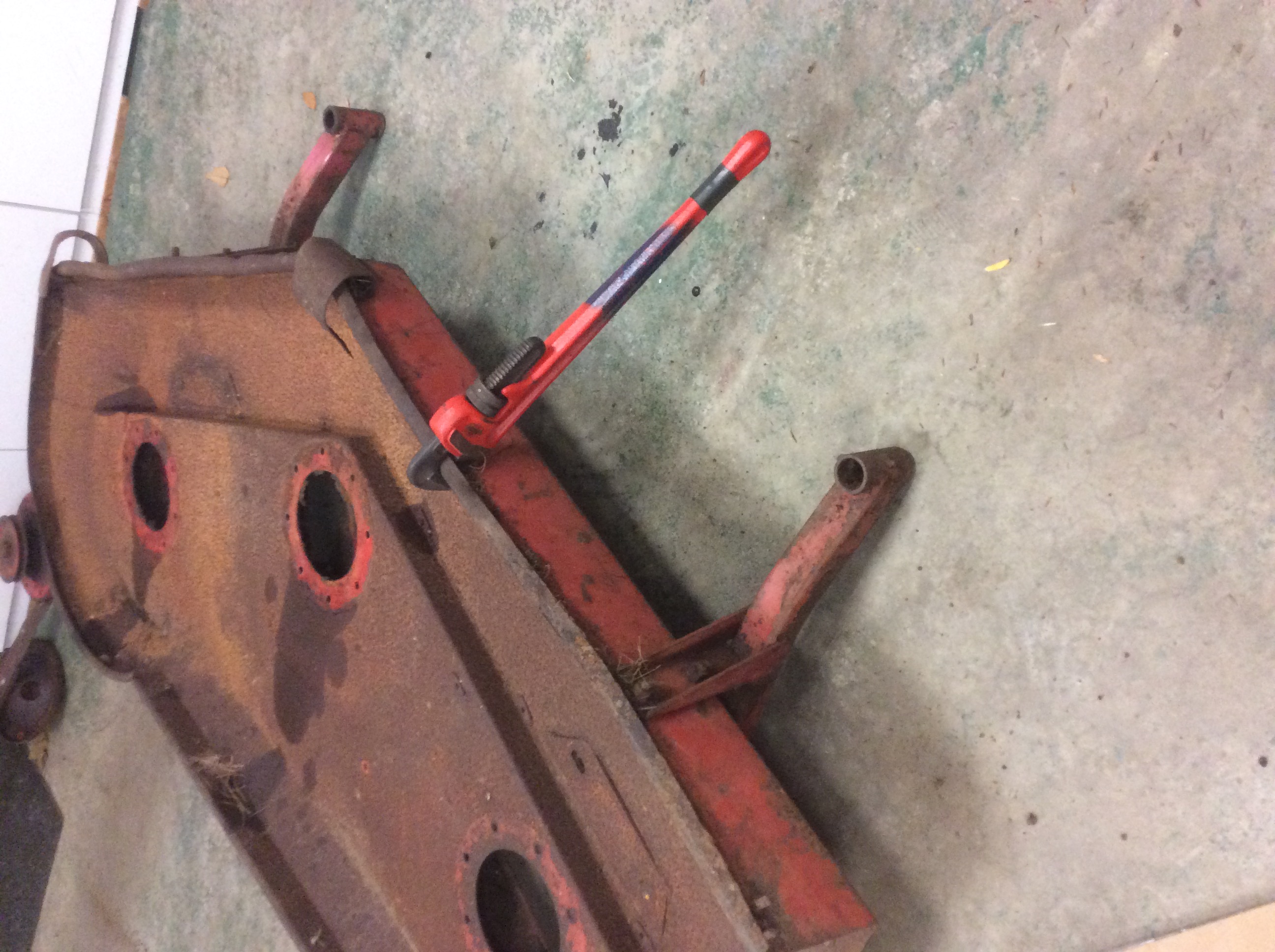

Straightening the front and back lips with a couple plates of steel and a pipe wrench. The back lip is bent bad and going to take some engineering to straighten out. Will weld some thick plate steel to the outside that sticks out past the deck so I can get a leverage arm on it to bend the lip back in.
