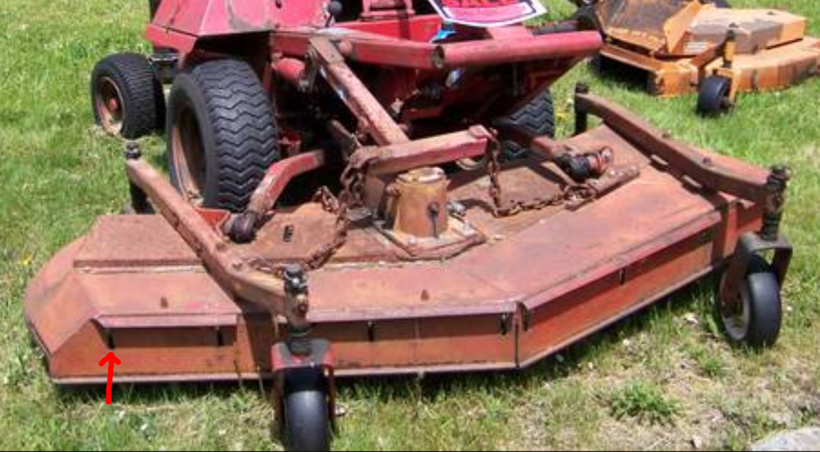

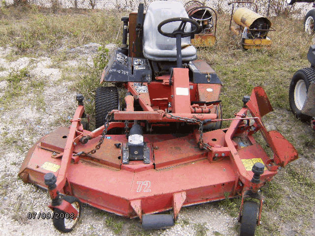

That is mounted on a Groundsmaster 72, the predecessor of the 300 series, so don't think it is 60" deck.
Those are slots on the front, to allow raising for tall stuff:
What you have is an early production 72 deck used from 1973-1975 or so on the GM 72.
Those were the only produced with a mostly round gearbox, an adjustable baffle, a unique castle nut blade attachment and 1 pc molded rear caster wheels on straight sided caster forks and the center blade is driven directly by the gearbox as originally produced.
You can update this deck to the later caster wheel style but finding gearbox parts and blades through Toro was near impossible 4 yrs ago when we scrapped ours due to those problems.

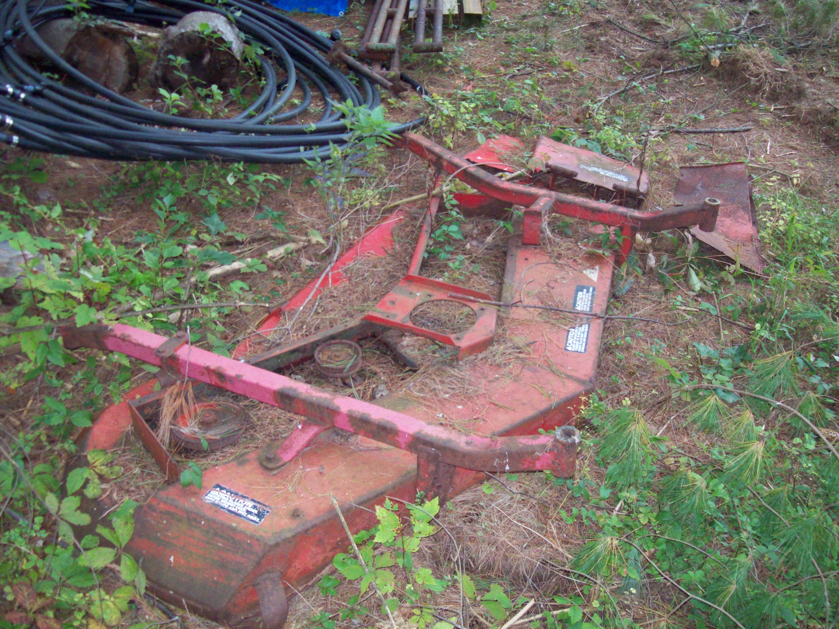

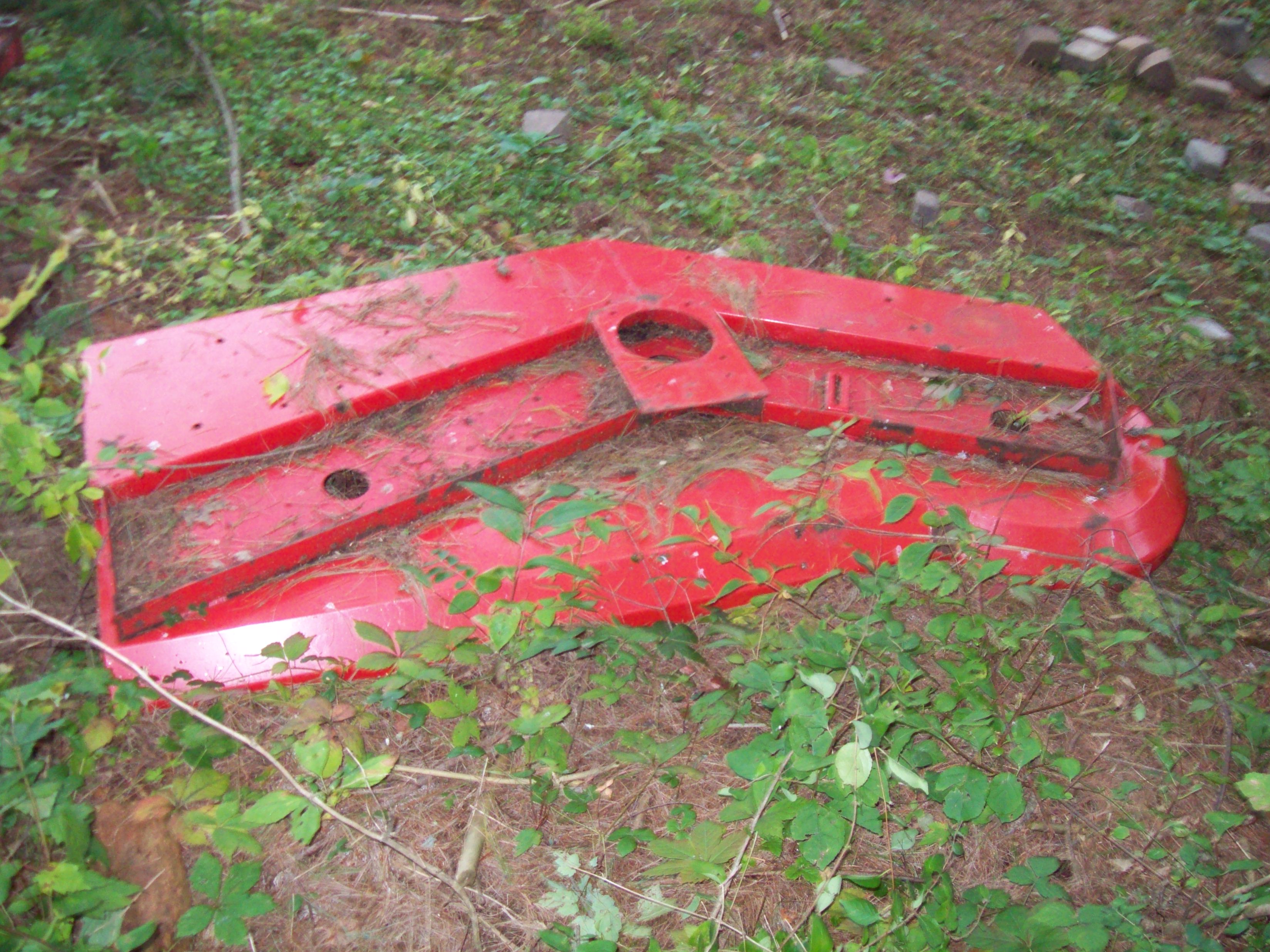

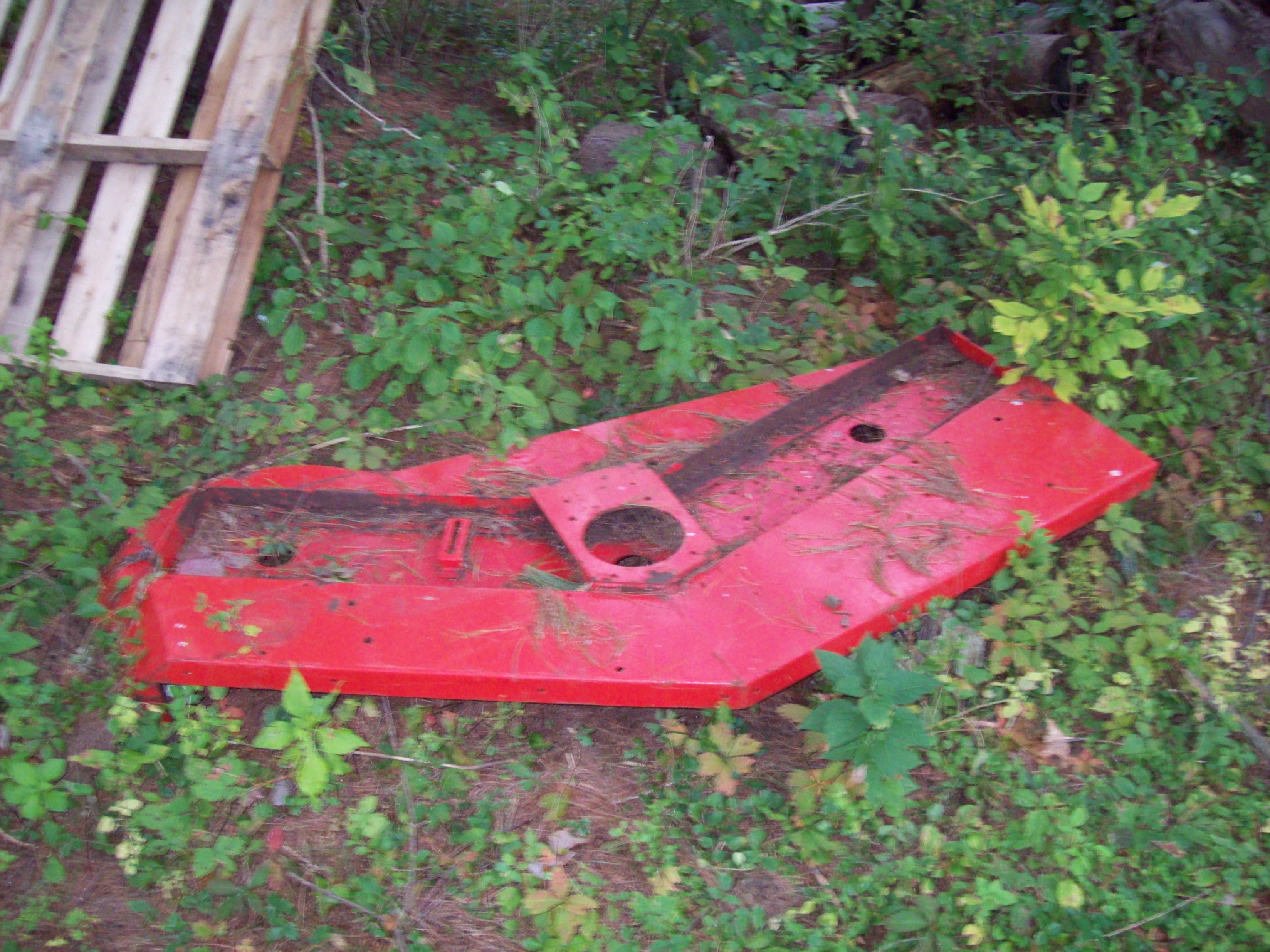

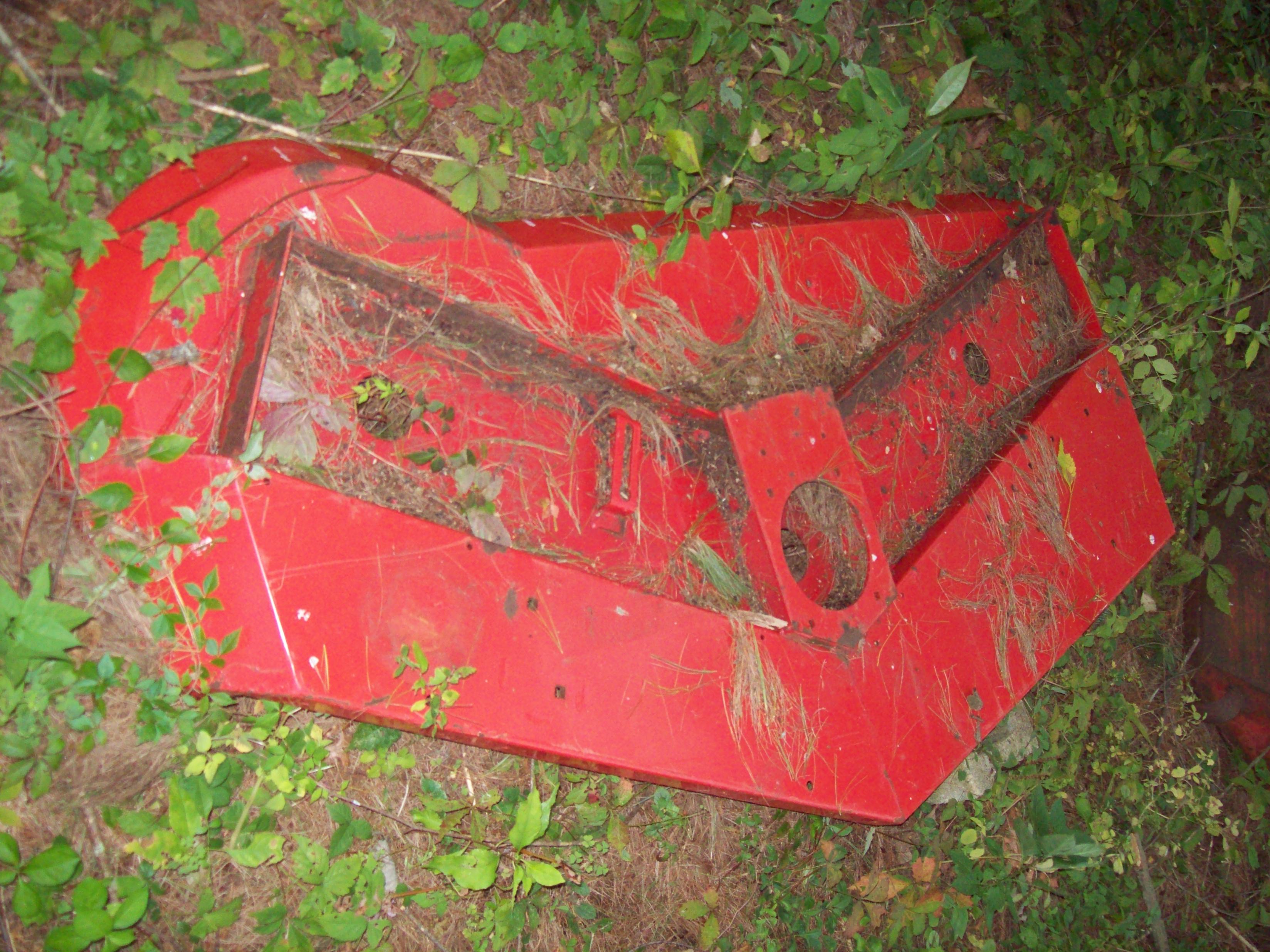

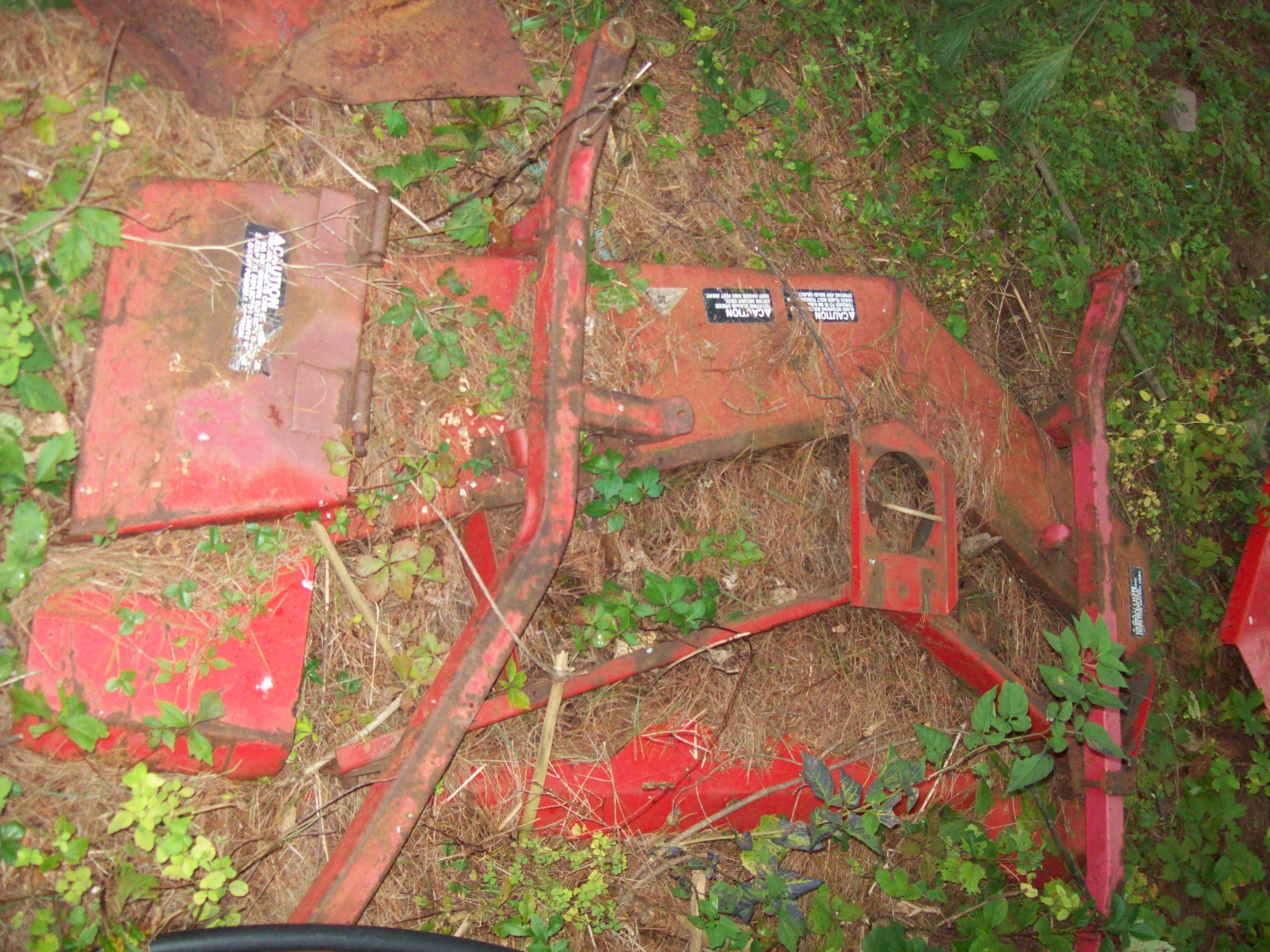

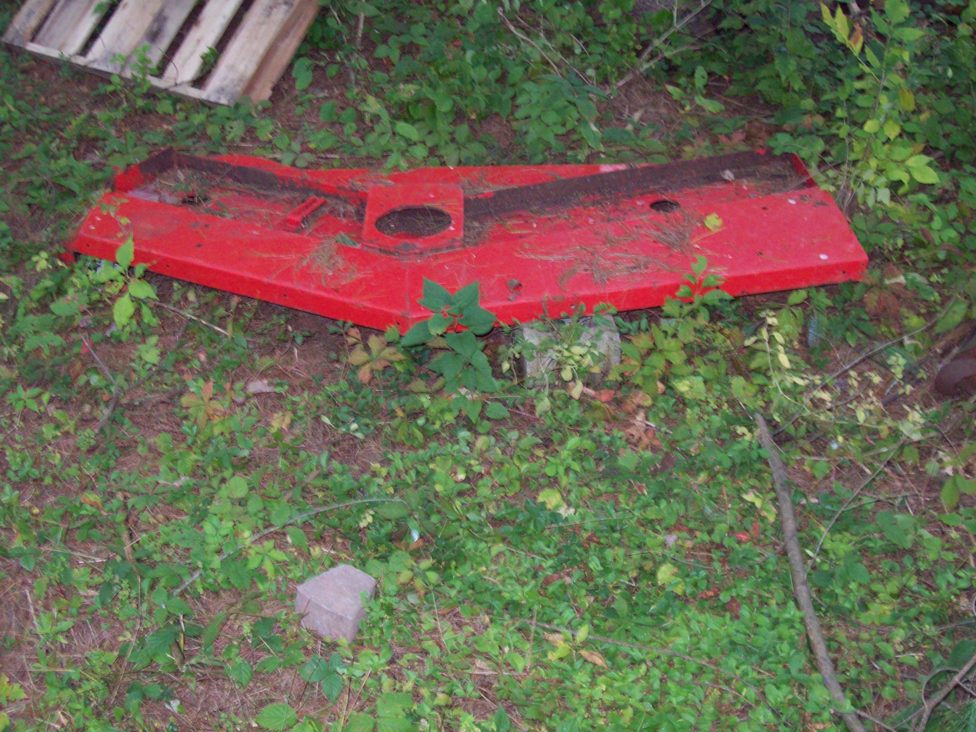

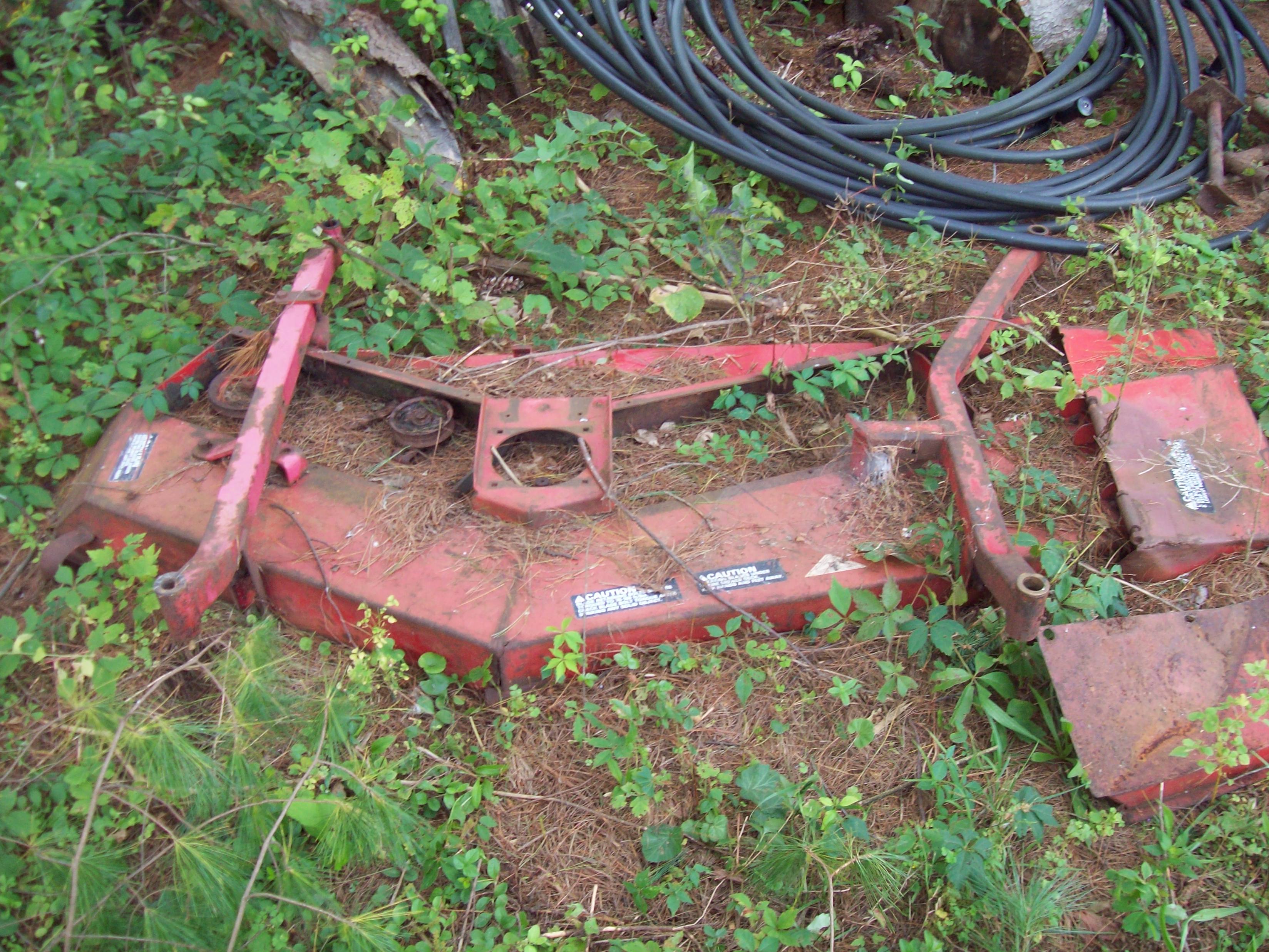

Perspective 325d owner here. I遏・ looking at one with a leaf blower attached, deluxe seat, and rear weights. The issue is the 72 sd deck is rotted to death. Spindles and assorted hardware looks to be in good shape. There are actually two decks that come with the sale, but both are blown out.
However, I have found two newer toro deck shells on Craigslist locally. There are no model numbers on them, so I am relying on pictures to see if they are compatible with the perspective 325 decks I may be purchasing. Can anyone help me ID these decks please? Are they even for a groundsmaster? The newer one has some kind of bolt on lip for the front that is missing. My plan is to swap all hardware over from the bad decks to the good ones. Thank you for any help you can provide.
The decks that come with the groundsmaster purchase appear to be a newer style with a gauge wheel in the middle mounted on the front lip. I didn稚 take a picture of them but found one online that looks the same. They are also sd decks.
From just looking at the bolt patterns, it appears they may work, but I致e never owned one of these before and don稚 want to get stuck with a bunch of steel I can稚 use.

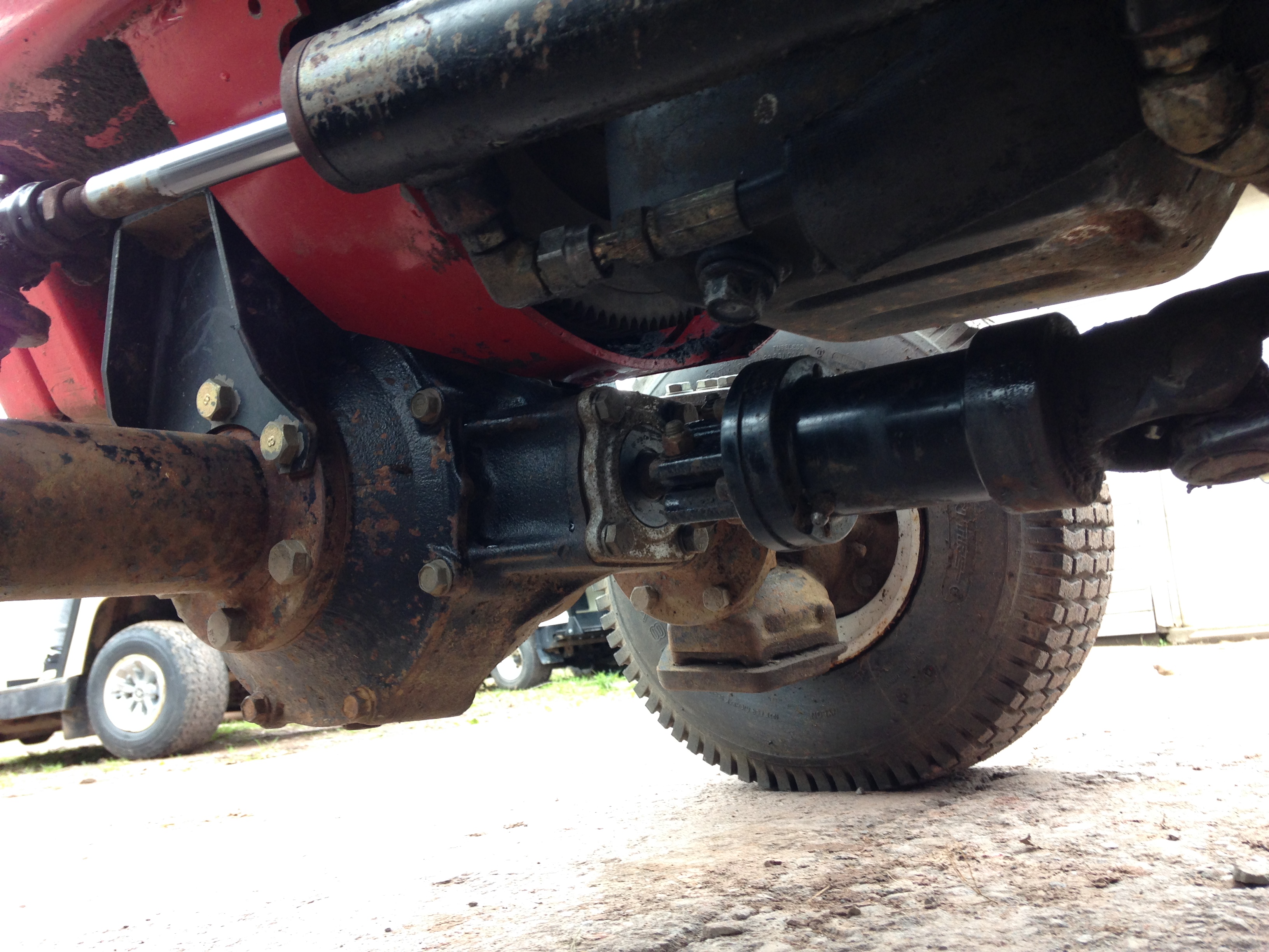

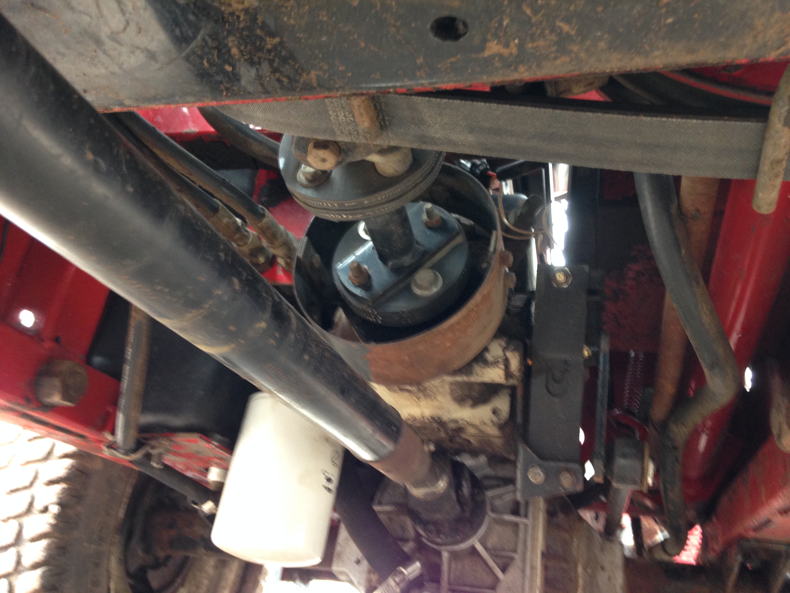

This 325 I知 looking at is 4wd. Can anyone tell me if it has the optional full time 4wd coupling or if this is just a standard overrunning clutch arrangement? Thank you.
Doesn't look at all like my bidirectional clutch. Not to say that it's definitely the static coupler or one-way... but it's definitely not the bi-directional.
As for the decks... they do appear to be compatible decks. All 300 series Groundsmaster decks (including the Groundsmaster 72) are compatible... however, spindles and casters are sometimes not interchangeable. Groundsmaster 72, 327, and most models prior to the 325-D have a different "fine spline" shaft, and will require one of the following:
Option A: replace the rear portion of the driveshaft with the older unit by removing the roll pin from the rear portion (female) of the driveshaft that holds it to the PTO output shaft, and switch them out (the PTO output splines are the same).
Option B: using a later model "broad spline" shaft, remove the split yolk from the deck end U-joint, and replace with the older style split yolk.
Please note, just because the old deck might have the "fine splined" drive shaft, doesn't mean it will have the smaller input shaft in the gear box. Some of the later decks had the same input shaft as the later model gearboxes... so you can simply keep your late model "broad spline" driveshaft assembly, including and split yolk.
I've had my hands on five different deck driveshafts... and three of them were different. My Guardian Recycler shaft had a smaller female section than the late model side discharge. The early model side discharge shaft had two different bearing sizes on the U-joints (possible home brew repair? don't know... welds looked stock) and a smaller orifice to match the smaller input shaft on the gear box. Both of my flail decks had identical male shafts (as they should)... the first didn't come with the female section, but I assume was the same.
