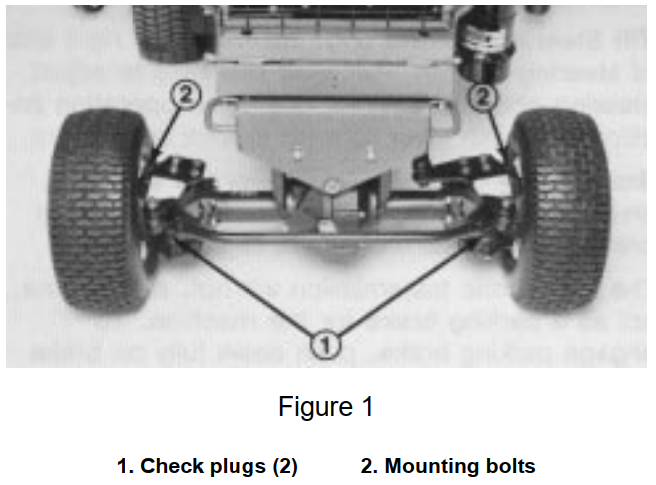

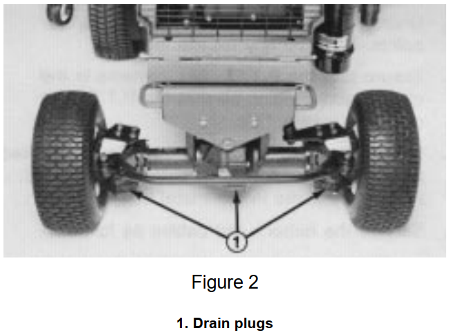

I looked in the parts manual and it appears there is a pipe plug on the bottom somwhere. I think I might have to pull the tire to see it.

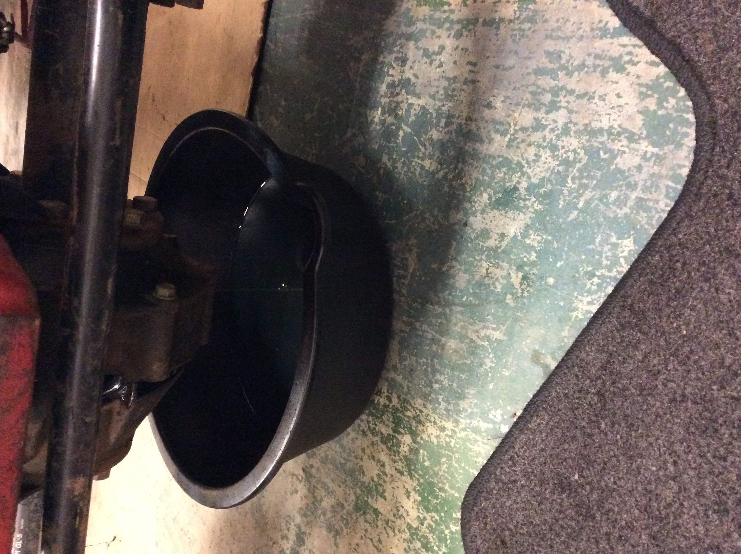

I looked and looked, but didn’t see anywhere to drain the side cavities. Ended up just draining the center section and refilling with fresh 80-90 wt.
The old fluid looked pretty good, no water intrusion or anything.

I haven't drained one, and the service manual pictures are not very good.
I think mine were on the bottom.

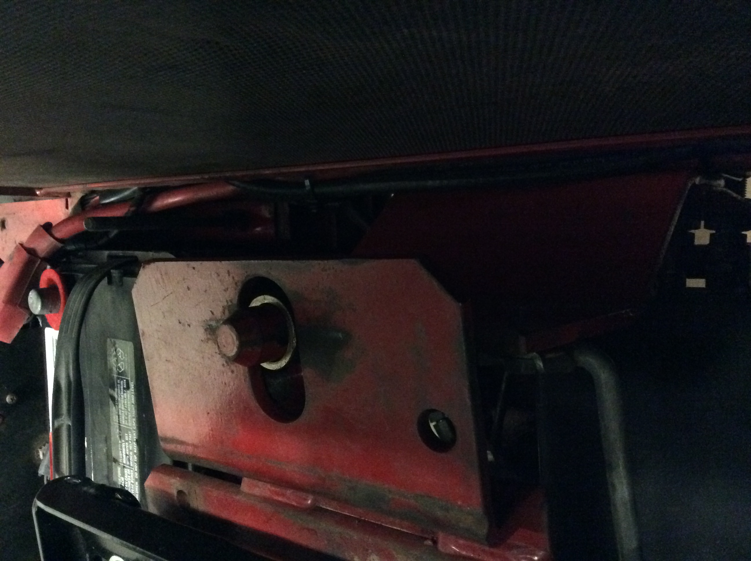

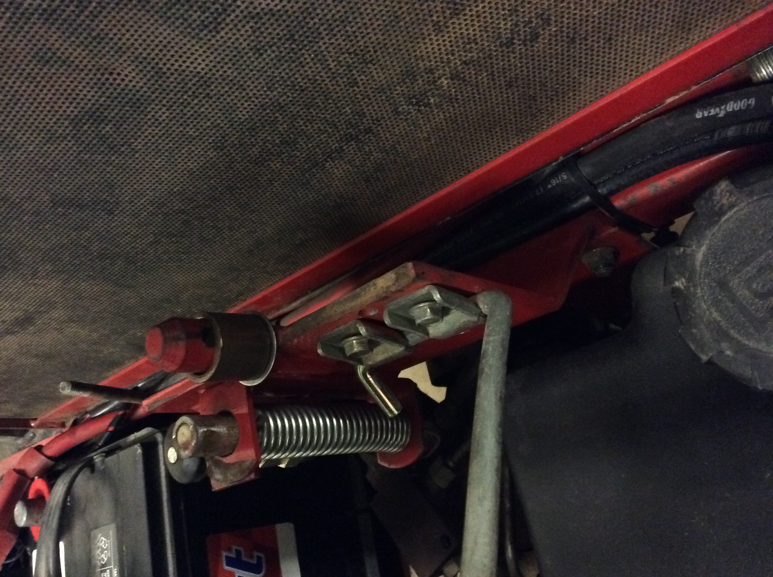

Got my seat on today. Everything bolted up nicely with the new seat suspension kit.
Found the seat was a little sloppy because of some wear on the front seat base pivot. I tightened it up with a 3/4” bronze bushing slipped over the rear seat catch. The seat base is very tight now.

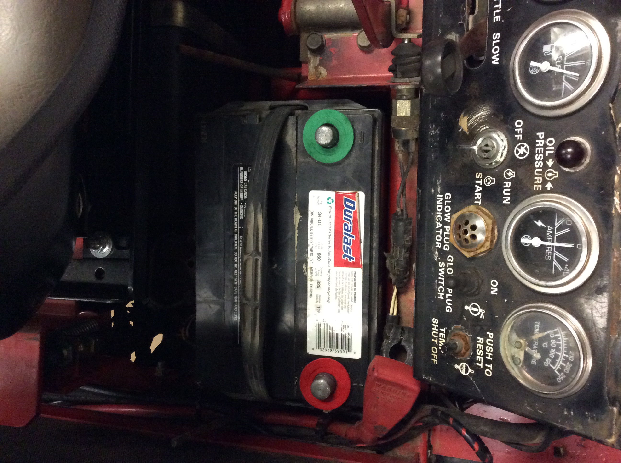

Got my new battery and battery mat installed. The mat goes under the batter and is impregnated with baking soda as far as I can tell.

So tell us more about this battery mat. Is that an OEM part or something you picked up?
I've never seen one. How big was yours and how much did it cost?
Found this on Amazon. Looks like a much better deal than the baking soda sprinkling.
I'll have to see if they have a bigger one for the 1963 4010 John Deere
https://www.amazon.com/Acid-Neutralizing-Mat-12-Black/dp/B00APKZU3C
   / any toro groundsmaster fans on here? #567
Yup, that’s the type of product I use. The name brand one is called battery mat, but there are lots of knock offs now. They work great and prevent corrosion on the spot before it becomes a bigger problem.

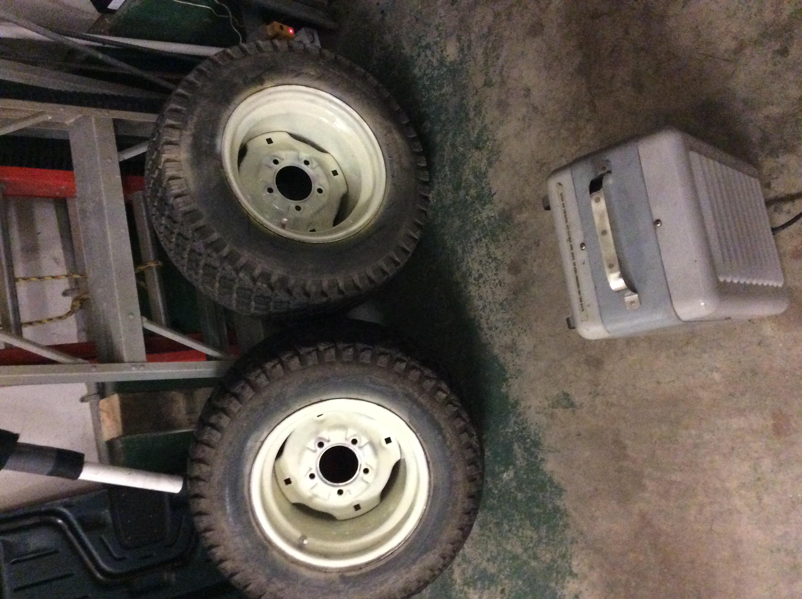

Shot some fresh paint on my new to me 23x10.5x12 wheels.
Can I install these in the wide stance? Or, will it rub on the mower deck arms?
