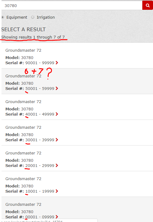

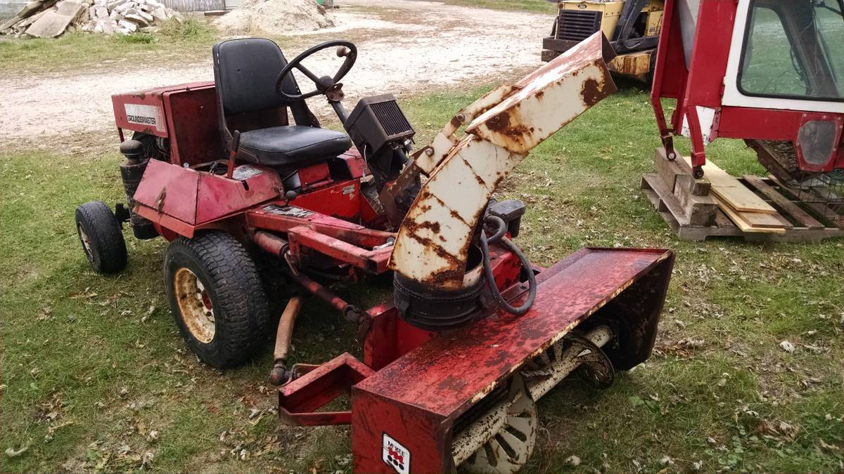

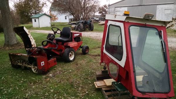

Saw this on Craigslist - not terribly far away. Does anybody know anything about it? Gas or diesel? What parts might work on my 1998 325D or 1996 223D
I don't know the serial number. Any guesses on the year?
Toro groundsmaster with 48in snowblower and cab - $1400

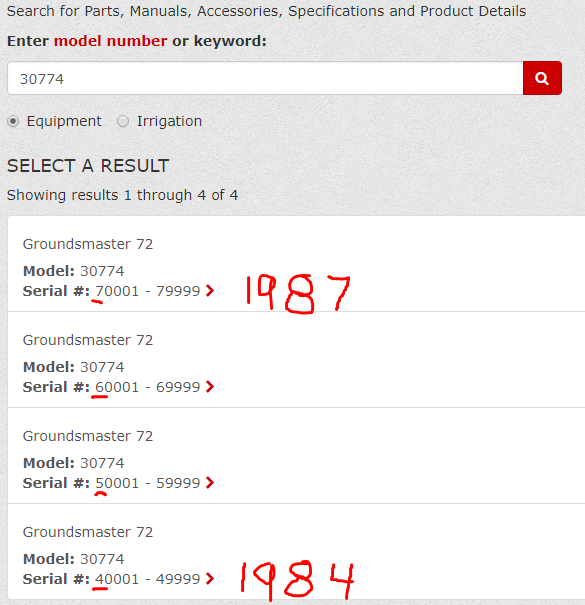

It was replaced by the 322 in 1988. Looks like diesel, from the air cleaner.

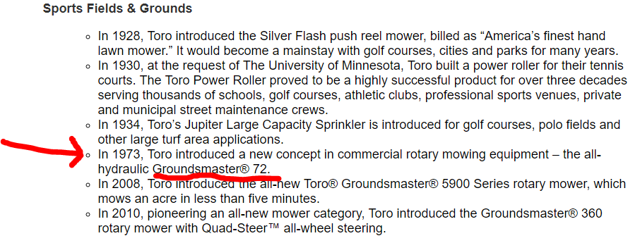

The first digit of the serial number shows it could have been made from 1984 to 1987, same basic frame as the 322/325/328:
Edit the first Groundsmaster 72 was made in 1973.

Did some research, the gas engine used the side mounted air cleaner, the parts list only shows a gas engine.
   / any toro groundsmaster fans on here? #575
Got a hold of the seller 1983 4 cylinder gas, serial 30780-20651. I'm not really interested in a gas unit.
If he has it a while, I might be interested in it for resale. to copy the snowblower shoot turning mechanism.

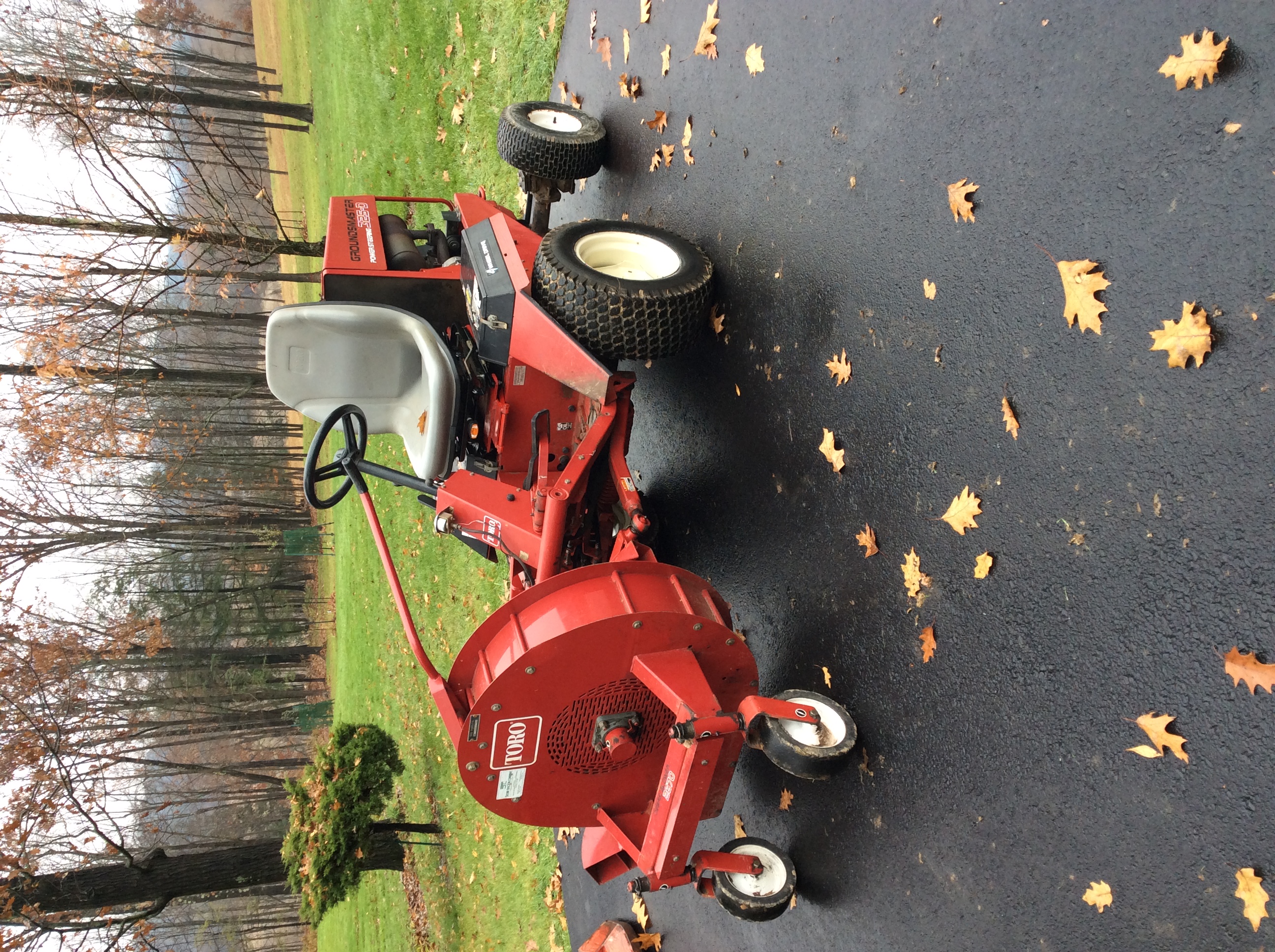

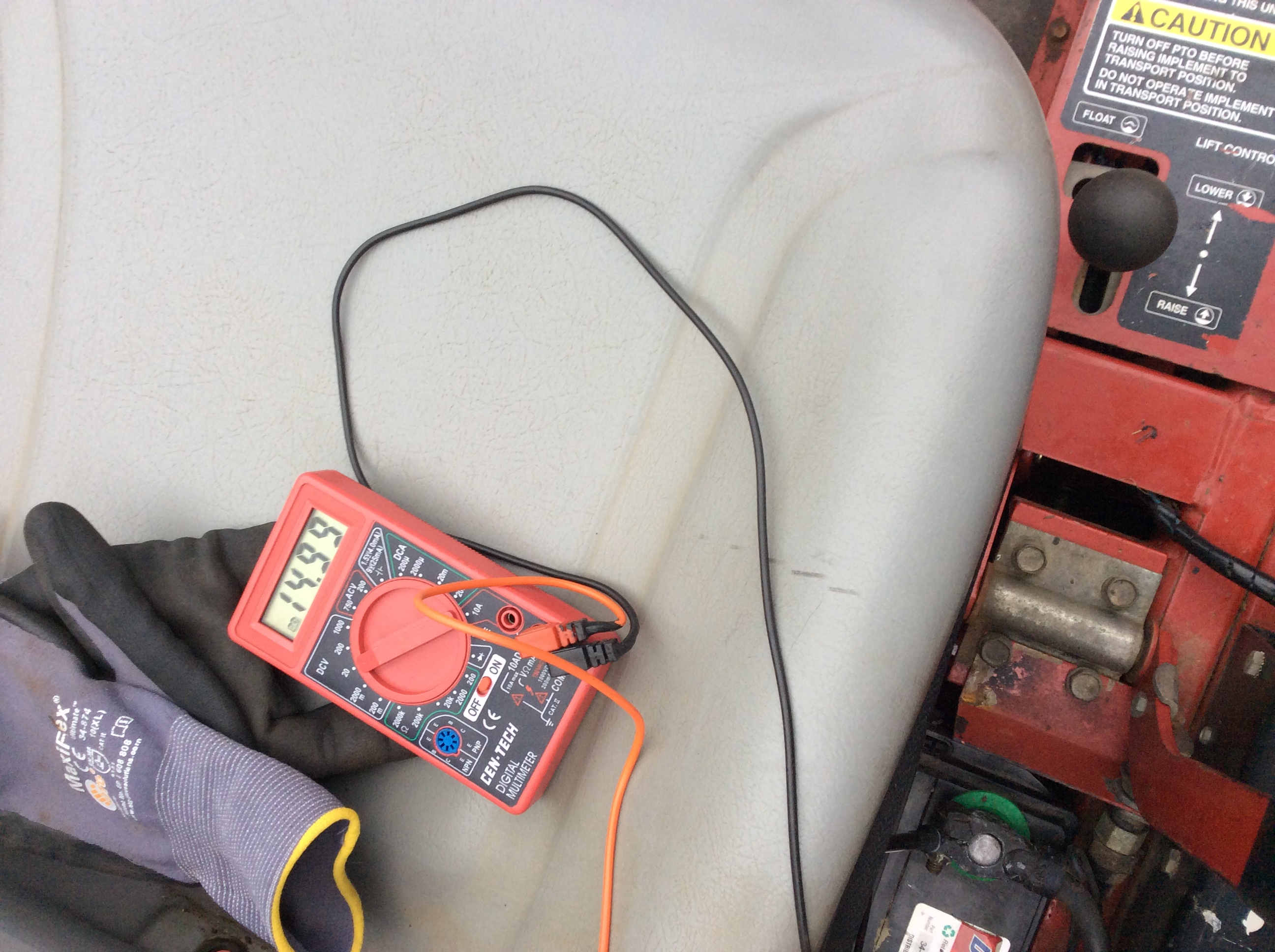

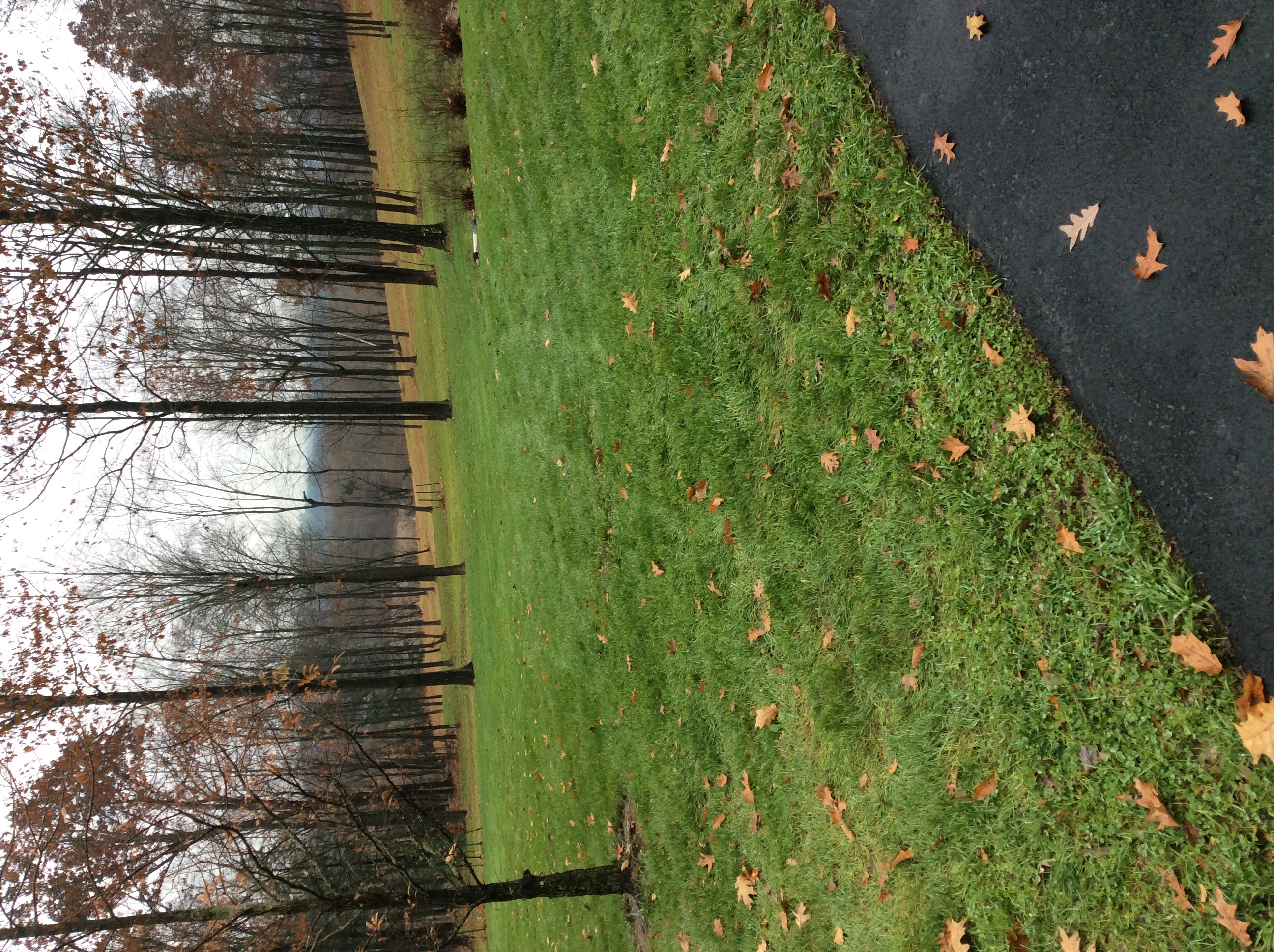

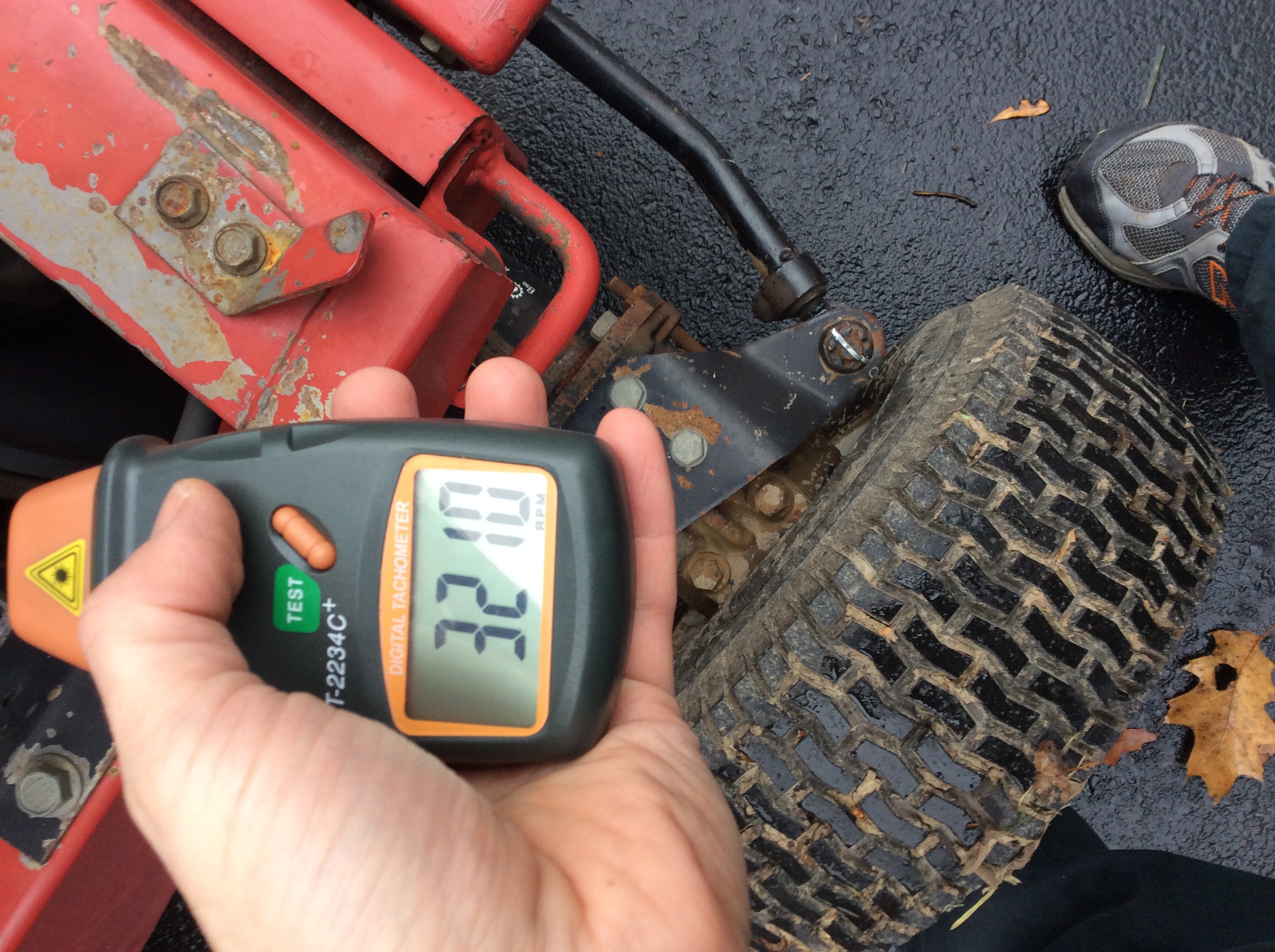

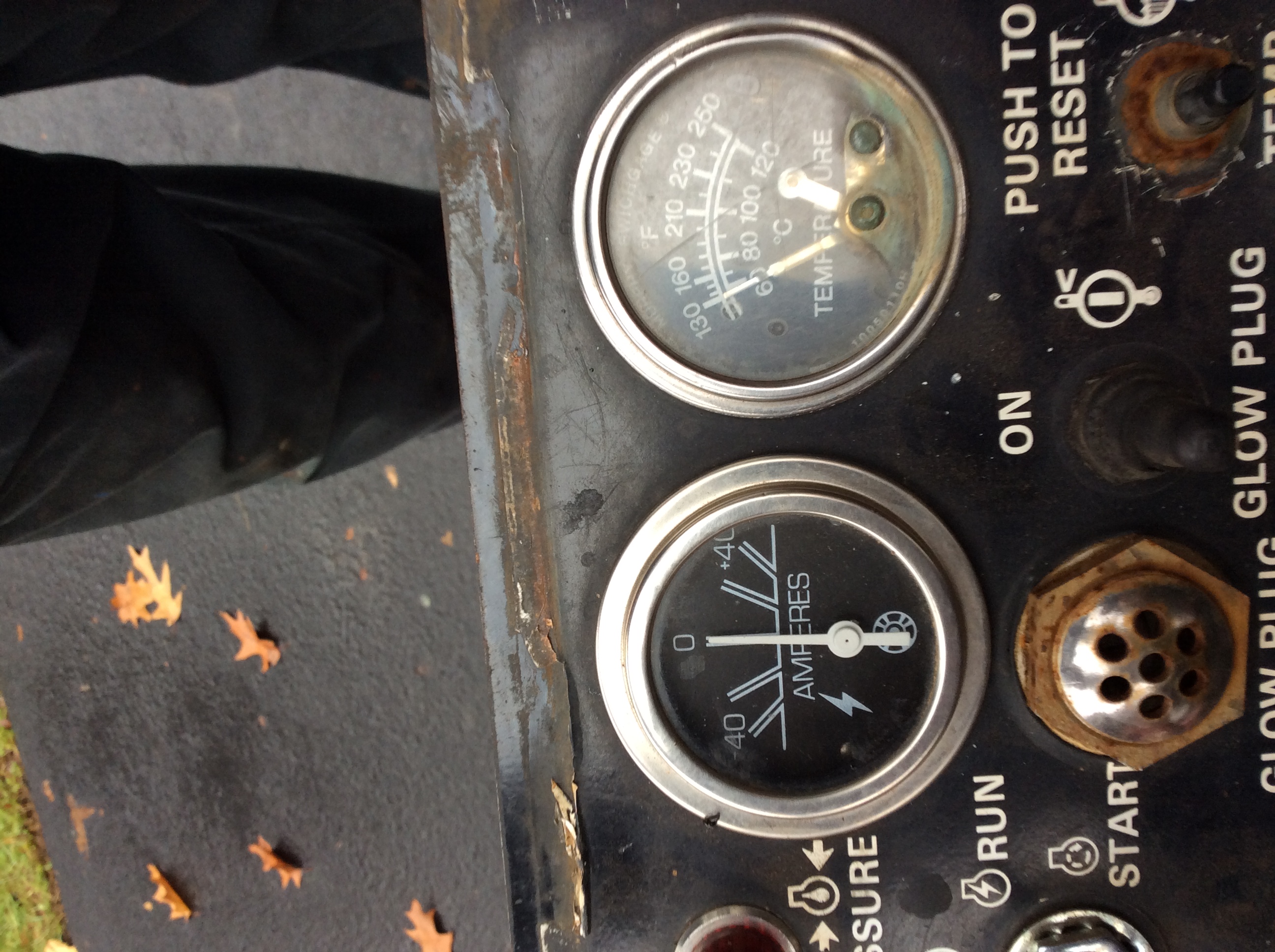

325d is done! Took care of some finishing details today.
Checked the charging system to see if it was working. Appears to be working fine. The strange thing is the ammeter not really showing a charge with 15v being produced. It does deflect down when I engage the glow plugs, so the meter is actually operating. This is why I like voltmeters better.
Adjusted the throttle cable and got the rpm right on the money.
Gave the leaf blower a workout yesterday. It works well for the most part. When the windrow of leaves gets too big it has a problem blowing it. I generally just blew things off into the woods, or out to an area of lawn with poor soil and mulched them in with my mower. Had a blast using it until....
The yoke that attaches to the input shaft of the blower came loose, allowing the pto shaft to slip off and flail around, scared the heck out of me! I noticed it in time because I felt the vibration and knew something was wrong. I throttled down, disengaged the pto, and killed the engine, but it was too late. Looks like the thru bolt sheared off, or vibrated loose allowing the yoke to come off. Scary stuff, be careful out there.

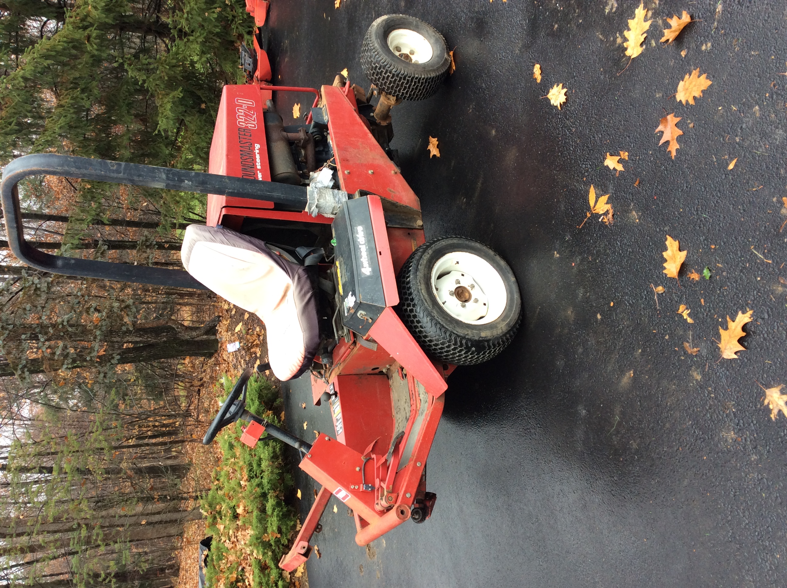

Next in the shop is my new to me 322d. Compared to the 325, this one is in much worse shape, should be interesting. I won’t torture you again with all the details. If something new or different is found I will post.
Please keep posting details. We like details.
The pictures might help someone in the future. :thumbsup:
