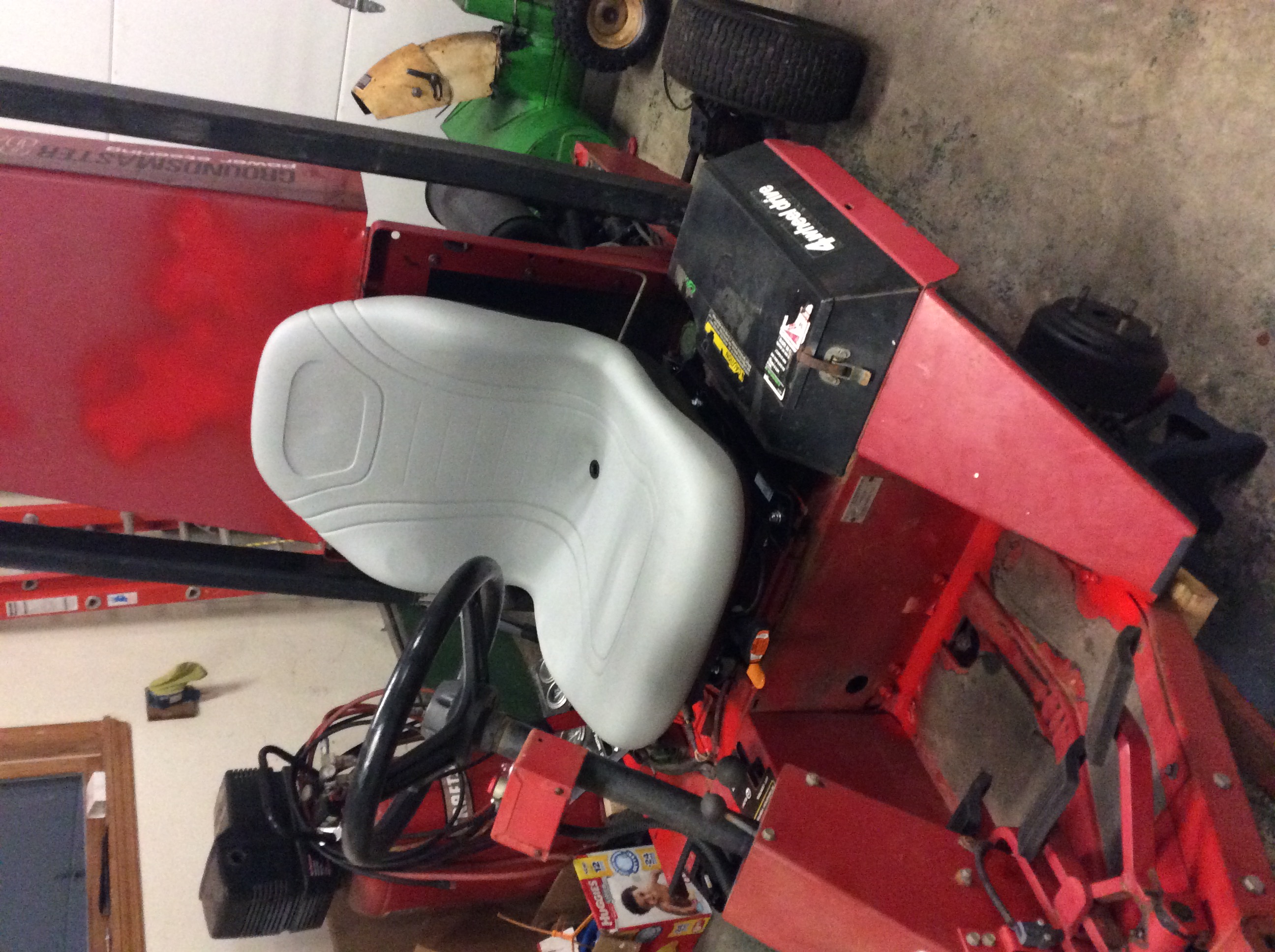

New seat installed. It was a direct fit, no mods needed. The height feels good even with the suspension under the seat.

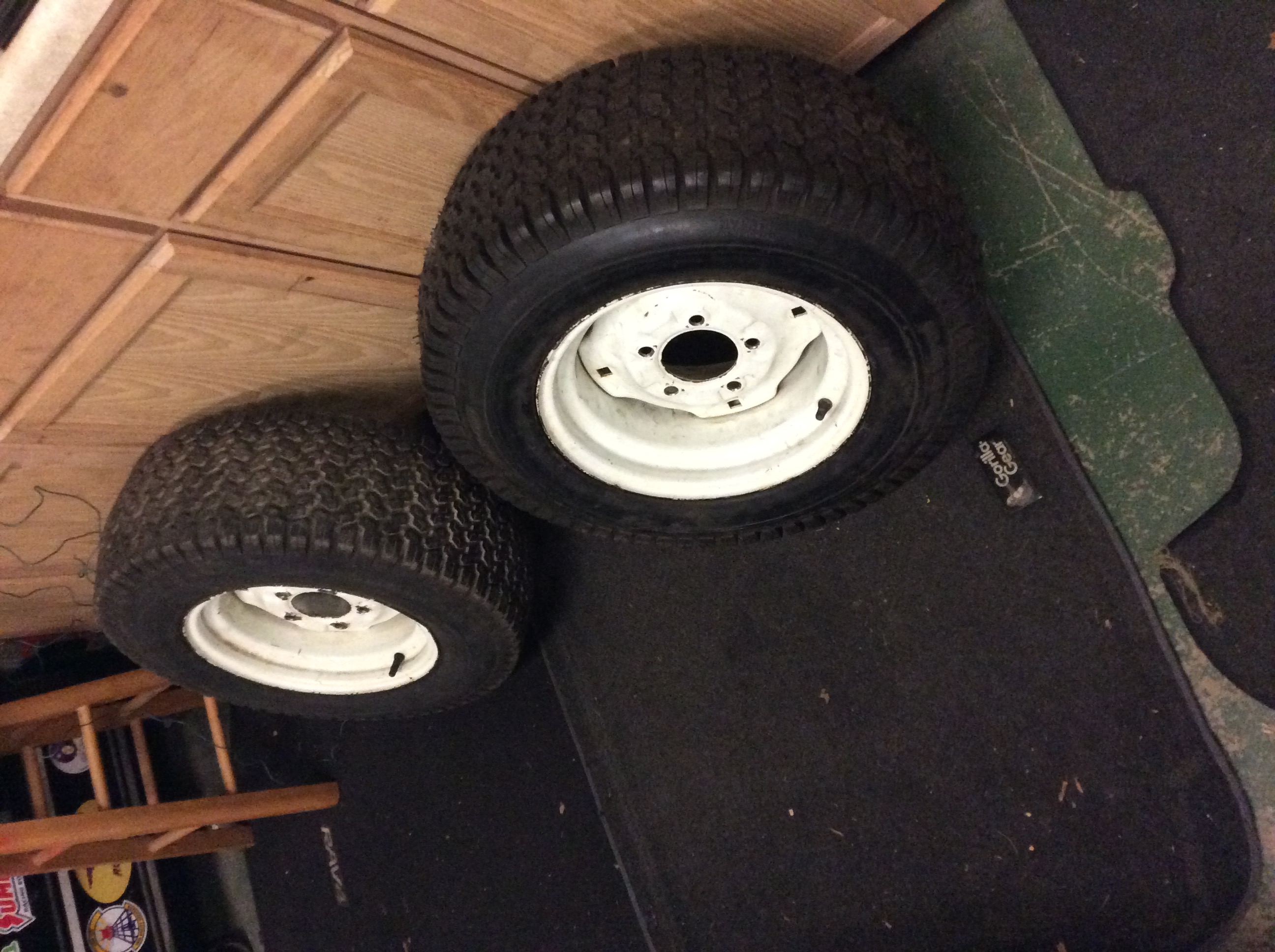

The tire is finally on the rim. The tire shop had to use two bead blaster simultaneously to get the bead to seal. I could hear them cursing from the waiting room...lol.

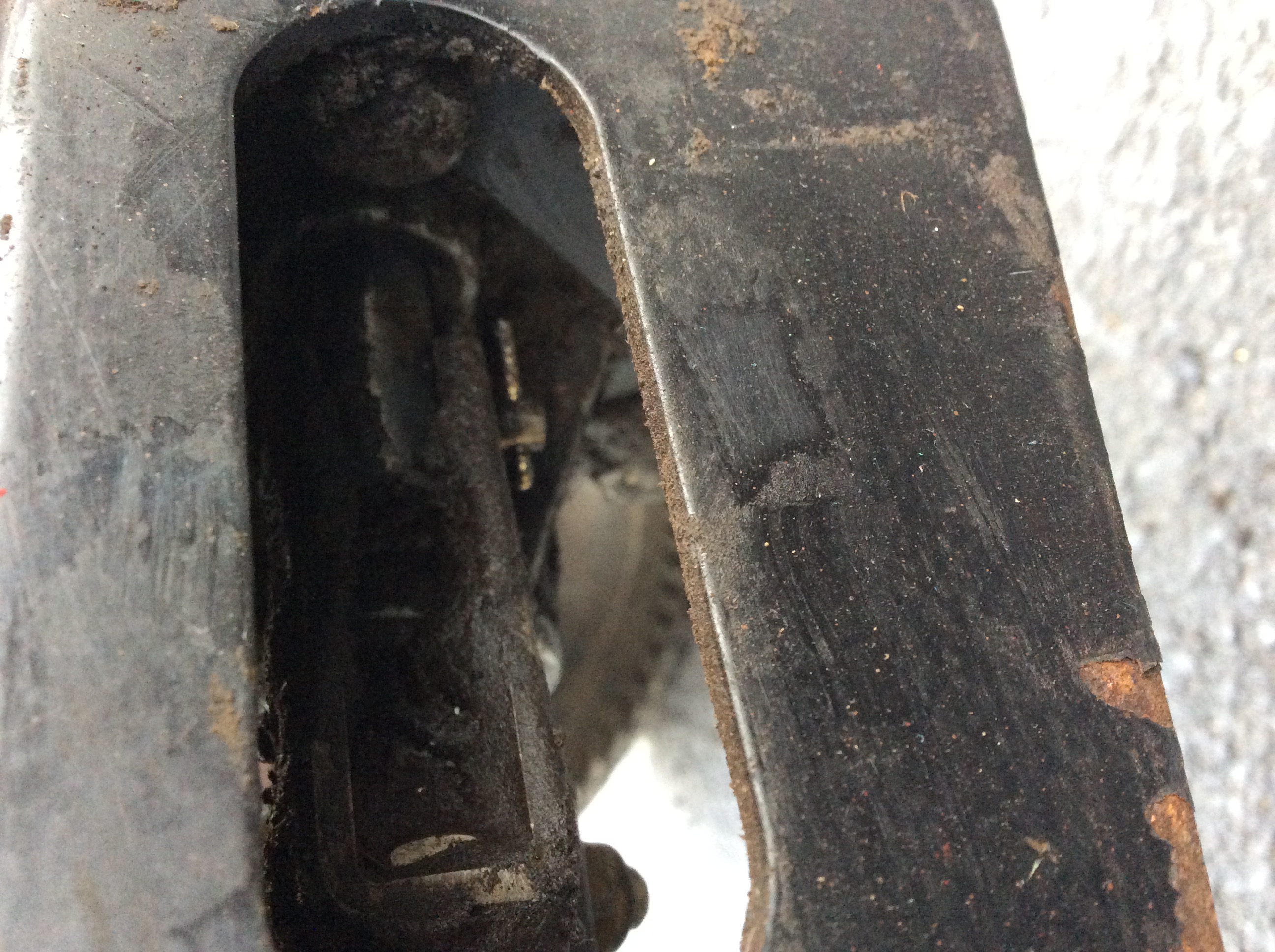

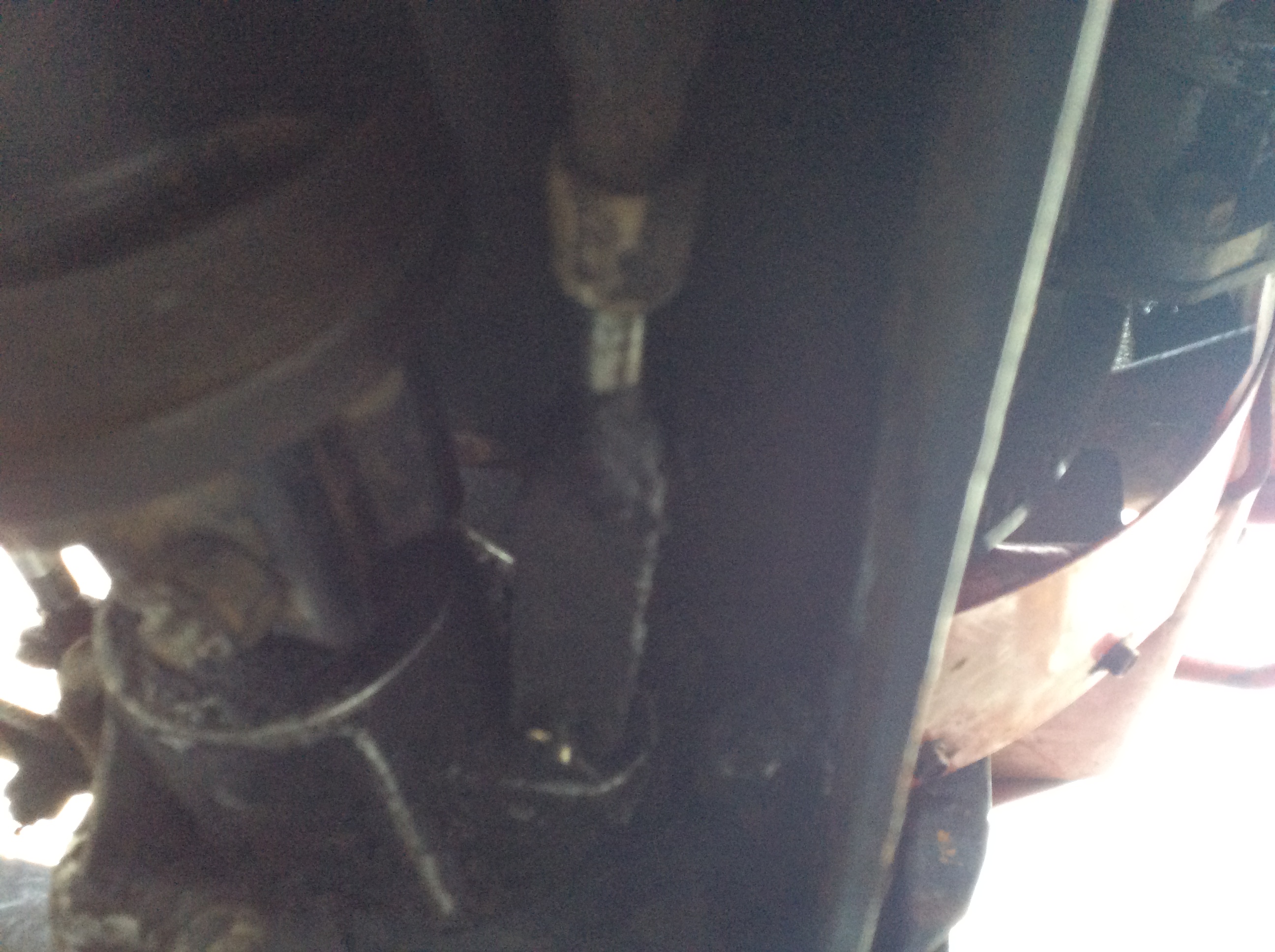

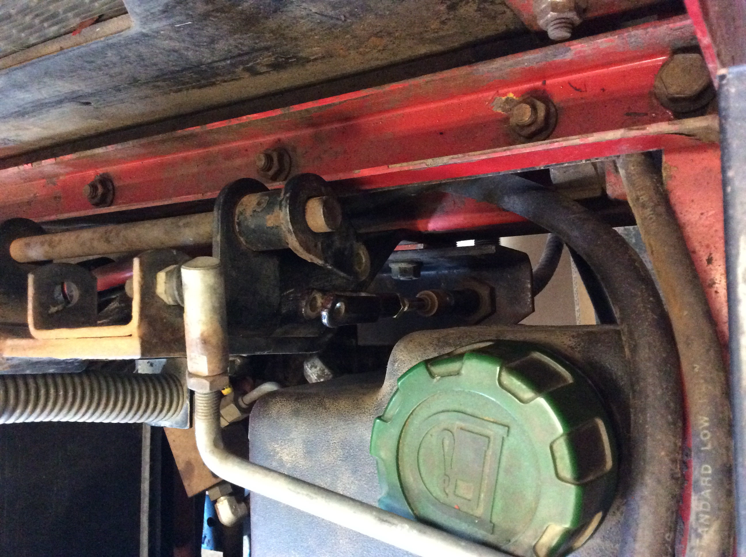

Close up of how the 2wd/4wd bracket and bellcrank attach to the push-pull cable. Pretty simple design actually.
Please show the other end of the cable and what connects the driveshaft to the differential. I haven't seen it or read anything about it.

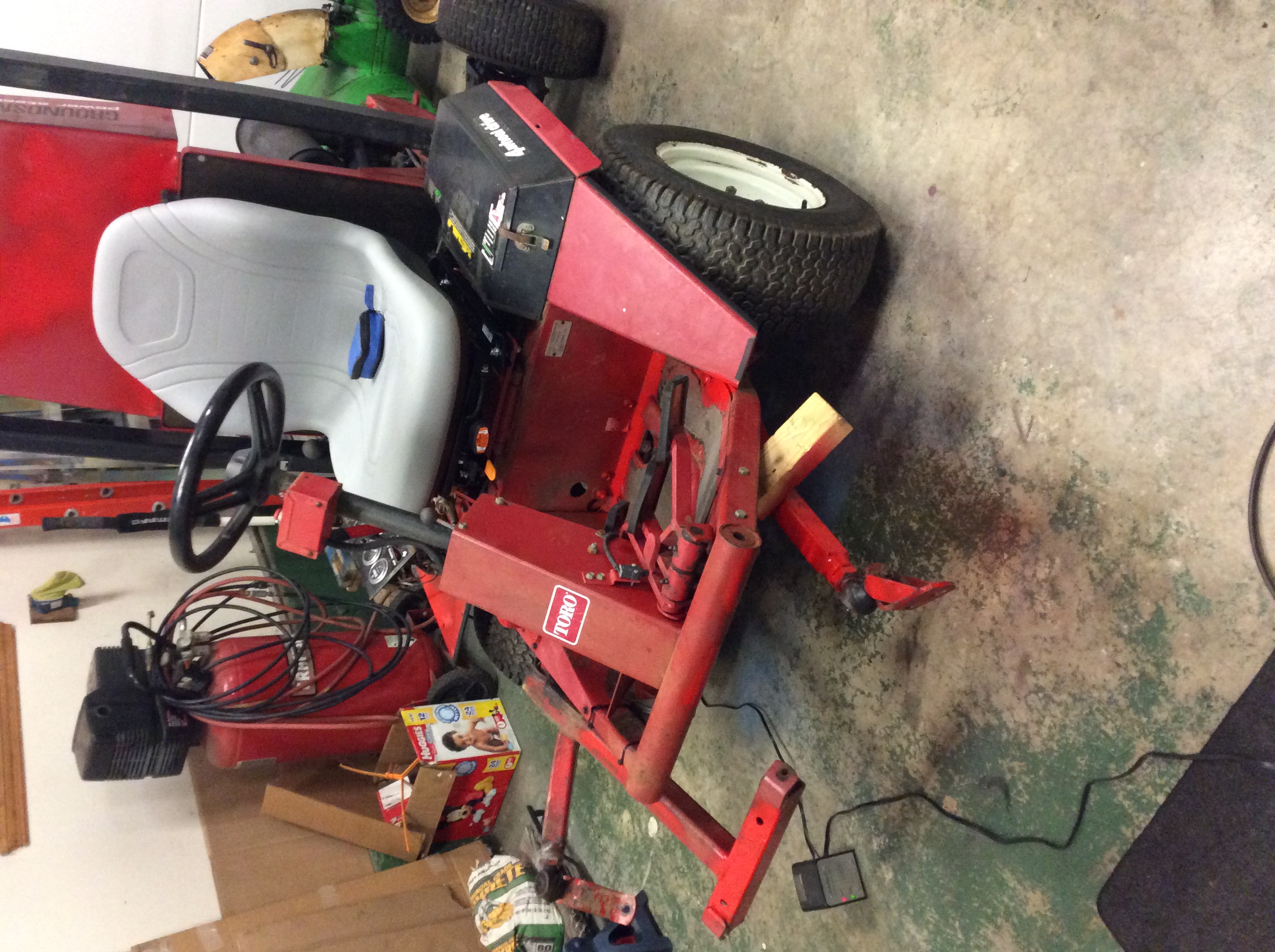

New tires on, seat installed, battery charging...first start tomorrow.

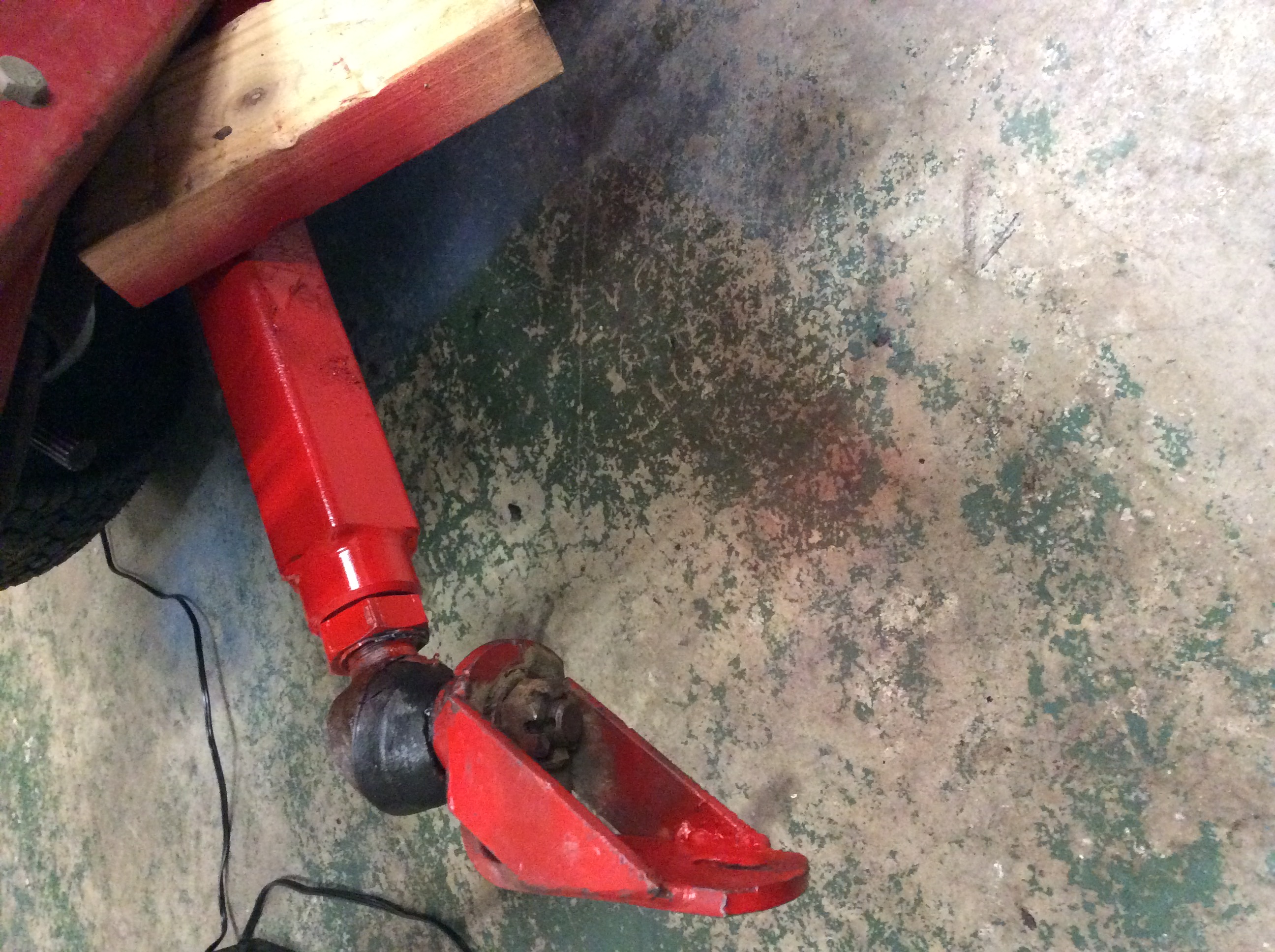

Push arm ball joint was frozen inside the arm from rust. Took lots of heat to free it up, but it’s good now.
Will get some better pics tomorrow for the 4wd engagement.

Xfaxman here are some pics of the 2wd/4wd enagement mechanism.
Standard one way clutch, same as on the 325.
On the left side you can see the bracket that holds the push-pull cable and clevis.
Close up of the bracket, you can see the clevis and push-pull cable inside here. The clevis attaches to a pin that enters the gearbox. This pin is attached to a shifter fork with a gear on it. Moving the lever up front engages and disengages this gear.
View of the bracket from the bottom. You can see the clevis, push-pull cable, and pin entering the gearbox.

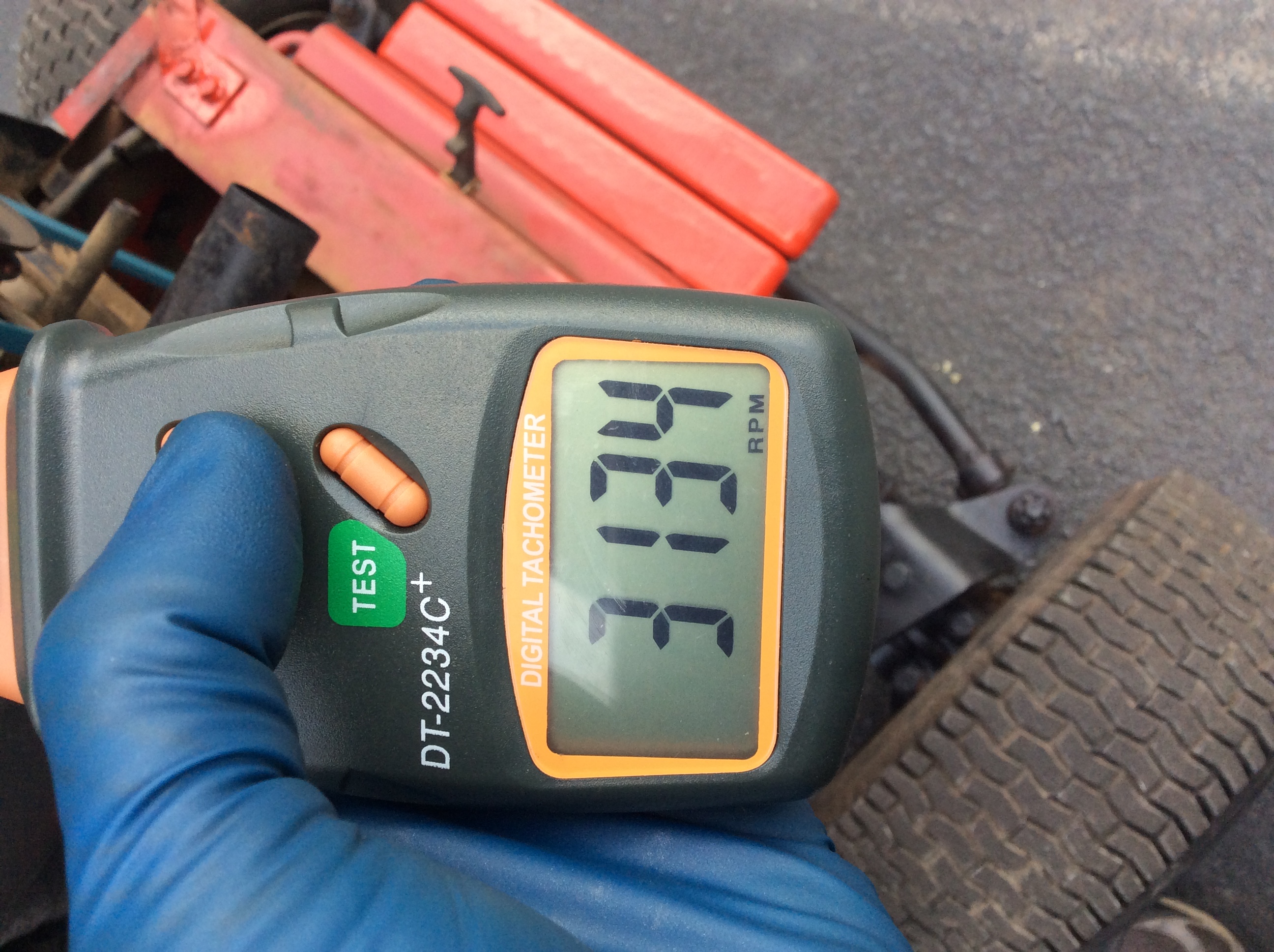

First run of the 322d went well. No major issues, but a few small fixes needed.
Ran her up to speed and rpm’s were a bit below spec of 3200, but close enough for me. This tractor will be running a rotary broom, so I’m not too worried about pto rpm.
Thanks, that really clears things up :thumbsup:.
But don't understand why they still use the one way clutch.
