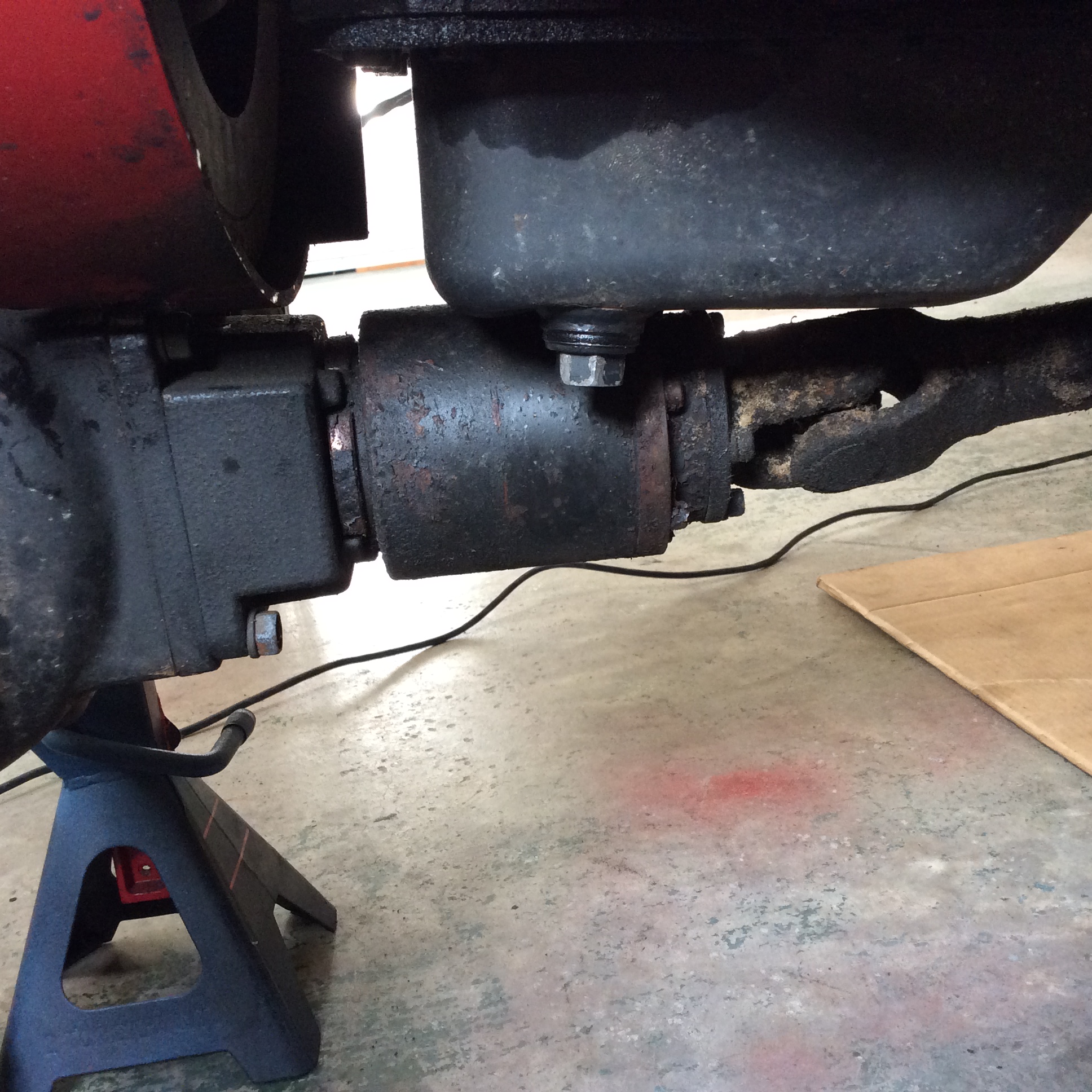

Better shot of the bidirectional clutch. The manual calls for a Mobil 424 fluid, is there anything else I can use? Saw a guy online used gear oil, good or bad idea?
I think gear oil is too thick.
I used some Bobcat brand fluid that I had. It was similar to Mobil 424 fluid.

Options were to cut off the brake stud and reweld later or remove the whole front engine mount. I chose to pull the mount as it was only four bolts. First step was to remove the rear axle drive shaft, which is fine because I had to pull the bidirectional clutch to see why it was loose.
The clutch came off next.
Found part of the reason for the loose clutch. There is an interior bushing that was worn, will order a new one.
