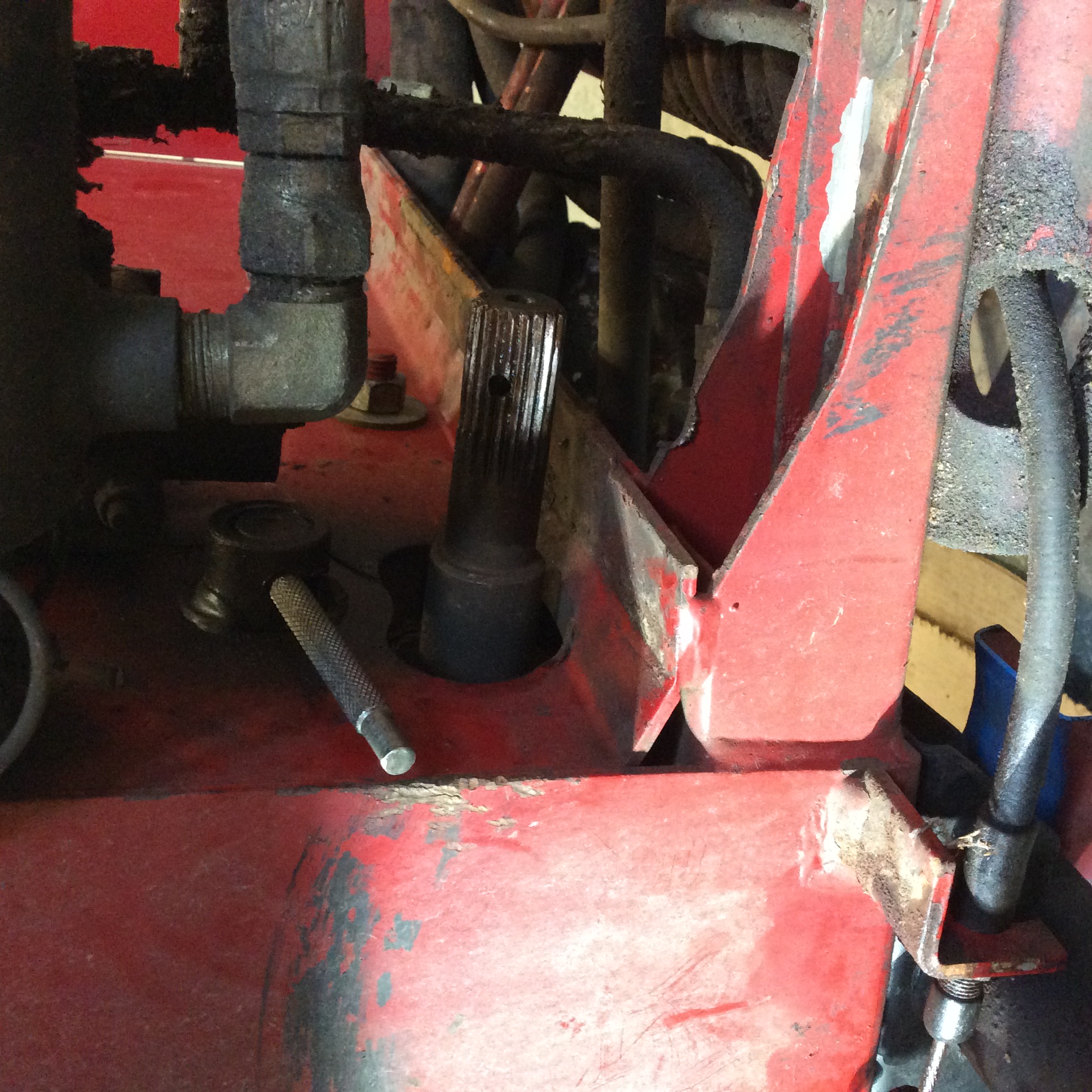

Finished tearing apart the 325 to get at the pto.
With the seat removed, as well as the fuel tank it gives you some room to work in there.
After inspecting the pto, here is what I found.

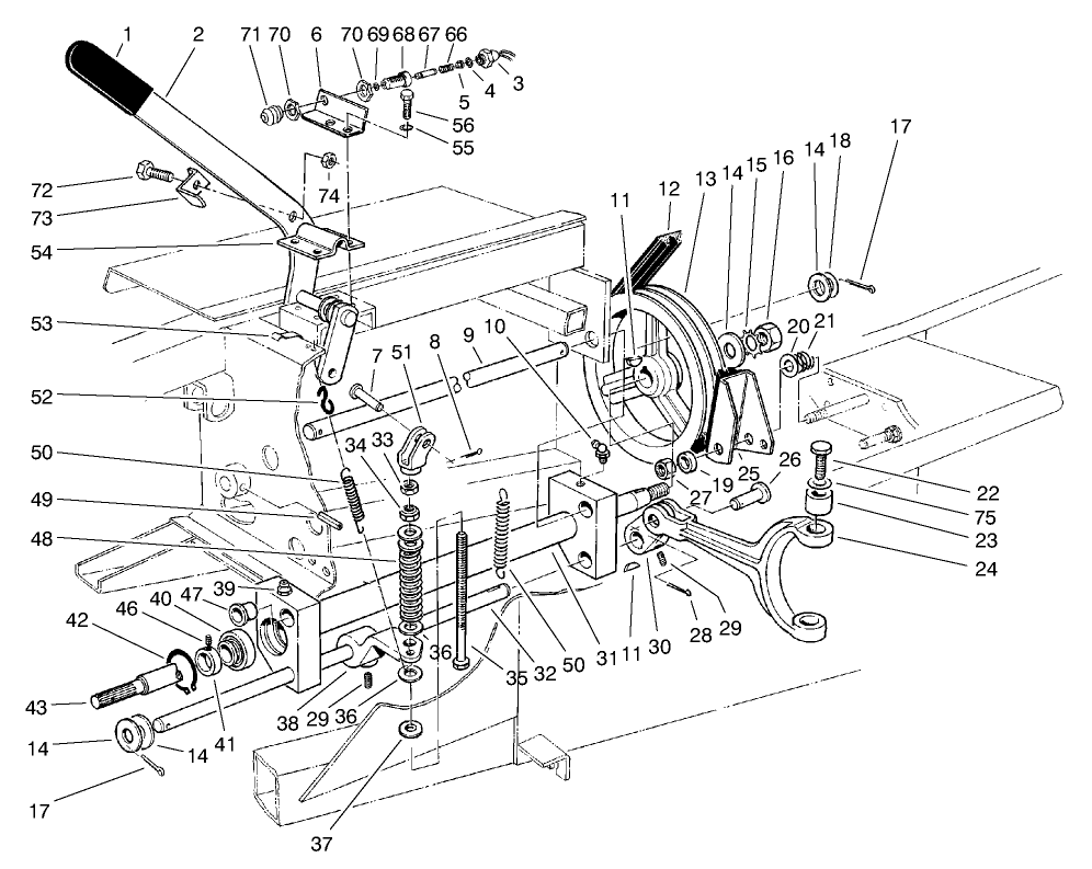

Rod 9 is loose in the frame. The front mounting boss in the frame is slightly loose, but the rear boss where it sits inside the frame it has worn an egg shape hole, maybe 1/2 - 3/4 out of round. Rod 9 also is missing some washers/spacers on the extreme aft side just before the cotter pin (Item 14 & 18) which allows the entire pto shaft and tube to slide forward and back.
Plan is to perform the pto belt alignment procedure first so I can see if I need to add spacers on the front or aft side of where the pto sits on rod 9. I know that is not the way the procedure is performed, but it will attain the same result without having to mess with the eccentric collars. I will then go through the pto removal procedure so I can address the egged out frame boss. I will weld in a new bushing to support rod 9, as well as replace the bronze bushings 47 while I知 in there. The pto bearings feel fine, but will get inspected while everything is out.

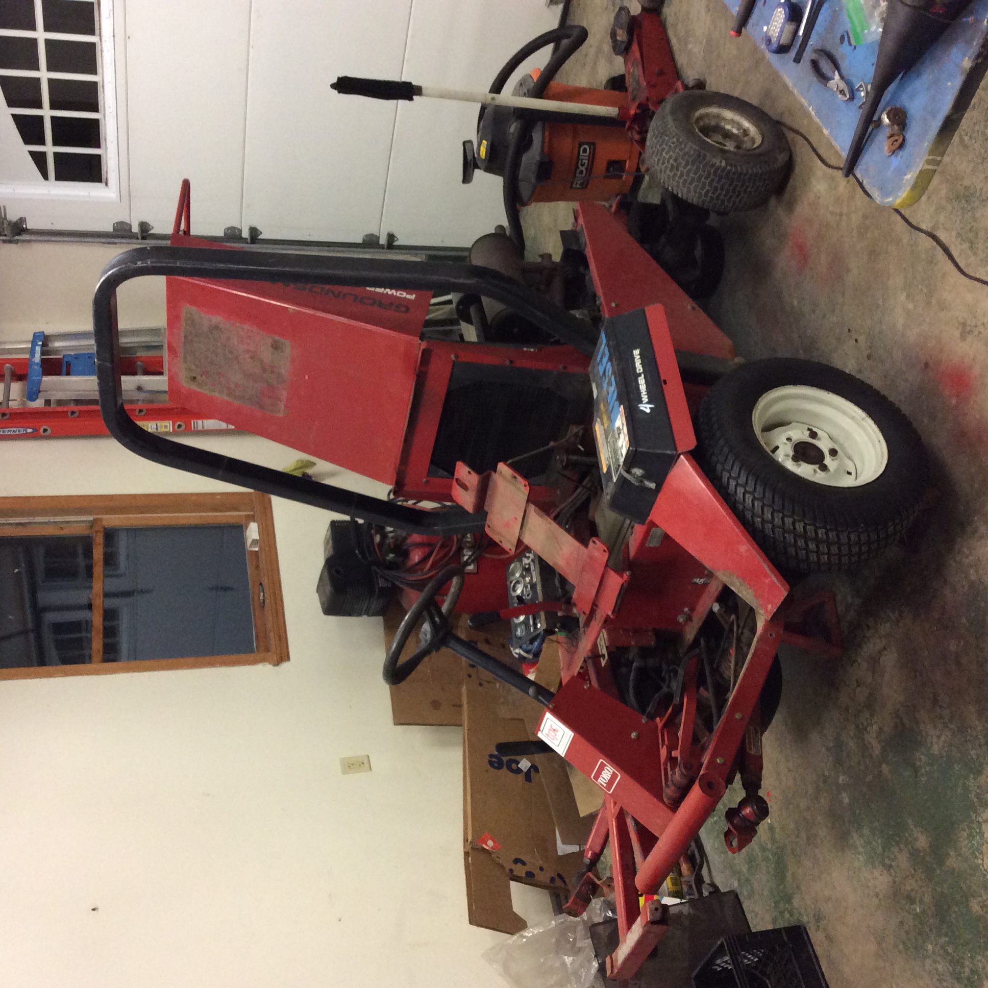

Here is how she sits tonight. Brother is coming by tomorrow to help me get the roll bar off. Too many low branches here.

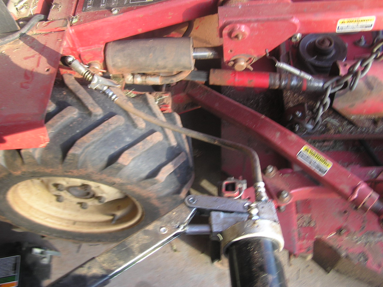

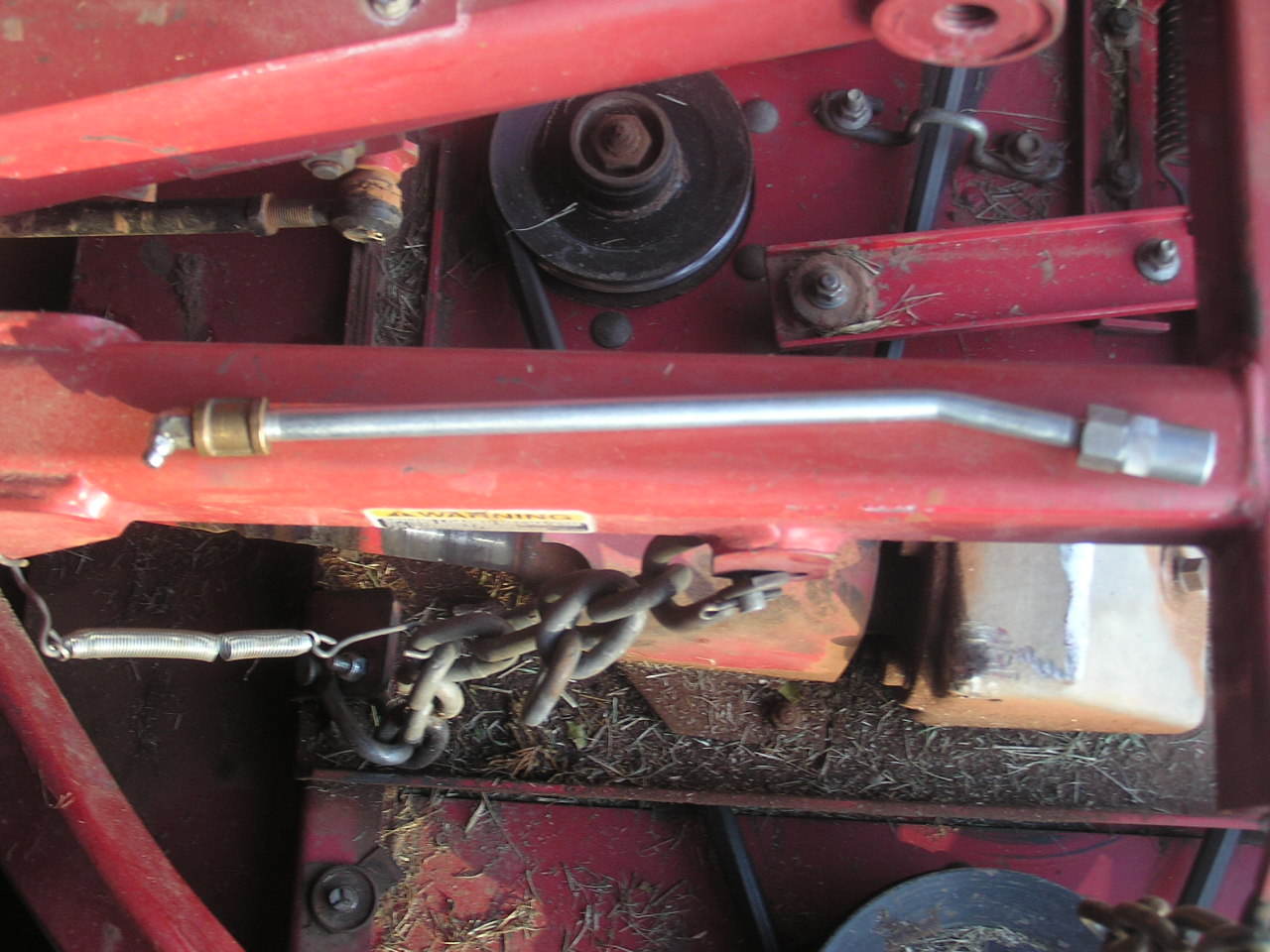

Does it look like both of the zerks have been being greased? The front one is hard to get to.
This is what I use to reach it with the LockNLube coupler:

That’s pretty slick. I was thinking of doing something like that also, but was wondering how to go about it. It’s just so hard to reach that fitting. Does it stay on all the time, or just while greasing?
Just while greasing, it is only an extension.

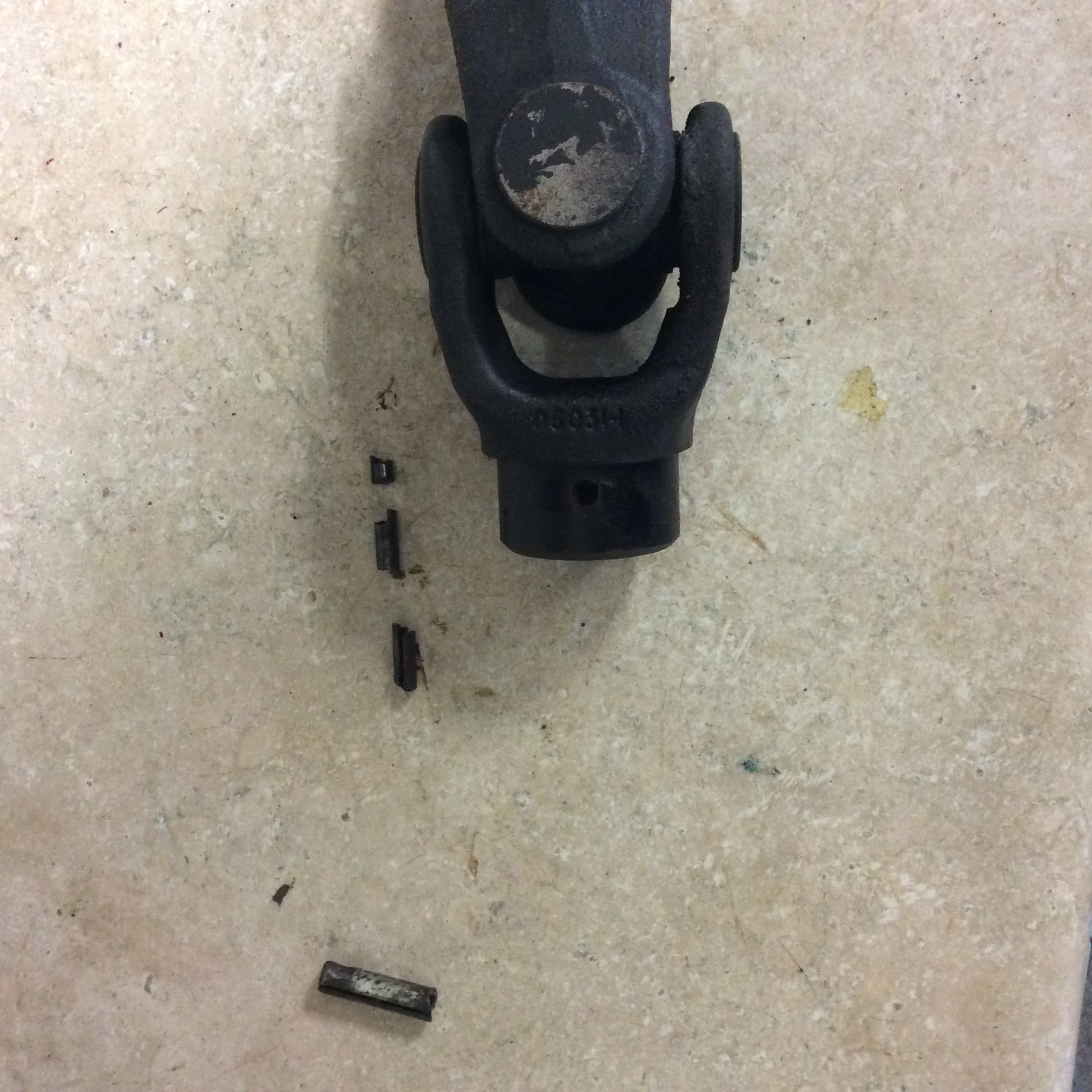

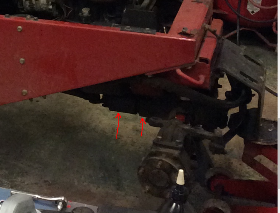

Starting the pto removal.
Drove the pto roll pin out and if fell out in 3 pieces. Surely a disaster waiting to happen.
Both pins removed. The pto hangar rod roll pin was also broken, so will need to replace that too. The punch is still in the hangar rod hole in this shot.

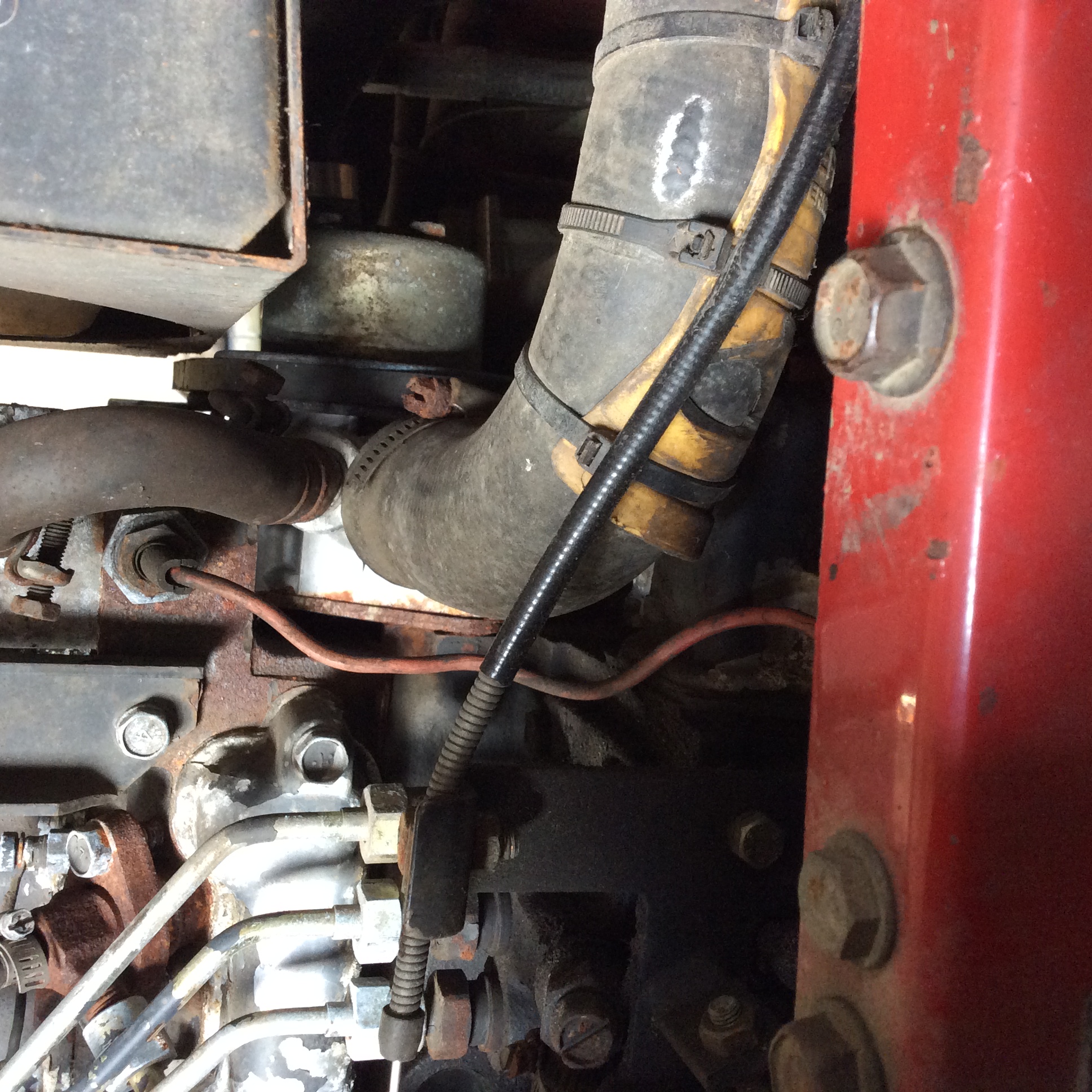

Was wondering what was going on with this water pump pulley. Seems awful close to the radiator shroud. After looking some more, it appears the entire radiator and support housing are sitting back about 1/2”. I think I can loosen the bolts and shove it forward again, but not sure if that will work.
Better shot of the bidirectional clutch. The manual calls for a Mobil 424 fluid, is there anything else I can use? Saw a guy online used gear oil, good or bad idea?

Are there any places a flexible line could be permanently attached? I have done that before with a grease gun extension hose on other equipment. Haven't messed with the 325D much. Still haven't got the snowblower figured out and it's long past snow season
