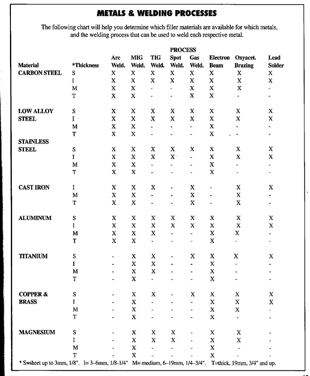

I don't disagree but here is opinion from my welding manual...

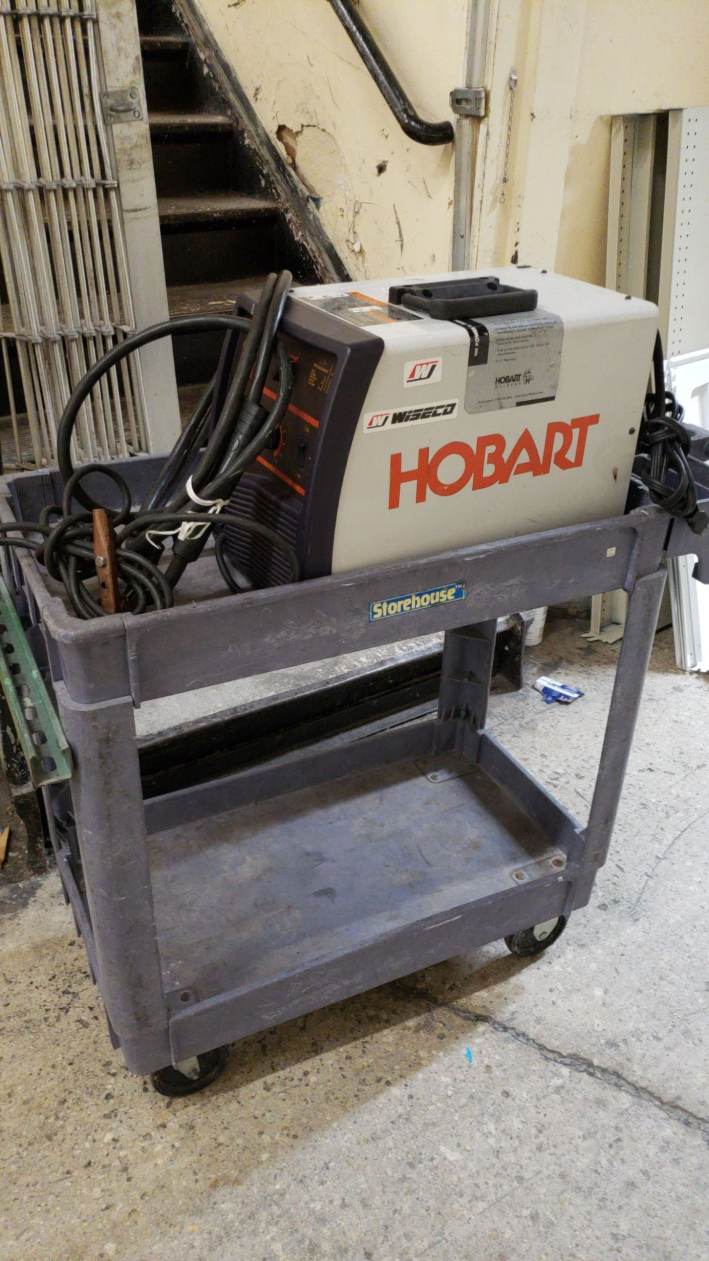

Hi to all I have done thin sheet metal with my Mig but with shielded gas 75-25 at the lowest setting. Flux cord will not work for thin body panels. Flux cord is great for welding outside thicker metal, where you can’t use shielded gas because the wind will mess up your weld up. I have a small Hobart 120volt. I got mine Northern Tools about 15 years ago So I can take anywhere. I love it. I use too restore old VW’s and add ragtops roofs. I would weld about half inch then space the weld again. Then later come back to where I left the gaps so I would not warp my metal. Then grinder. It worked awesome. But I did practice on old fenders first.
