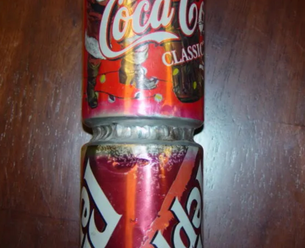

This wasn’t done with a small 120 volt machine rather a very large one turned way down.
That's me. Of course it's a TIG weld. You could never do that with any other process. I've considered taking mine to the bottle-can return machine to see what it does with it....lol

Wow. Stick and MIG will create brittle cracks between the weld and the other metal. The previous statement is untrue. It may be that when you use stick or MIG on thin metal you get brittle cracks between the weld and the other metal. And if you do then you are doing something wrong. Both stick and MIG are entirely capable of making good welds without causing any cracks or brittleness anywhere. It is unfortunate that you are having this difficulty because welders all over the world are are using stick and MIG to make escellent welds every day world wide. They are not using any kind of magic wire or electrodes either. In fact, most of the time they will be welding with 6000 or 7000 series stick welding electrodes or 70 series solid MIG wire with either C25 or straight CO2 gas. Welders who know what they are doing do not have the problem you are apparently having. I suggest you practice some more and learn some more.
I sure hope the OP doesn't get discouraged by folks telling him what he wants to do can't be done, and done easily. He already has some sort of wire feed machine. If the machine is any good he will be able, with practice, to MIG weld his parts successfully. He will have good welds that will be as strong as factory welds. Maybe not as pretty though. I am truly amazed at how much bad information is on the internet.
MIG welding is easy, the easiest of all processes. Though it is also possible to make MIG welds that look great but are actually bad because they have not penetrated the parent metal, with not too much practice it is easy to make good welds. Let's hope the OP tries out his MIG welder and then posts his results. With pictures.
