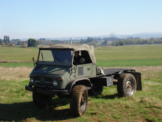

Here is my Mog, we now have the troop carrier bed on it instead of the mini-flatbed. We actually hauled a 2500 lb compact tractor on it to a local show...sort of a "we can deliver ANYWHERE statement. With the soft coil springs, it really had some body roll with the tractor up there.
