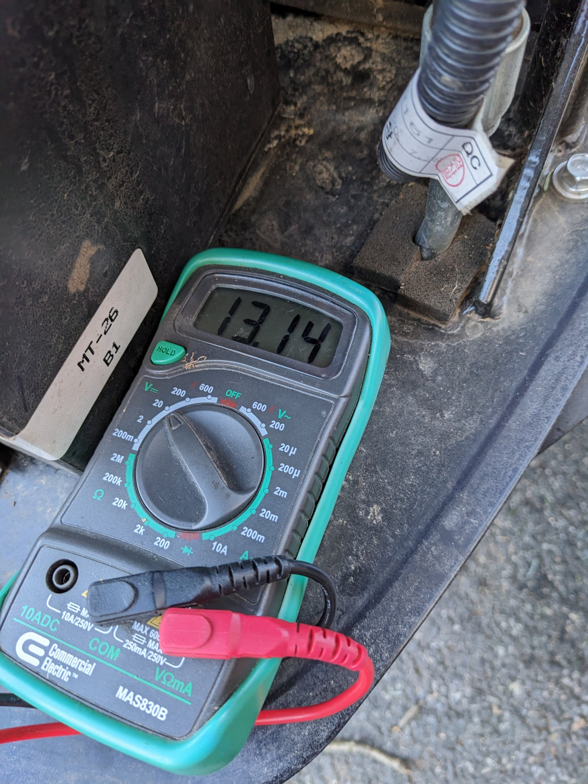

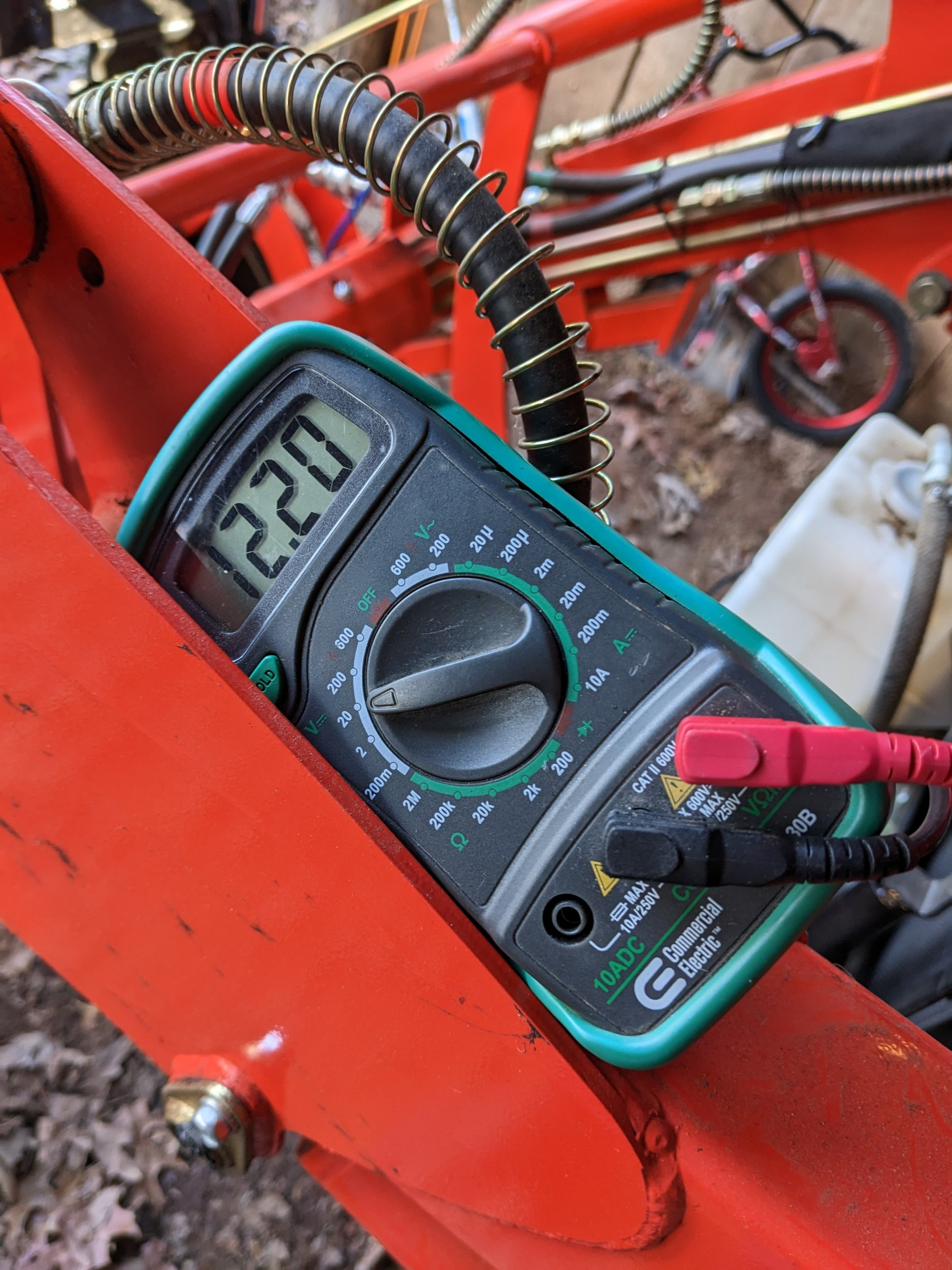

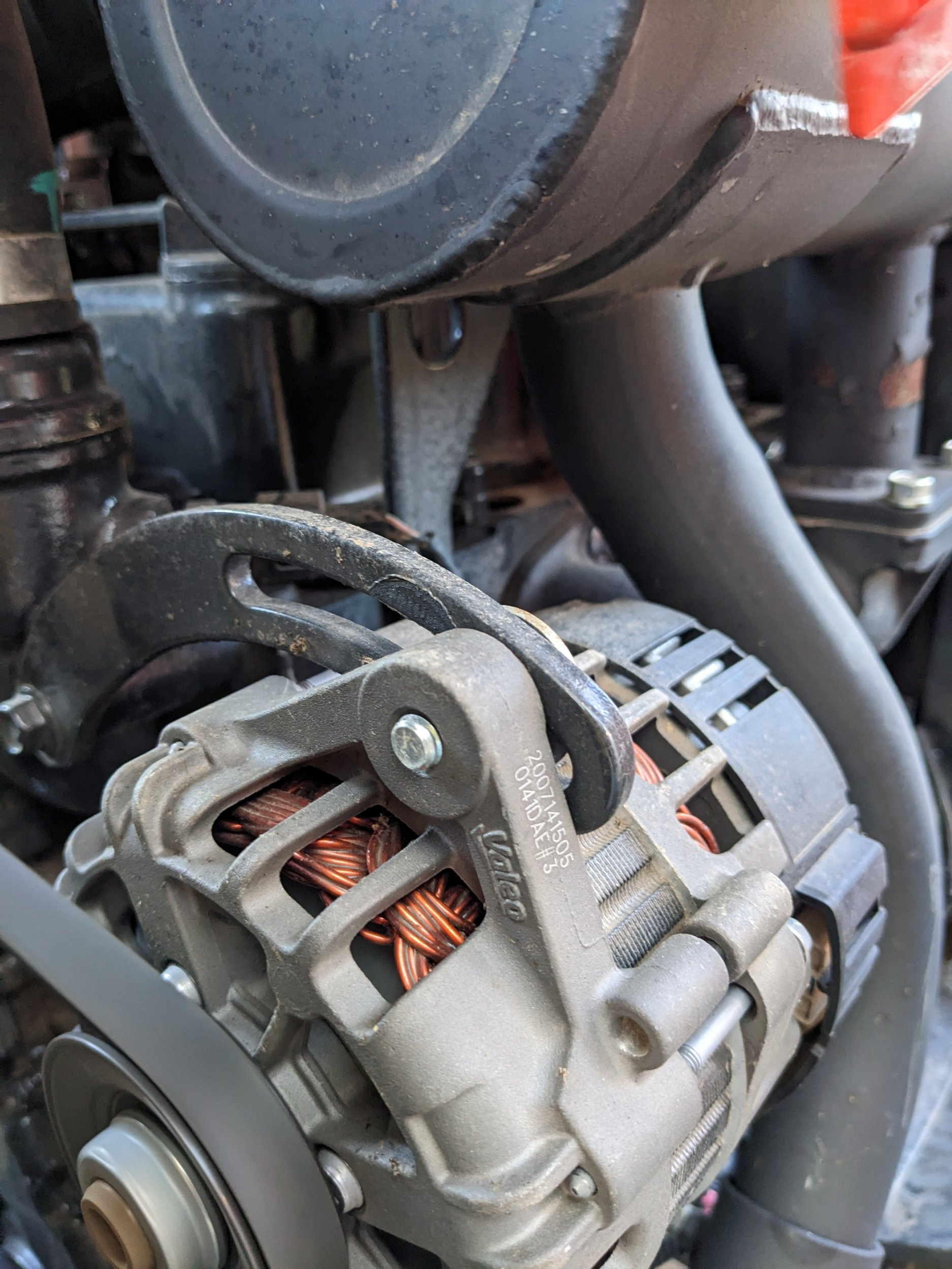

I came in here today just to search up this exact issue before figuring out how to get my cx2510 out to my dealer. In my case it was the alternator belt being loose. I had to move the alternator a good inch to tighten up the belt and I'm now getting good RPM readings on the tach. So I guess that means the tach only reads voltage off the alternator? Is that how most diesel engines read RPM?
@Username Taken - maybe change the title of the thread to "Low RPM shown on tach" or something to that effect so others might find this issue easier. Post up if this ends up being your issue too.
Voltage before tightening...
Voltage after tightening...
