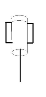

I've hammered down many wells over the years. If your conditions are right, they will work great. Had one for our house water, was only down 17 feet. Plenty of water to run two showers at the same time with w 1.5hp pump.
Get a well pounder from a rental place and beat it down in an afternoon. They look like this.

Does this make sense?
My property line is in the middle of the creek, so I can't **** it up. I can drill a well beside the creek and hit water at 4 feet. If I go deeper, should I have a better flow rate?
Could I put a tip on a piece of two inch galvanized pipe, drill dozens of holes in the side of it, and push it into the ground with my backhoe? When the pipe was down to the ground, I could thread on another lenghth of pipe and push it down further.
The 2 inch pipe would be a sleeve for a one inch PVC pipe I would slide inside to pump with.

No, It doesn't make sense, why go to all that work. Buy a 3 or 4 foot "SAND POINT" from your plumbing supplier, and pound it down with a well pounder (See previously attached picture). If you have water at 4 feet below the surface, pound it down 8-10' and put a head valve on the top with a pump and let 'er rip.
Driven Well (Sand Point)
