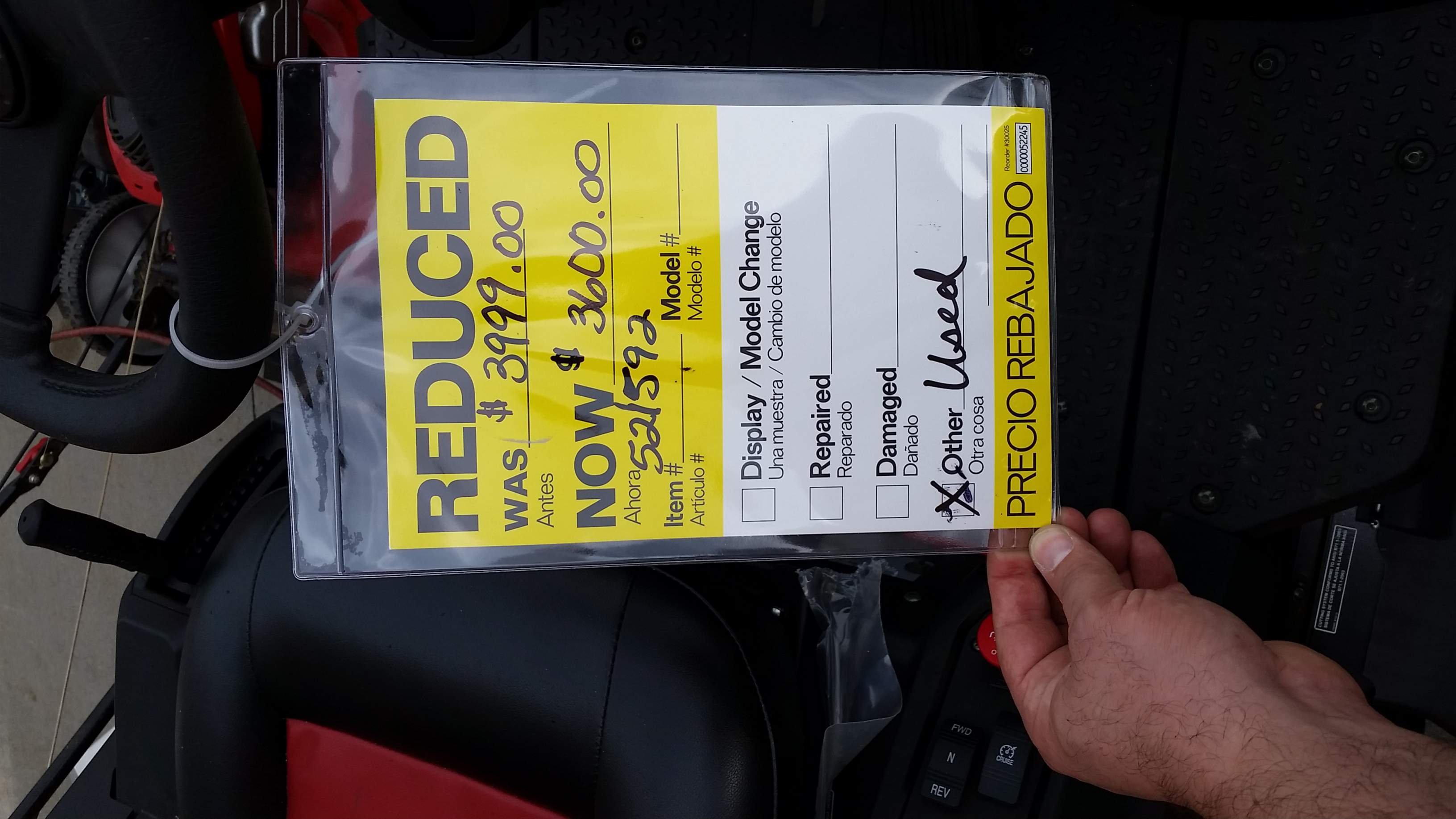

A returned Raven was sitting outside my Lowe's today.
   / Anybody got one of these yet? Raven mower. #150
Hey a 10% discount to boot. :)
