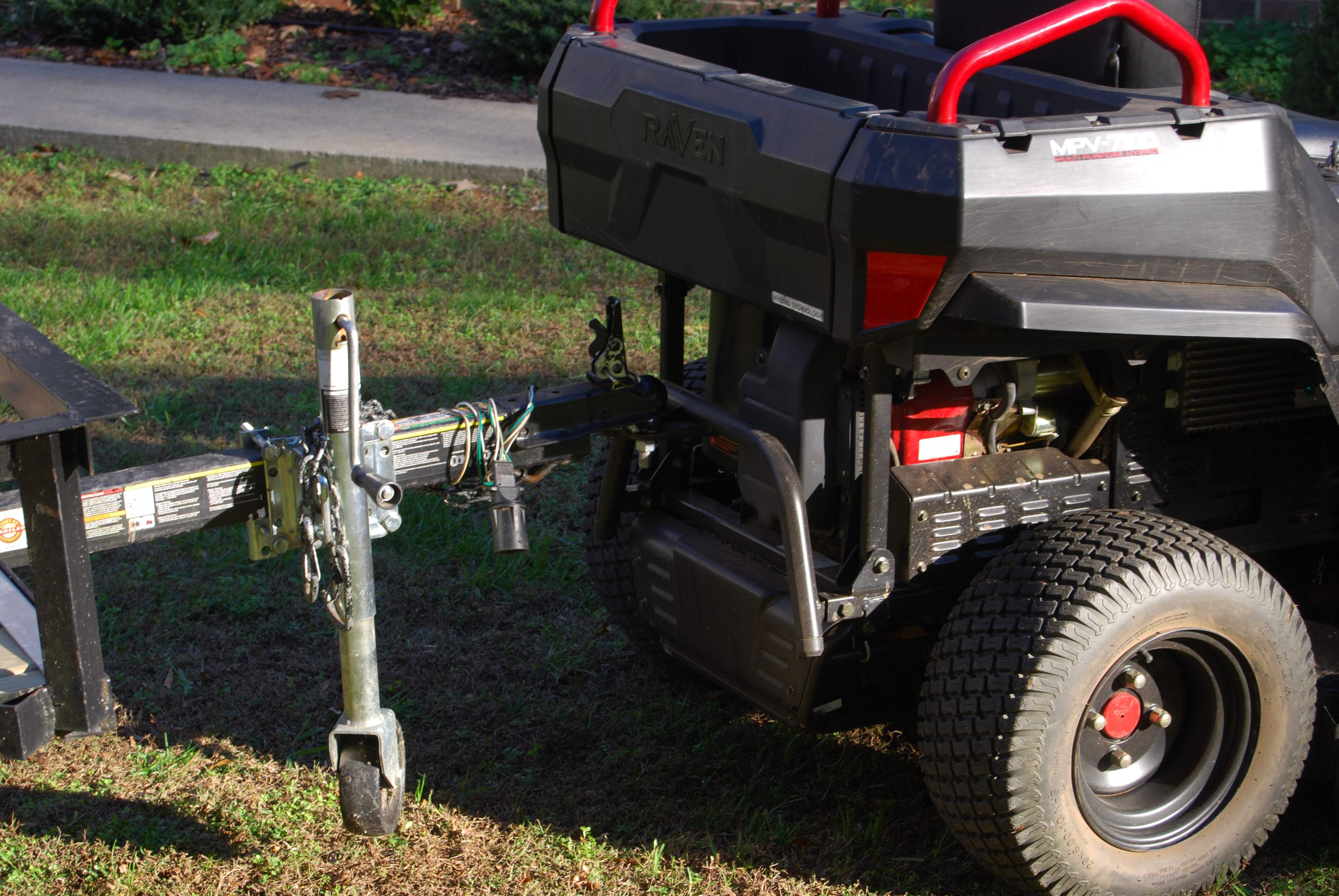

DSC_0792.jpgDSC_0794.jpgI bought mine from Lowes. It was their demo. After a discounted demo price, plus 10 % off and 5% for using my Lowes card, I paid just over $3k for it. I have owned it now for just about 5 months and absolutely love it! Someone had their thinking cap on when they created this machine for sure. It does everything as advertised. I even tested the generator out on my 31ft travel trailer. It powered my travel trailer, with the A/C running, no problem. Once after mowing the lawn, I drove it over where I had a bunch of scrap lumber laying in the yard, and used it to power my chop saw and no issues. The main thing that tipped me into pulling the trigger on this machine was the 3 year warranty. I figure if the company feels they can stand behind it for 3 years, they must feel like it will hold up.
I've seen some complaints about a bumpy back aching ride. Well, it doesnt ride like a cadilac, but rides smoother than a standard riding mower. It has shocks on the front. But if you run over a hole with the pedal to the floor, yes, your back will feel it. What took some getting used to is the electrically powered system can be somewhat jerky, though, if you have a large area that you dont need to adjust your speed, you can just enable the cruise control.
My uses:
Mowing( Due to the mower being powered by the electric motors, the engine doesnt bog down. The blades turn faster than a standard riding mower.
Towing things around in the back yard(to move out of the way) my jet skis, utility trailer, log splitter. I put a standard 1 7/8 ball on the hitch plate.
Taking camping and running around the camp ground in electric mode.
Power generation for whatever I want. (5 gallon gas tank will last a long time between fill ups)
And it has a fuel gauge!
Faster than most riding mowers.. Except for maybe the Dixie chopper
