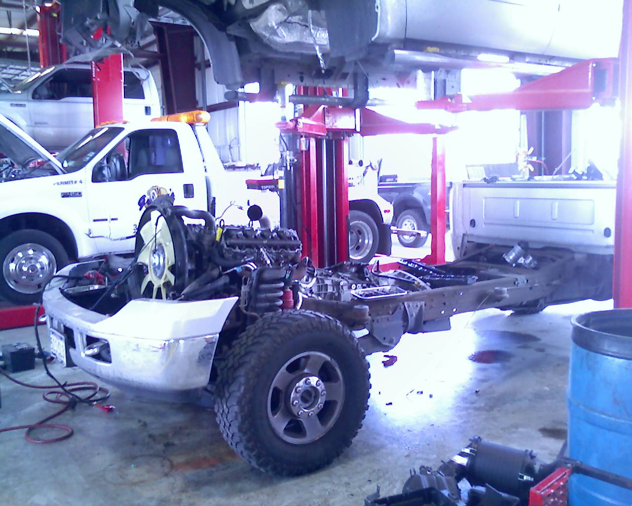

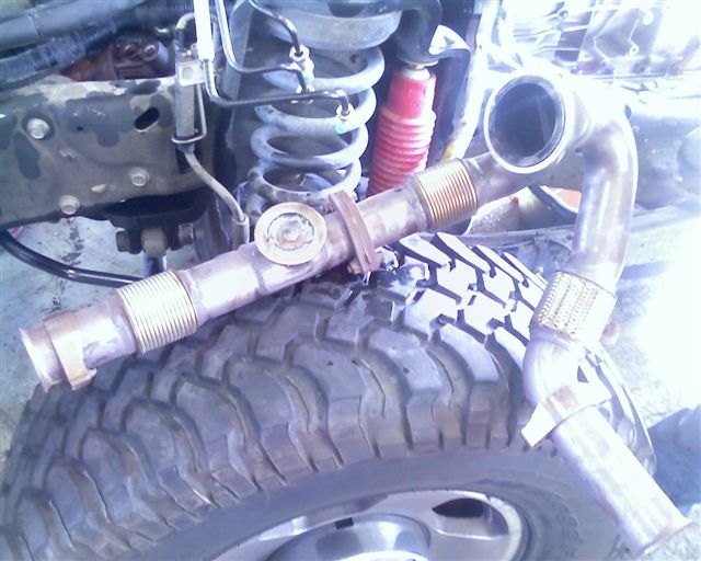

<---- ford powerstroke diesel tech here
I fix these things all day long everyday, and i can tell you, if you block off the egr cooler and disable the egr valve, most the problems with the 6.0 liter are gone..

Sound's like your the man to ask...
How's would one go about deleting the EGR system on a 6.0 if one wanted to? Not that anyone would mind you because it wouldn't be legal for smog... ;)

its as easy as unplugging it, or they also sell a billet plug that takes the place of the egr valve
