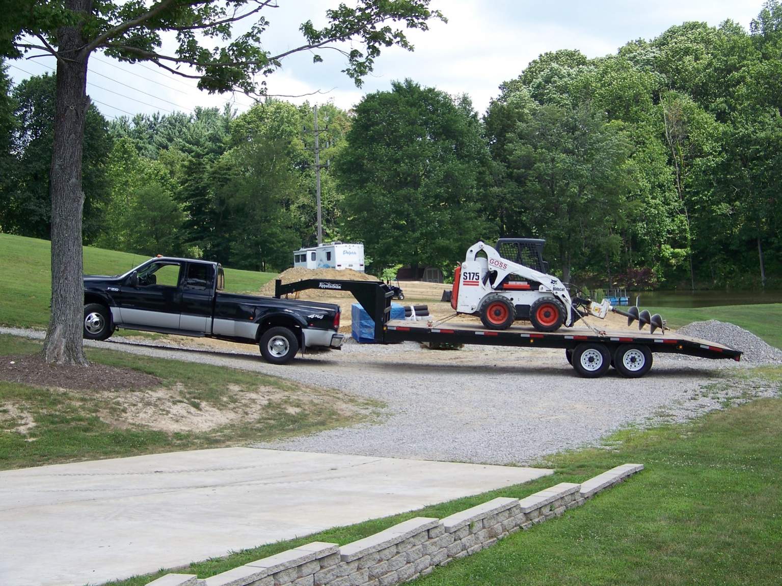

Yesterday just may have been poor luck with the truck I really liked....it's the one that left my boy and I stuck on the side of the interstate. I still really like the truck and has less than half the mileage than my current truck. I called the dealer this morning and they are going to send it to a reputable diesel shop today.
Now I mentioned earlier that I was going to just keep the 03 7.3 and fix the leaks and get tires. I also said that it was payment free. Well I was thinking of something else....I still owe another 2.5 years at $190/mo. After talking to the wife about it last night, she suggested not putting any more money into the truck we have now and get the 04 6.0 only if the dealer can warranty what the heck is wrong with it. Although I like the F250 that broke down and the dealer is going to fix it, do we really need an increased payment (ends up being $325-$350/mo. for 5 more years)? AHHHHHH!!! Oh what to do? I'm stressing too much over this.
First pic is the current truck....03 F350 7.3 177,000 miles, paid off first half of 0012, $190/mo. Needs ball joints, front axle seal is seeping on both sides, have an injector dropping out when its cold, and needs all 6 tires. I can fix all of that. Otherwise in great shape and pulls outstanding. The room inside is tight but we always take the Suburban when we go together (1 child but working on more!). It is an XLT already has the gooseneck hitch.
Second pic is the one that I'm looking at and its the 04 6.0 69,500 miles....more payment and more time till pay off. It broke down, who knows whats wrong with it, they are supposed to fix it as mentioned earlier. It is a Lariat and I will need to put the gooseneck hitch in it.
I know that after reading this that you guys think I'm nuts. Oh what to do?
I'm still thinking keep the 03 7.3L, pull her in the garage and get busy turning wrenches. I just trying to think about long term results.
