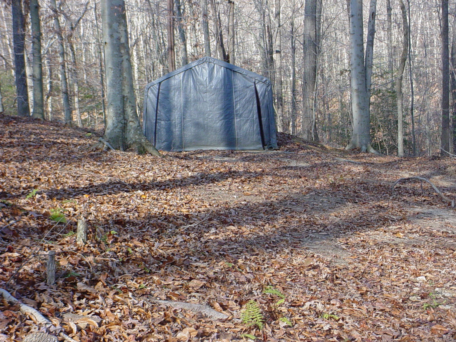

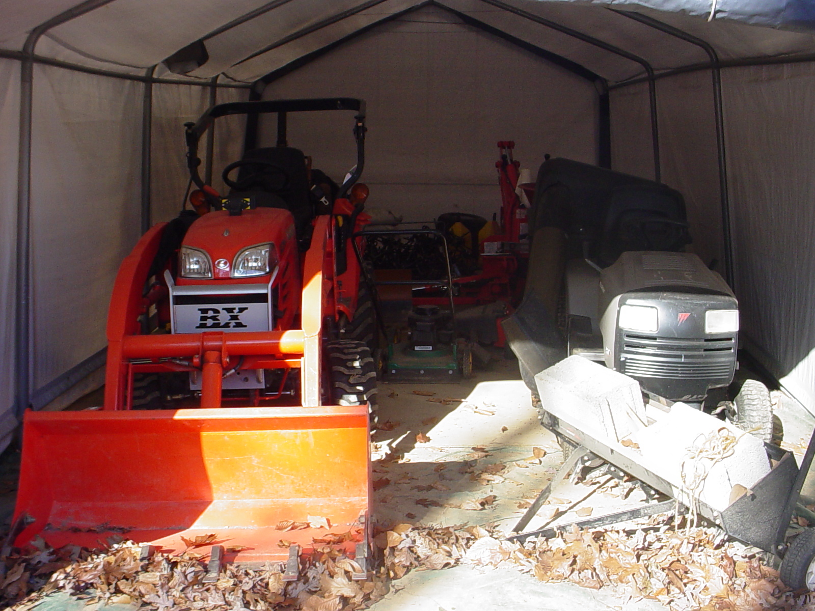

I've had mine, ShelterLogic 12x24 for over two years now. It has held up much better than I ever expected
The only place I have any wear is the bottom of the door flap from rubbing on the ground when blown by the wind

Thanks for that, NuBota - yours looks exactly like mine! :) I was looking at my door and will have to make sure the bottom edge doesn't get frozen in the snow and ice. Actually, once the ground freezes, mine will not move - when I was putting in the corner stakes, I dug down in my gravel driveway and found standing water down about 6", so the stakes will freeze right in place when it gets cold enough!

I had planned to follow this example, but since mine is in a low spot on my property and deep in the woods, the wind and snow (what little we do get) hasn't been much of a factor.
The only thing extra I did was add screws where the posts connected together. I was going to add foam pipe insulation where the posts contact the cover, but never bothered. There are a couple of spots where the vinyl looks stressed.

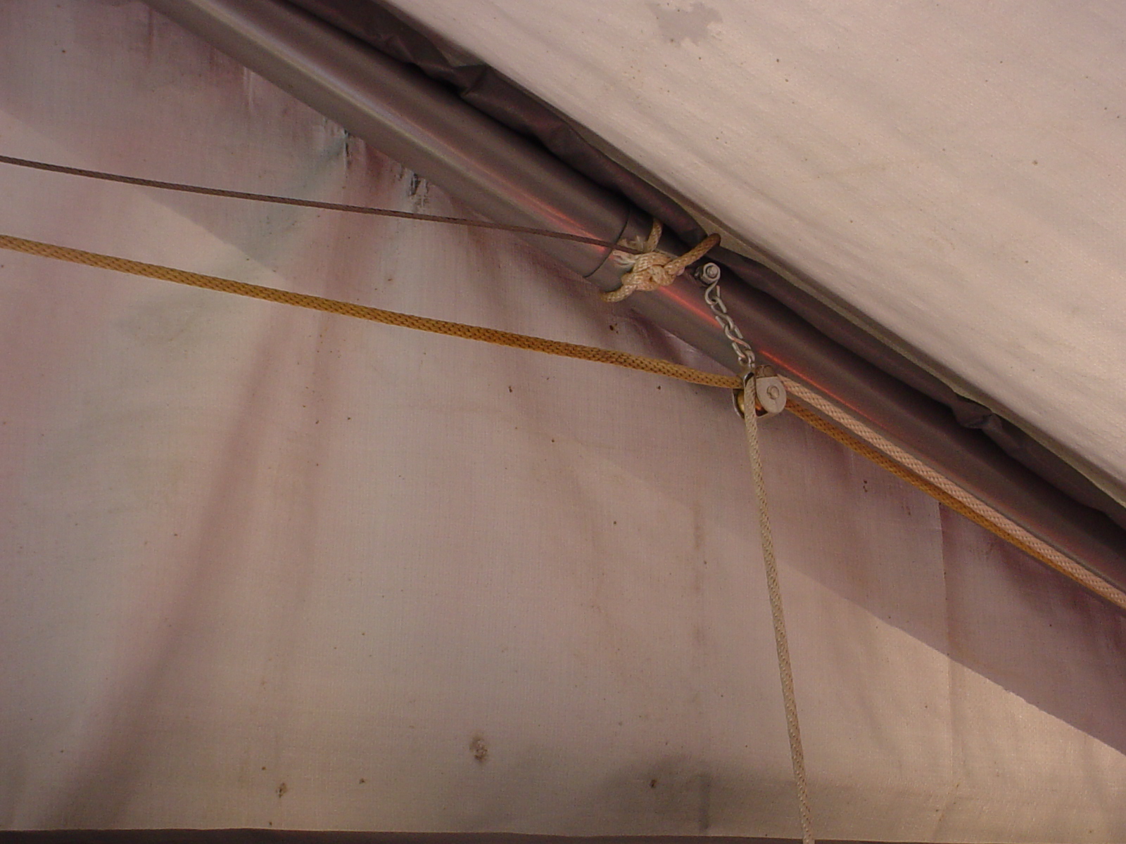

Also, for handling the door flap when opened. ShelterLogic wanted $40 for their "system". I just copied it for about 8 bucks at the HW store....
Two pulleys (1 single, 1 double), 4 S-hooks and clothesline cord
Finally, as far as portability - at one point I wanted to re-grade and add some fill to the "floor" - four of us, one at each corner, just lifted and moved the whole thing out of the way. With the screws I added to the connections, it was very sturdy and didn't shift at all

Hey, thanks for that :) - no such thing as too much information. I was looking at how to get the door flap to roll up, so that's good info. So far I've just been driving in and out with the zippers undone and letting the flap ease up over the car. We've had some very strong winds here today and it hasn;t budged, so I think I'm good for the winter:D. But I will look into putting together that door roll-up idea of yours!
