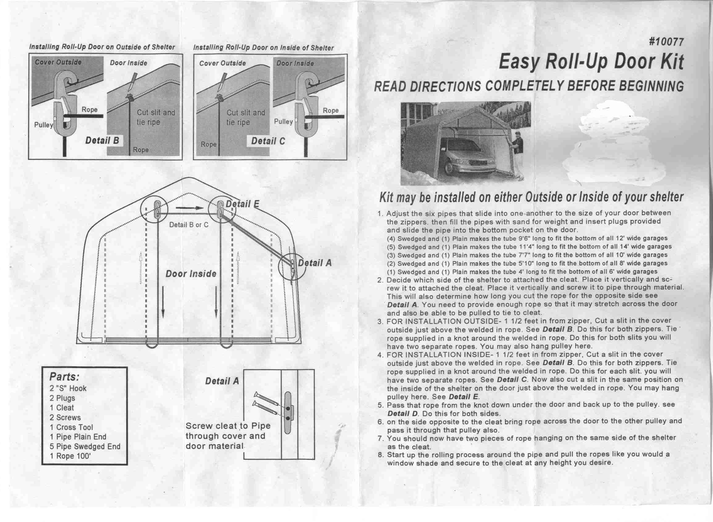

Here are the instructions for the door kit from ShelterLogic - I just copied the design. But my design didn't require making the slits in the cover (that just really bugged me), was much cheaper, and I think sturdier (no plastic parts)
