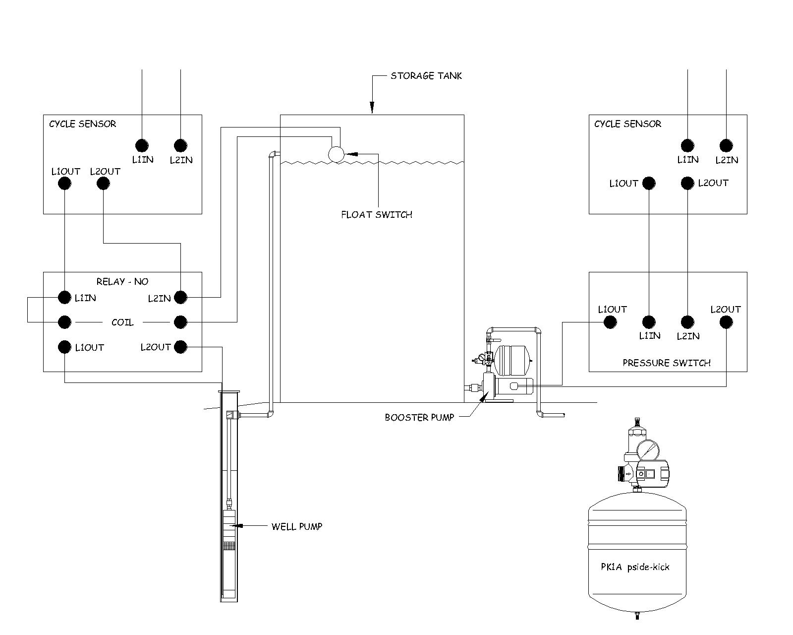

A cistern is a great way to have water during power outages. My cistern is a 2500 gallon spun poly tank, which I installed just because the well flow is very low during the summer. I placed it so the bottom of the cistern is about 6' above the floor of the house, and the cistern is 8' tall, so with no power at all I have 12' to 14' of head. That's enough water to refill the toilet when you flush, or get a glass of water at the sink. If we want a shower we have to fire off the generator to heat water and run the booster pump, but an hour or two of electricity a day is plenty, even under horrible conditions.
Wow Larry, that's the ticket!! A cistern. My house shop, is downhill from my well plenty enough for gravity to work when power is out! Plus it'll be cheaper! That's what I'll do, a cistern. We mainly need it for baffroo, toilet. Washing hands, brush teeth, hygiene when power is out, etc.

A cistern is the best way to have some water WSHTF.

Valveman, whew, don't think I want something that complicated for just a cistern. I just need a bit of flushing and hand washing water when power is off, that's all. Maybe 10 gallons a day at the most. Power has never been off for longer than 6 days, so a 250 gallon or less cistern would do us.
