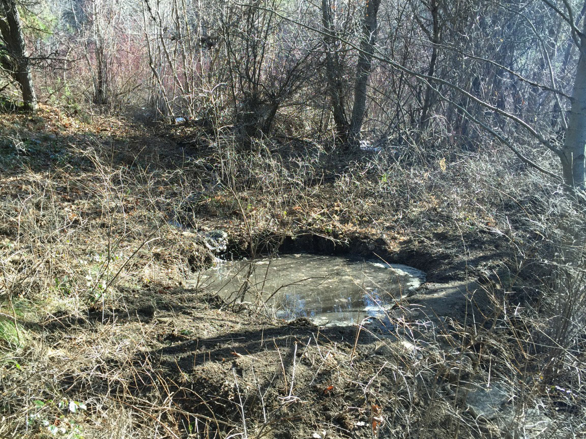

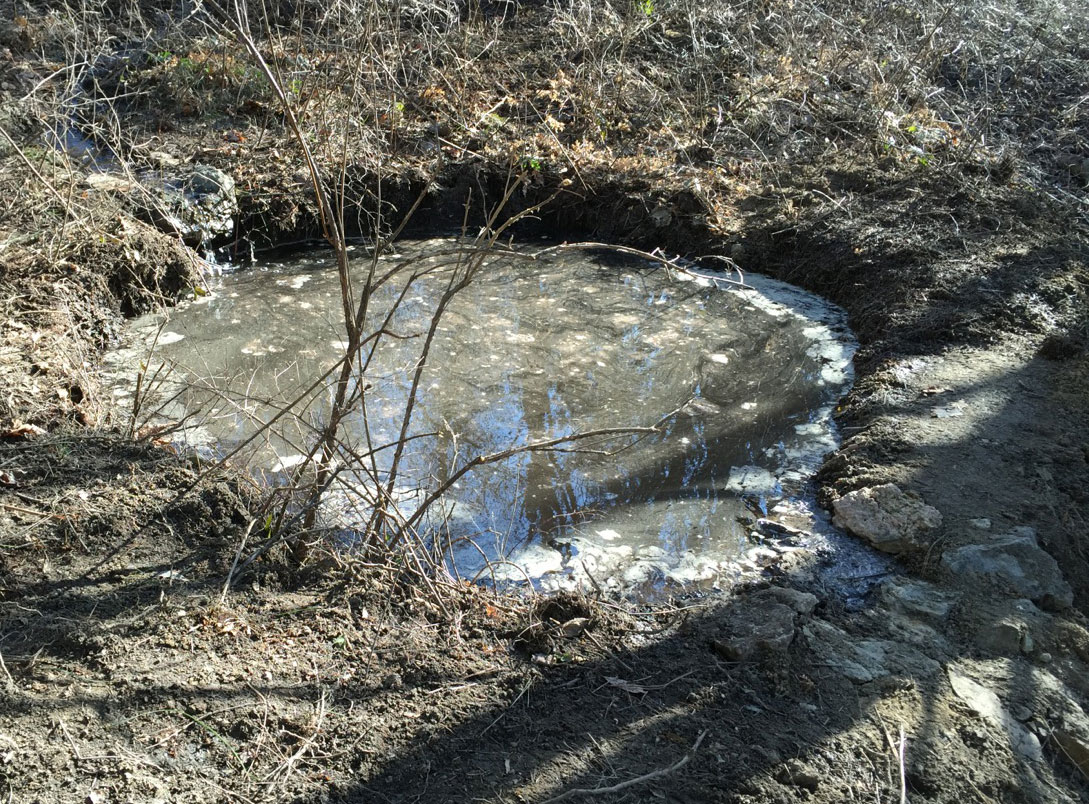

Hmm,,,,,It's just starting to clear up, do you think the bentonite will make it look unnatural? Maybe I'd just better wait and see if it plugs itself.
Here's a couple pics. You can see how it's wetted the spillway but doesn't spill.
attachment.php
attachment.php
I think this will look nice when it greens up in a couple months.
