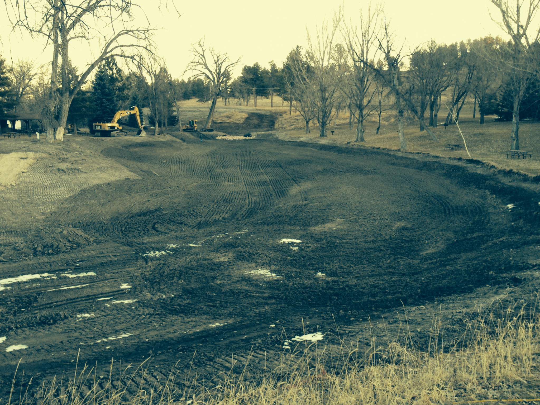

Ya know? That would have been a good suggestion but I was in soup mode at the time thinking what I had to do was make a slurry. Also I didn't want to disturb or liquify my dike, it was only hours old. Can't really see what the bucket is doing in a slurry and I ain't that good.

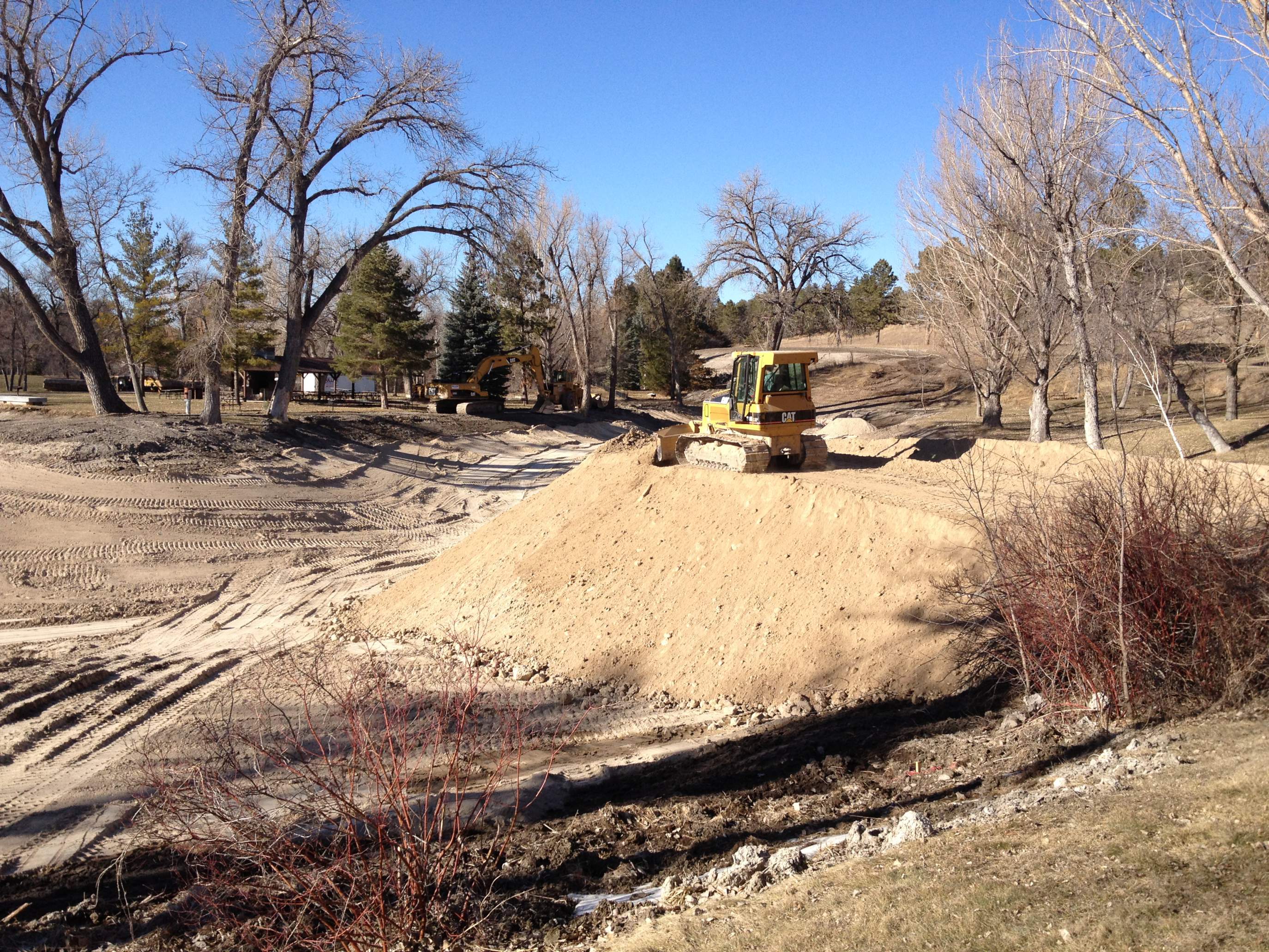

if you can get some clay soil ,blue clay is the best, dig it bigger and deeper and line it with a foot or so of the clay soil, that it how bigger ponds are built

The "3 weeks later" report.
It appears that the pond has sealed & saturated itself, as best as I can tell. I didn't do anything to seal it other than churn it into soup with the excavator bucket (twice). The little waterfall flowing out looks about the same as the waterfall flowing in. I'll take some pics in the springtime when things green up.

Pond still doing fine with no added sealer. Creek water in - creek water out (as best as I can tell.) But it's just a little pond 7 or 8 feet across, 2 feet deep. The reason I worried about it is because my creek disappears into the ground in several places, then re-appears later.
Possibly I have clay in my soil, when it rains and you walk on it you get about an inch taller, and a vehicle cannot even move if driving on it.
