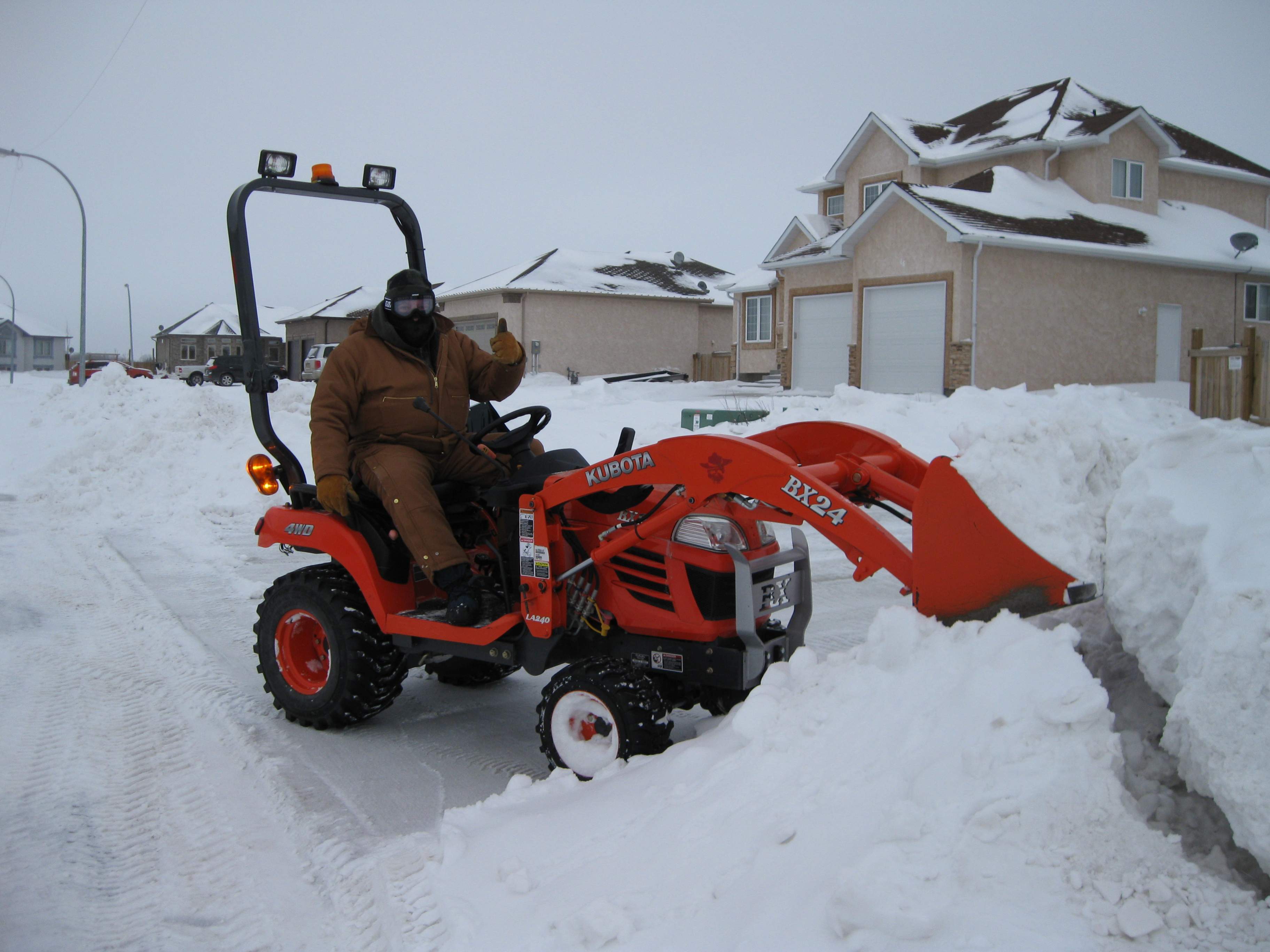

Been clearing snow for the last 3 winters with my BX24 around town here.
Before my first winter with the machine, I bought a set of R4's with rims for winter use only. My summer turfs were put away. I need them for the type of work I do around town. My rears are loaded R4's, and I run in 4 wheel drive with no issues.
Last winter we had 2 weeks of ice rain before Christmas making it a real mess, with about 1-2inches of ice. It was a little slippery, but I ran in low range and never had a problem.
This winter we've had a bit more snow, but no ice. Chains look like a good idea but would doubtless chew up my shop floor.
Frankly, I think if you know your machine, figure out the terrain/conditions your working in, you can figure out the best compromise for the job at hand, because that's all it is, a compromise.
My biggest concern is being seen by the cage drivers at night...so I put a strobe and aux. lights on the ROPS. Looks like it's supposed to go up to +1C/34F tomorrow, then 4-5inches of snow on Thursday....Great...more work...:thumbsup::):laughing:
