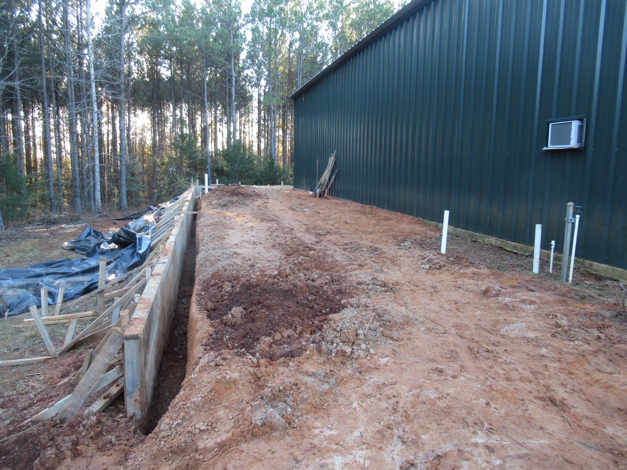

Here's a picture of what the concrete contractor is doing at my place. The forms are not completed yet, but he put up the outside forms, filled in behind them with dirt (see note below), then dug the dirt back out for the wall thickness. It will be a single piece of concrete forming the footer, wall and patio.
The note: The "dirt" is what is called "select fill" around here. It is a mixture of sand and clay, it compacts well, is easy to dig, and keeps it's shape well. It's used for all the foundation slabs around here.
Yes! That is exactly what my project will look like.. one major difference is the climate. We freeze hard here, and cannot use clay as backfill as it will push the wall out.
