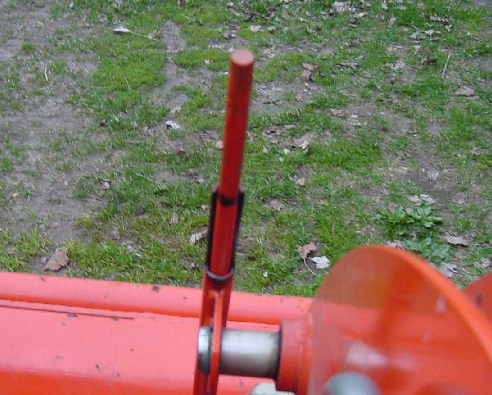

Here is a photo of the rod mod on my L3430. I got the idea from TBN this spring, I can't remember who posted it, but they get the credit for a great idea!
The rod is even with the top of the holder when the bucket is level. The slot allows you to see when it is close.

</font><font color="blue" class="small">( On my FEL when the bucket is level the rod is flush with the top of the tube. )</font>
When I got mine it stuck way out so I cut it off flush with the end of the tube when the bucket is level. I have no idea why Kubota didn't come up with a better indicator. /forums/images/graemlins/confused.gif

Brent -- Thanks! That was the best explanation yet on how to determine where to cut.
I did as you suggested, but cut the bar at a slight angle and put a dollop of yellow paint on the cut end to make it more visible. Now if I can just keep it free of snow so I can see the darned thing!
