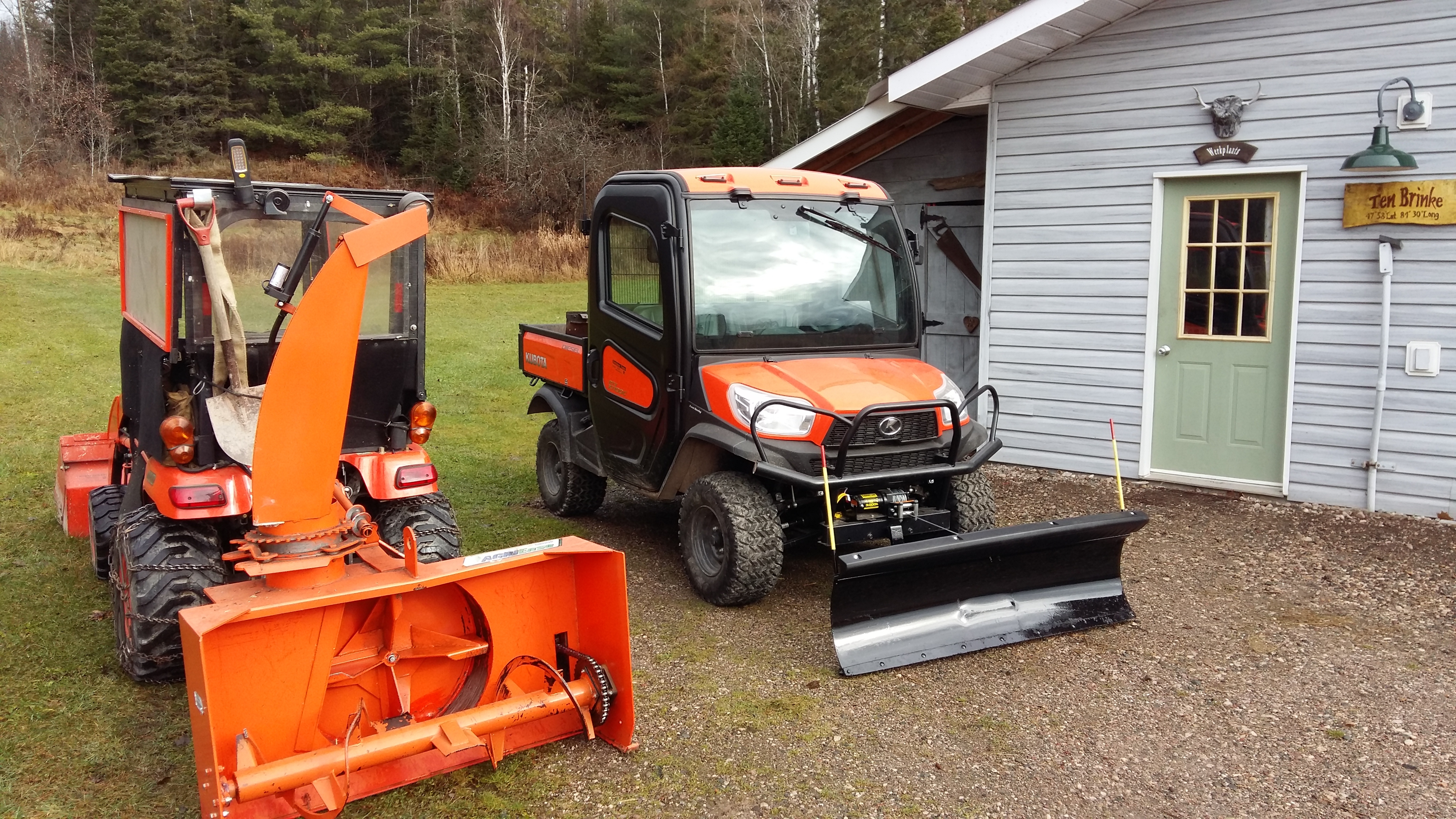

My original comment is in this thread , so now I have been using my rear blower for 8 years, works fantastic, 2 foot deep sections many a time [ 300 ft of driveway) I leave the front bucket on so plenty of weight and front and then I can backblade. Four wheel drive always engaged. 20171125_113910.jpg
