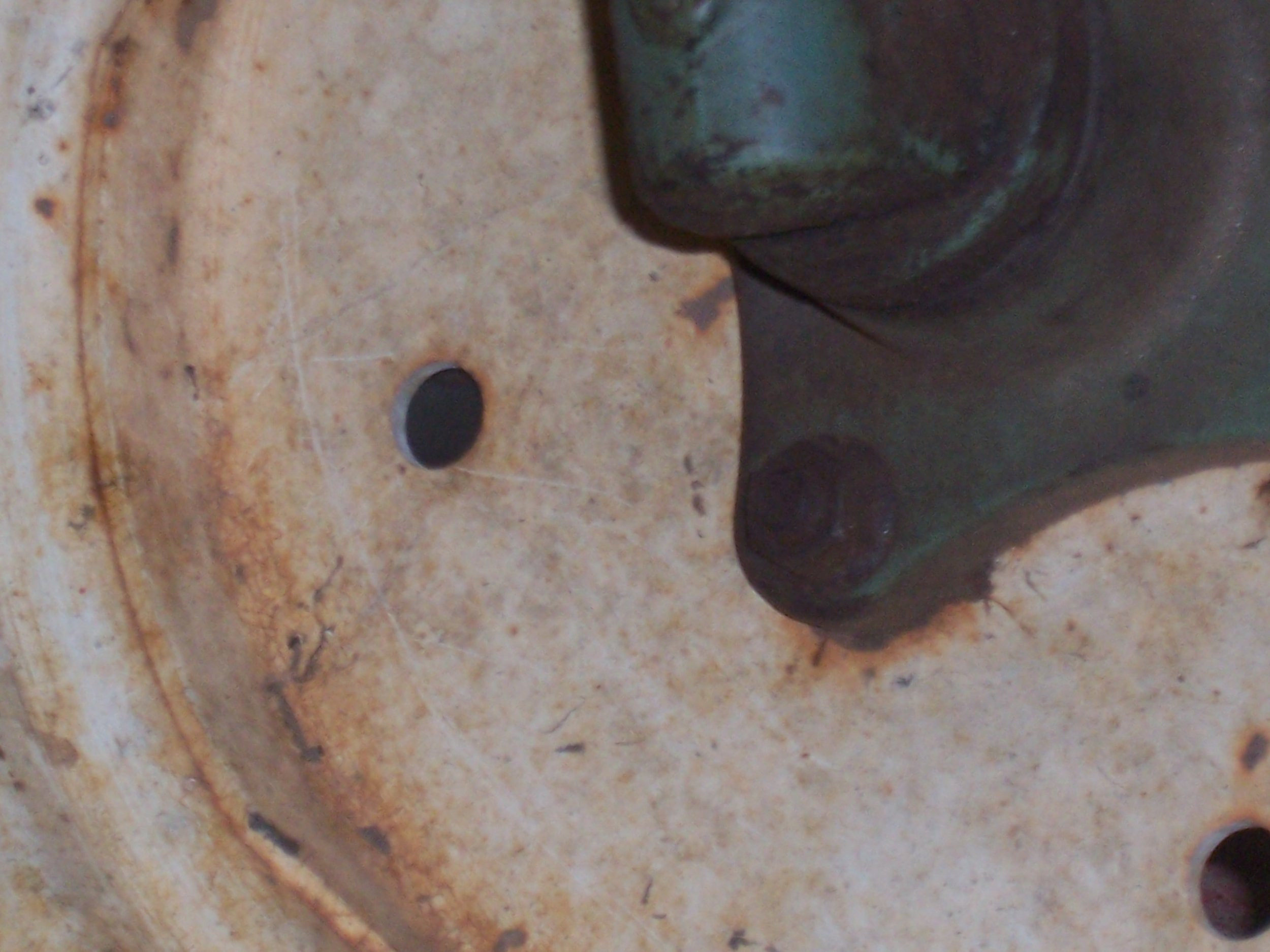

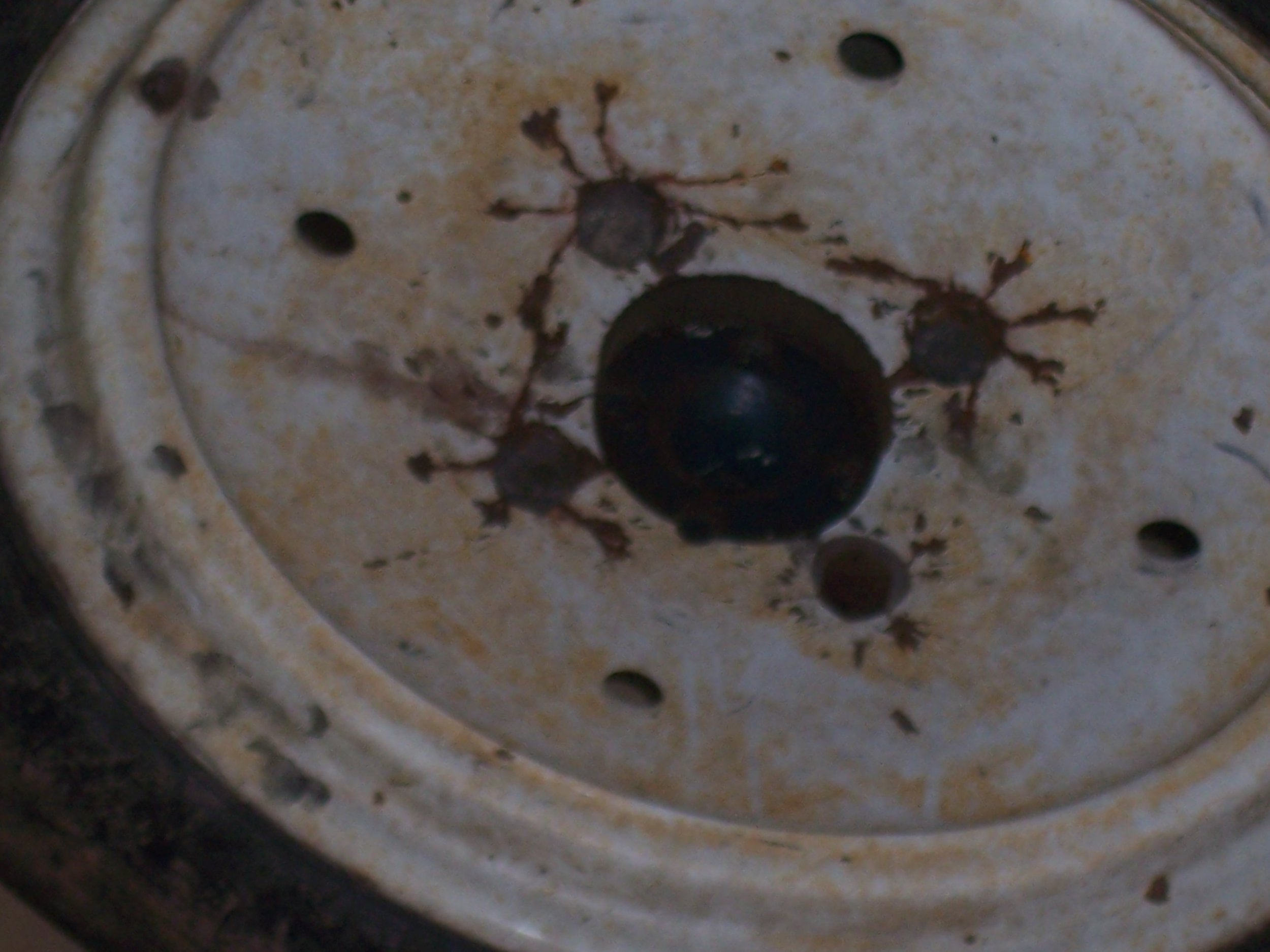

Repainted them in 2009. Fredricks paint that and fix a flat. Valve stem leak which fixed that. I lost 2 Lug Bolts over the Yrs.. Just a Standard size bolt with a lock nut took care of that. Wheel Bearing just last Yr.. 1 disintegrated.

The picture of the wheel with the cracks looks almost identical to my wheel. The cracks on my wheel are fewer and slightly shorter. So I'll watch 'em and if they grow they'll get welded. Maybe I'll avoid the rush and weld them before they grow.
Eric

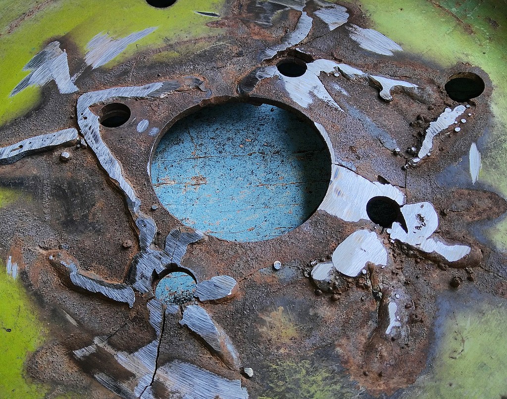

I posted these here in 2009 but the photos are from earlier. The $20 wheel on the left is still in use with no additional cracks.
(I have a second like-new wheel to replace it when needed).
ym-oldfrontwheelsdetail-jpg.142294
This YM240 was apparently neglected after its first decade and parked with little use for several years, before I bought it in 2003. I spent a month fixing minor stuff such as replacing the warning lights panel before putting it in service.
It has been reliable ever since but it hasn't gotten any prettier. Well I was better looking 40 years ago too. :p
   / Anybody seen cracked front wheels? #17
Found a better photo! (Expand it to see the additional cracks).
This is the inner side of the wheel shown above. Before the welds were ground down, no wonder the wheel didn't rotate true.
I ground it reasonably flat to mount a column, to make a grinder pedestal.
20170224rcrackedwheelgroundflat-jpg.604241
But then I decided to use it for a portable welding table instead.
img-20201129-wa0001rweldingtable-jpg.734941
