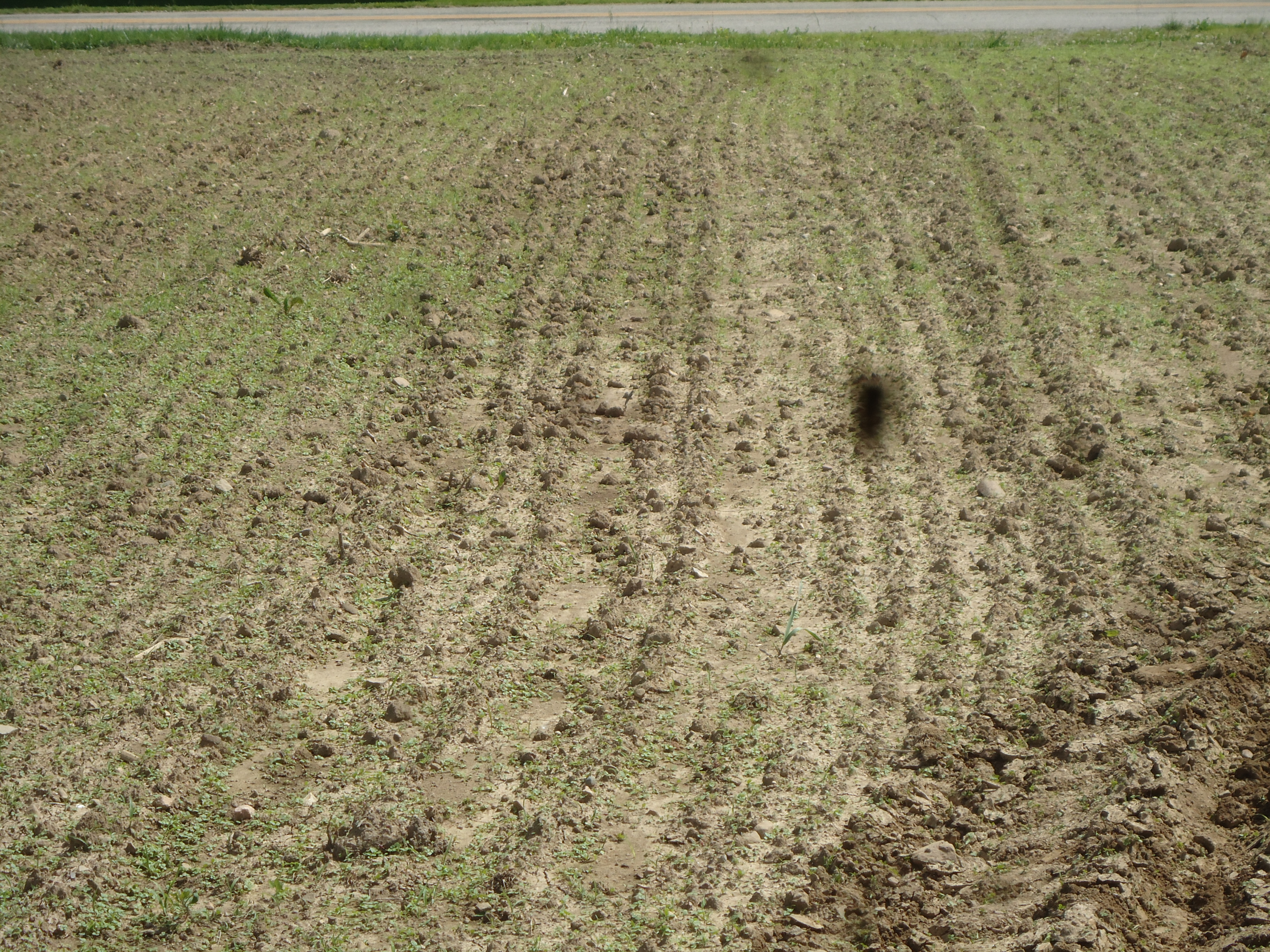

Instead of a 3 pt. disk, you may want to consider a pull type. It will give you a better finish. I pull mine, with either my Farmall A, or the Super C. pictured below. This is a prime example of what I mentioned above, of killing/reducing weeds/weeds in the top seed bank. This was 2 years ago, and I disked it when it was a lot damper than I like to, and not the finish I like to see. They were calling for a couple inches of rain over the next 2-3 days, and it was dry enough to get in, and disk it up. With the hot sun, and wind that day, I probably got an 80% kill on those weeds.
If you have any Spring consignment auctions in your area, that could be a good place to find one. Craigslist, or FaceBook Marketplace is also another good source to find one. I've seen many listed for around $100.00. This one has adjusting levers to set the amount of cut. I set it to full cut for the initial pass to work it down, then set it to a medium cut to plant in. Some years when I put a cover crop on, I'll use my tractor mounted Cyclone seeder to spread the cover crop seed, then go over it with the disk, set on a light cut to cover the seed, and the home made cultipacker Dad built back in the mid 60's firms the surface up.

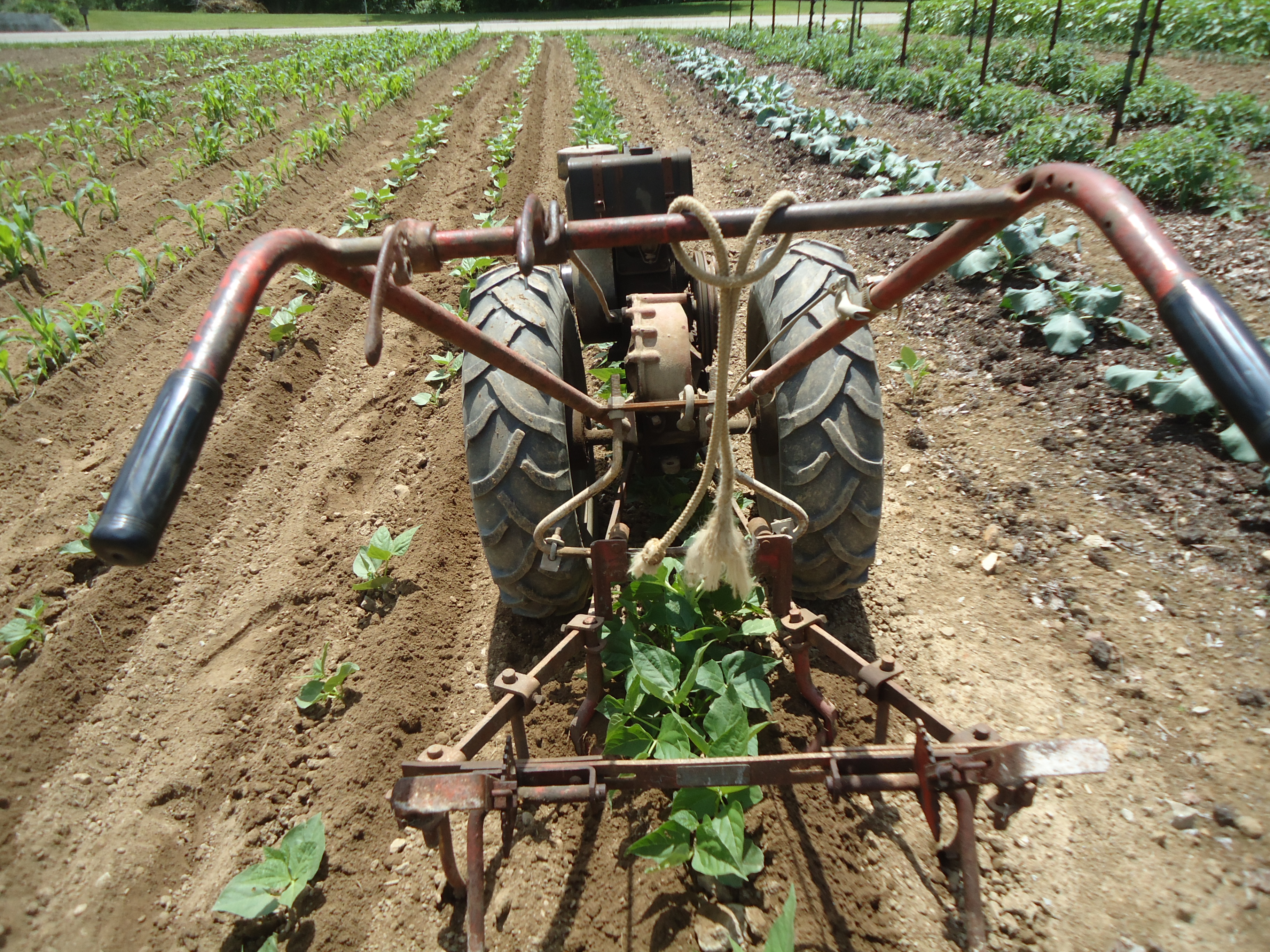

I know you're question was about disking, or tilling, but thought I'd add the last picture, for how I battle weeds. I have 5 similar tractors like the one pictured, with various setups of cultivators, for various stages of plant growth. This is a David Bradley, and the largest in hp I have. It is a 5 hp one, but others have mostly 3 hp engines. I have the hilling shovels on it, to hill up around the corn and beans. This particular year was dry, so I set the hiller's to leave that "V", to hold any rainwater, that we were to receive. It worked well that year, as it stayed pretty dry the rest of the summer.
Again, I have no idea what your plans are for weed suppression, but no matter what you use, I'd suggest to NOT till/cultivate more than 2"-3" deep. All you'll be doing is bring more weed seed to the surface, to easily germinate, and to battle. Anything below that level will have a tough time coming up, but you can take out if they do come up, with a pass of cultivating/tilling. Leave the rest for Mother Nature to do her magic on them.
I don't know if you are a fan of FaceBook, but there are a number of Market Garden pages, and also some 2 wheel garden tractor pages, that many of these Market Gardener's use, to keep their crops clean. One particular fellow out in Washington state uses one (Planet Junior brand from the 40's) to cultivate his 5 acres. Many others are doing 1-2 acre plots like you will be doing. These small 2-wheel tractors will allow you to grow more produce on a smaller footprint, due to average row width of 30" or less, depending on what you plan to plant. Some are planting onions & such in 15" row width's with the Planet Juniors.
I prefer the David Bradley's for several reasons. #1. They can be bought pretty cheap at auctions. The last 4 I bought at auction, were $80-$100, and would run with some minor work. Carb. cleaning, new spark plug, etc. All had an attachment, or attachments with them. #2. Easy to re-power. A 3 hp Briggs, or Tecumseh engine will bolt right on, and you're good to go. I'm hearing the Harbor Freight engines bolt right on too. For the last 2 years, I've been buying what appear to be low hour lawn edger's, with the 3 hp engines, for $35 - $40 for replacement engines, for just in case. The Planet Juniors need to have a similar hp engine, but with a 6:1 reduction, and those can be costly. #3. Attachments can be less expensive. I bought one about a year ago, with 5 attachments, for $100. It was in decent original condition for it's age, but a non-runner. I set it off to the side in the shop for a winter project, and just last week got it running. I cleaned the carb., and spark plug, lubed up the throttle cable. After 4 pulls of the starter rope it was up and running. This is a 1952 model, with the original B&S model 8 engine. There were no signs of smoke from the exhaust, so this one will be used this summer in the garden. I'm thinking the hp rating is 2-1/2 hp, but plenty of power to pull a cultivator. I can cultivate my 1/4 acre garden, sometimes running through twice if the weeds got away from me, due to rain 2-3 times, on less than a gallon of gas. Here is a video clip shortly after I got it started. MAH00371 - YouTube

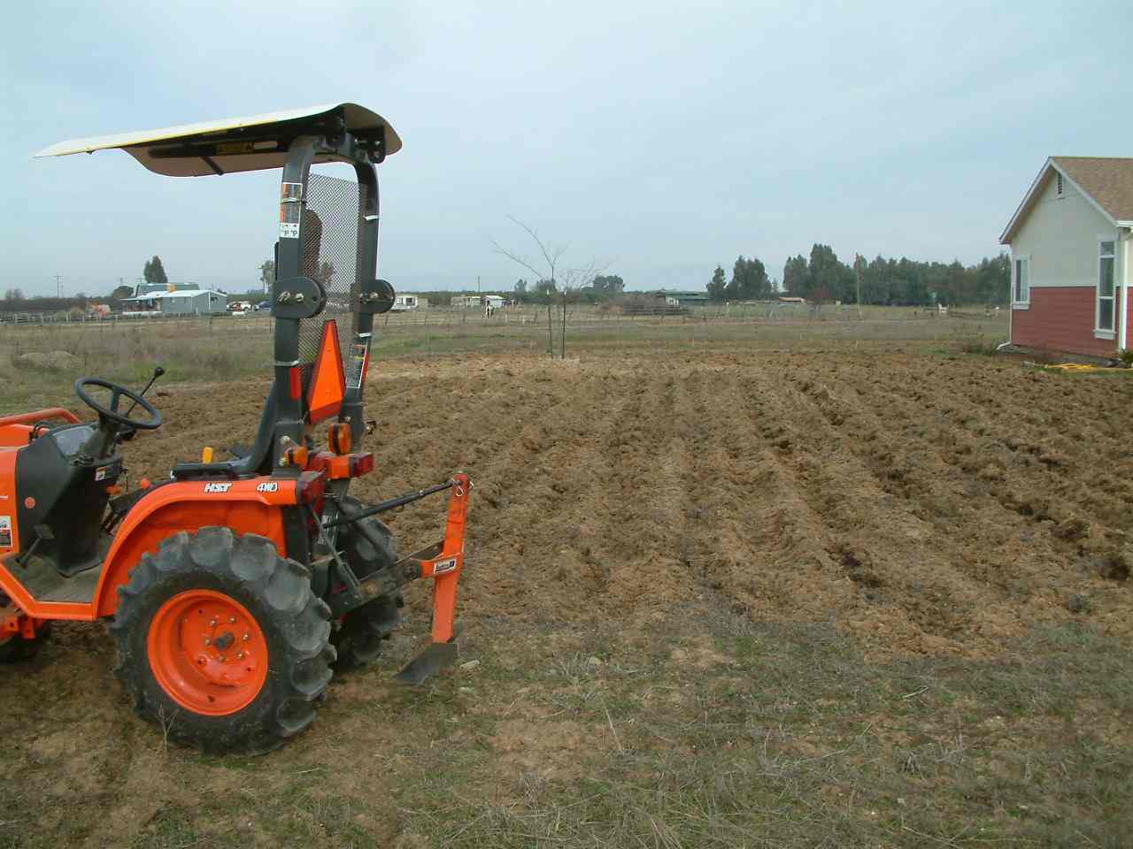

I'd use a middle buster to break up the compacted soil down to 6-8 inches. It will be slow going with that little 24 hp Boomer. But it's only 2 acres so you'll get the job done eventually.
Here's how I did soil prep for the landscaping around my new house in 2005. Used a Kubota B7510 HST with a $125 middle buster and the rototilled with a 48" wide Yanmar tiller $200.
