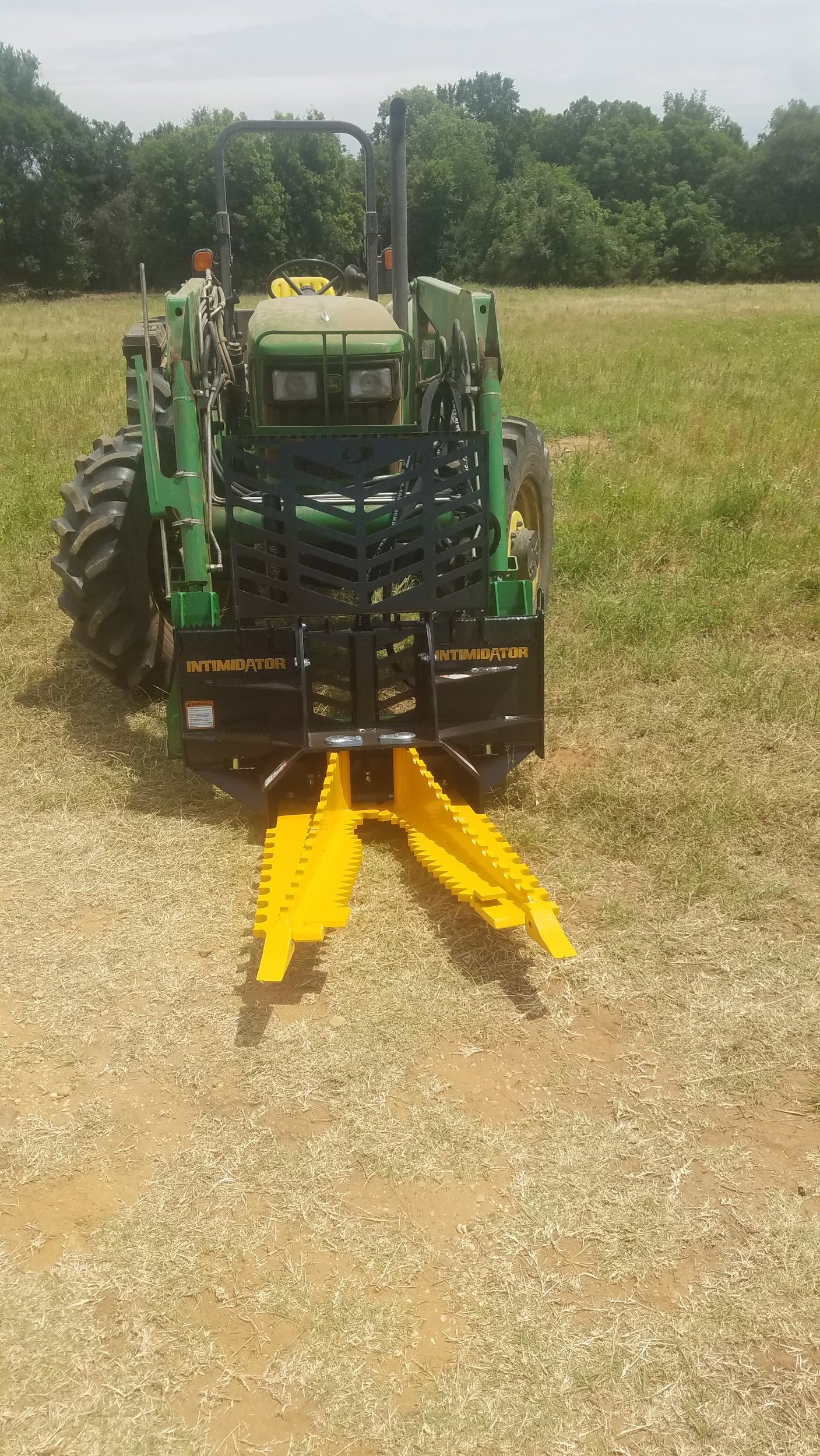

I have posted before and stick by it, the INTIMIDATOR is great! From small to big it will work, there is a little issue with the site over the hood (JD 5225) but it works as advertised. I have used it to dig roots on things that wouldn't just pull out. I have also used it with brush on a fence line, cut limbs off of the fence and then just pull out, no hassle. The group pictured below took less than 10 minutes to pull out and no damage to the fence. I like the idea of the 3 point hook up, Thanks for that!

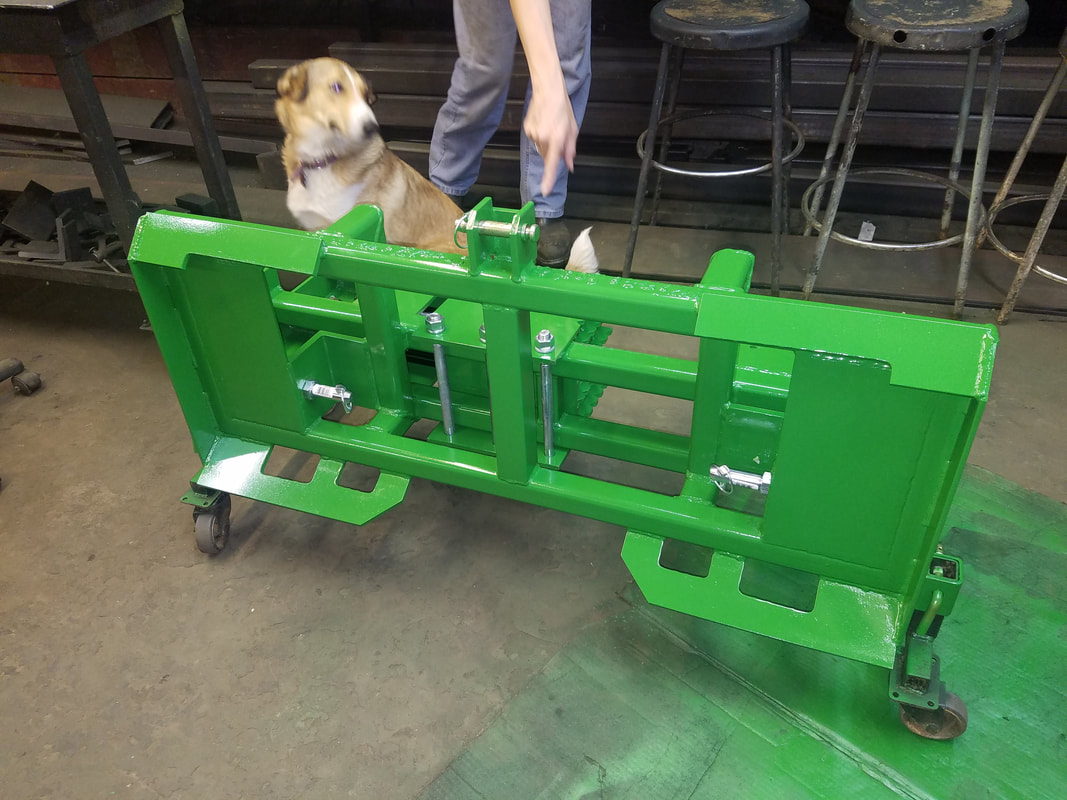

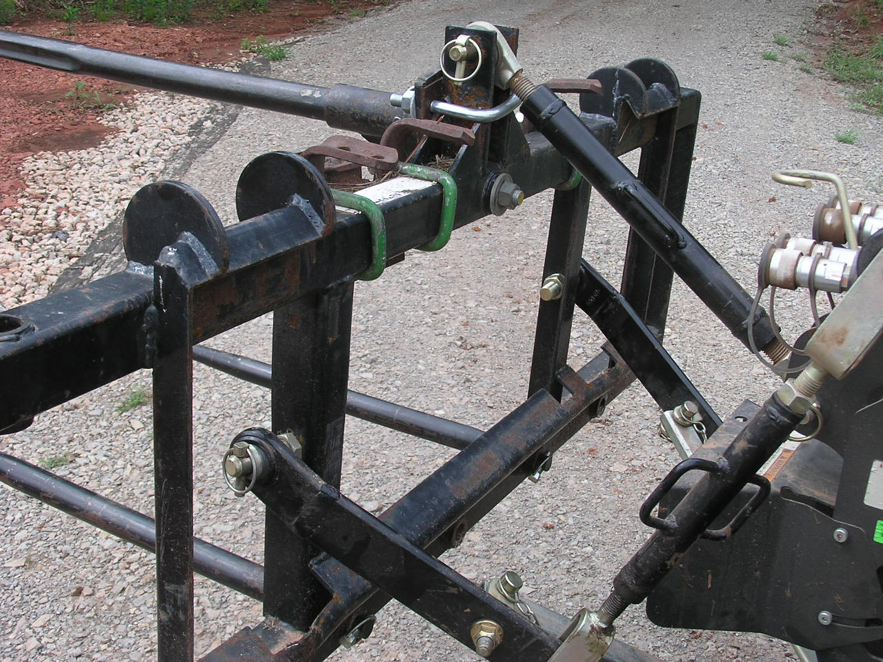

@ranger danger how is yours attached to the 3 point? i world like to replicate your setup
If you can weld you might be able to add the 3 point mounts, here is one for John Deere that fits front or rear: Buckthorn Puller
SSQA and 3 point:
And my Speeco UltraFork that fits both ends:

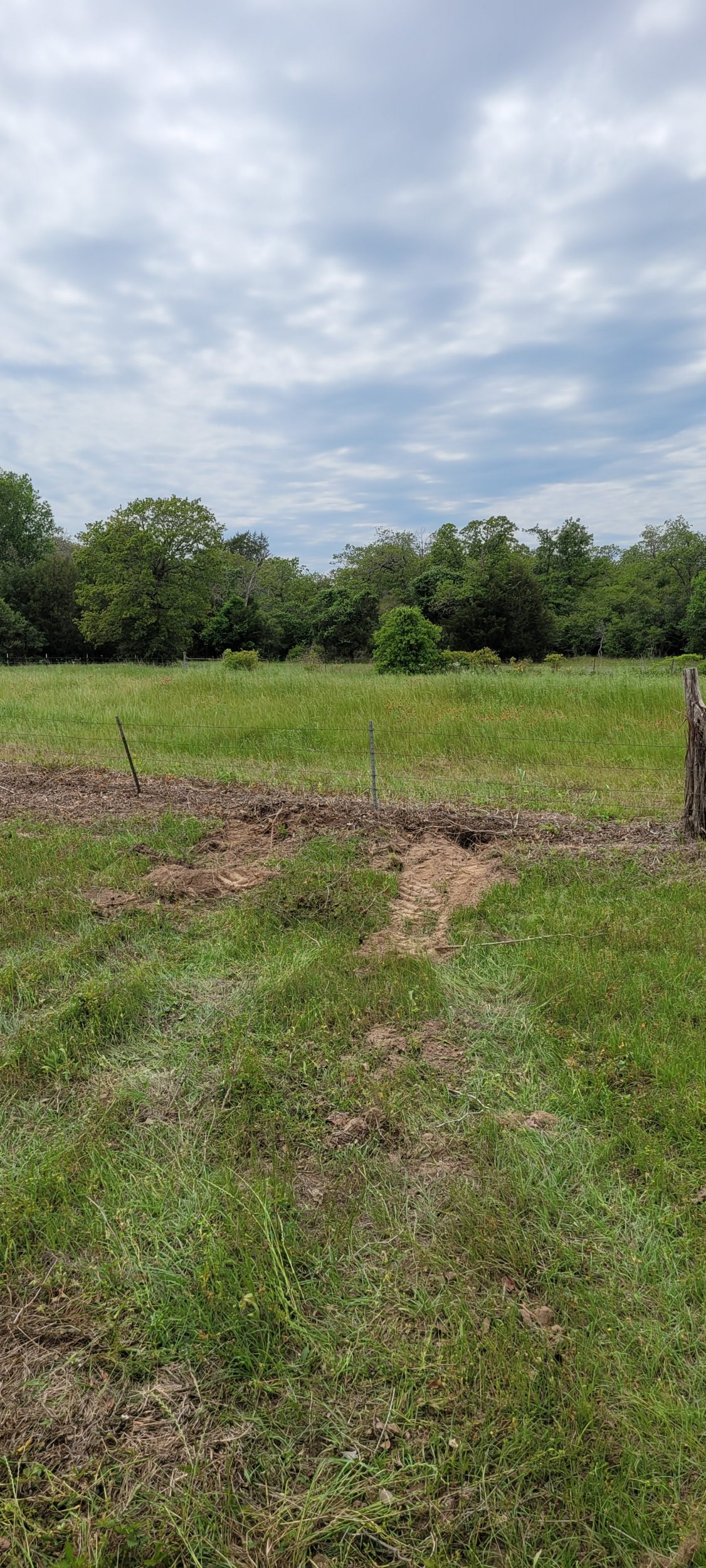

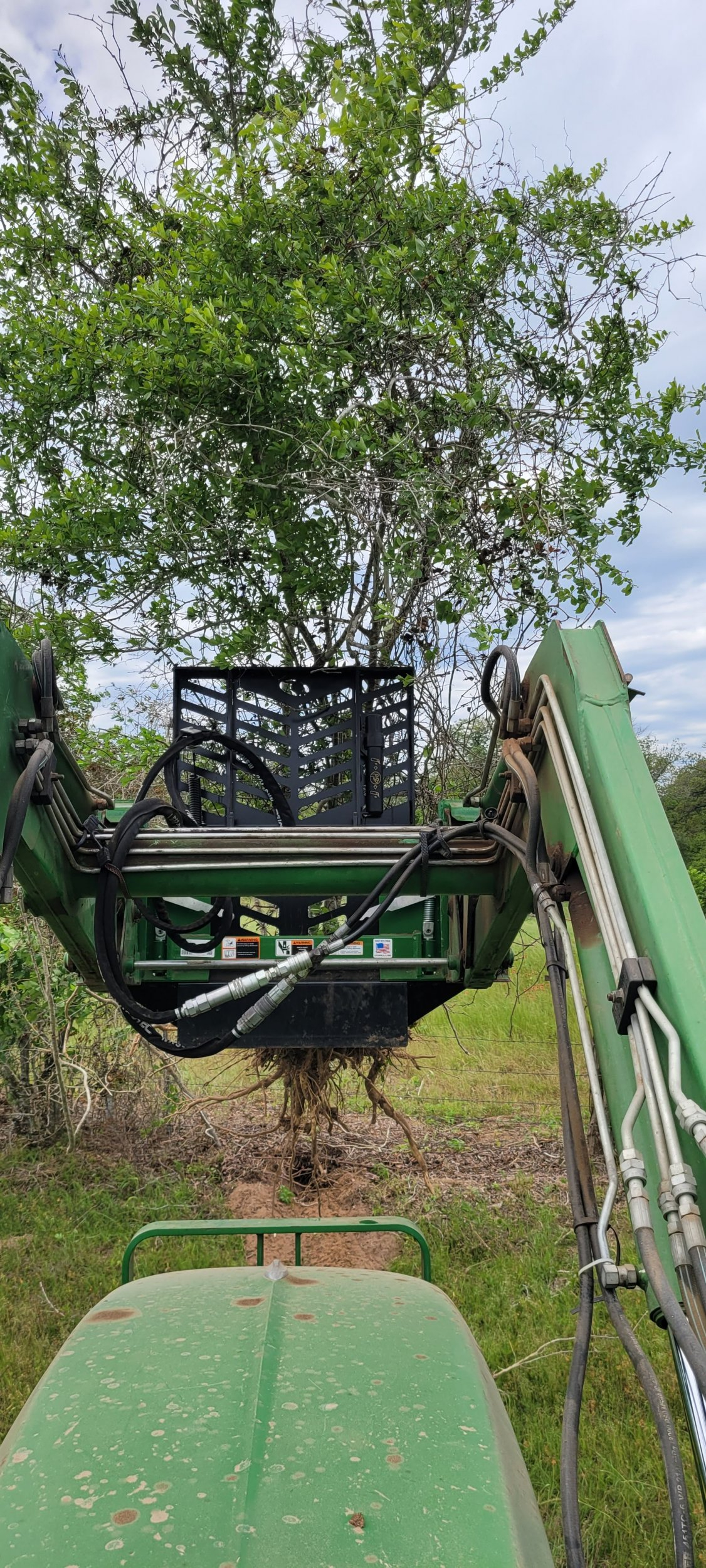

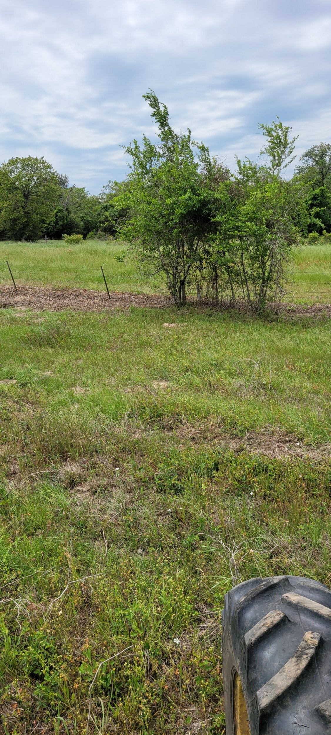

View attachment 708016View attachment 708021View attachment 708022View attachment 708023
