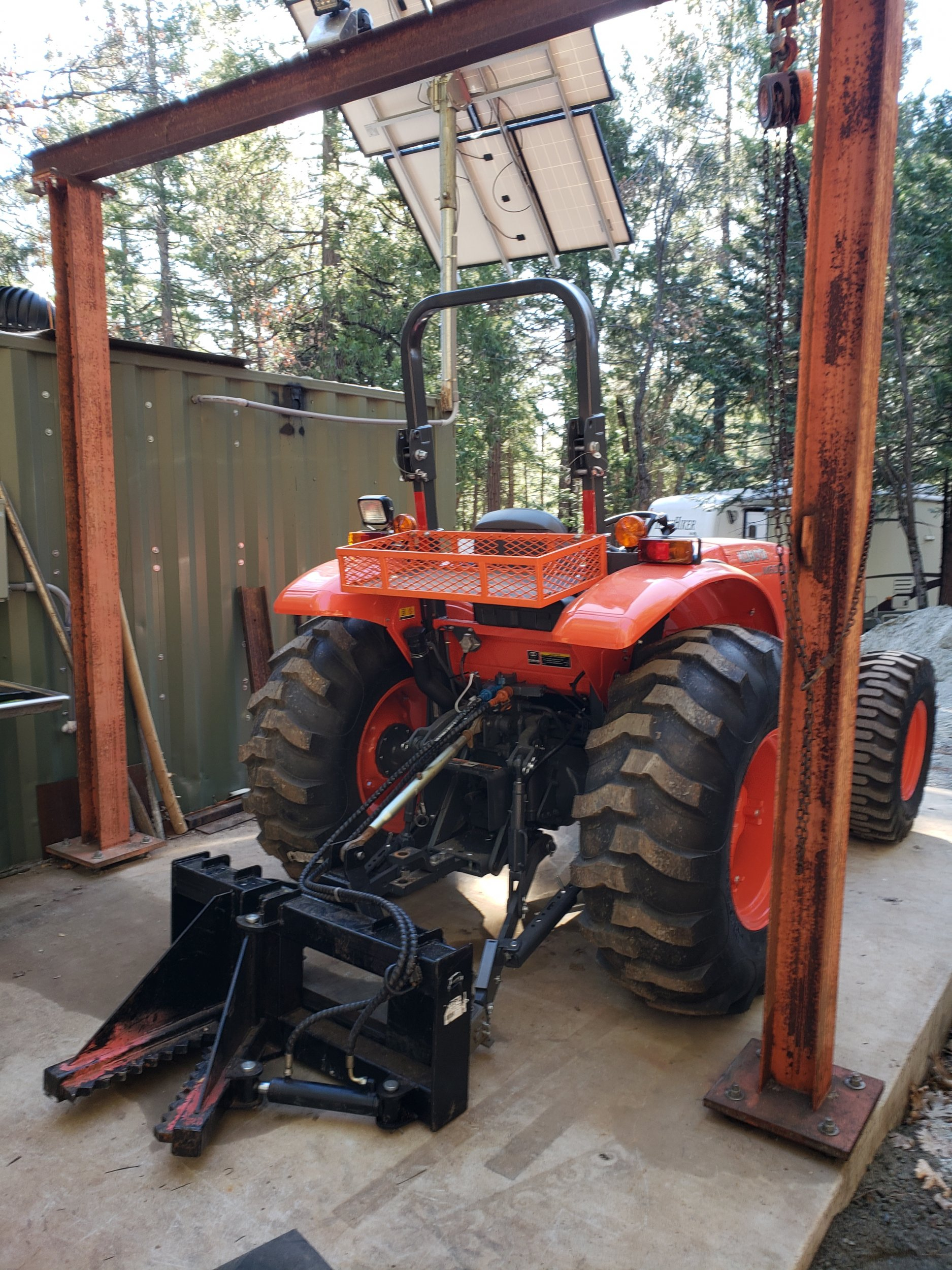

I've had mine for 4 years. Pulls tree's up to 6" easy and 8" with a little extra work. I pull ceanothus bushes about 3" around and 30 feet tall with ease. I use the " jaws of death" on the 3 point and a grapple on the the fel. Makes for quick easy work!

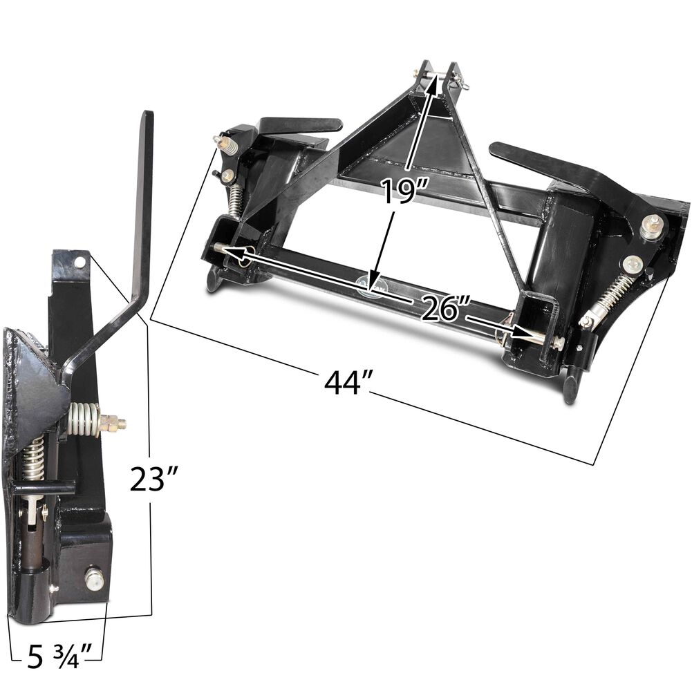

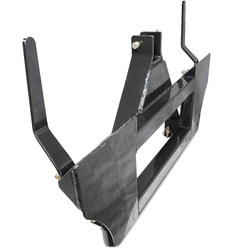

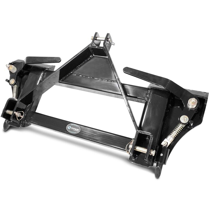

@ranger danger how is yours attached to the 3 point? i world like to replicate your setup

I have a quick hitch to 3 point adaptor so I can run all my fel implements on the 3 point as well. I got it from Titan. I looked but I could not find a pic. Ill look some more.

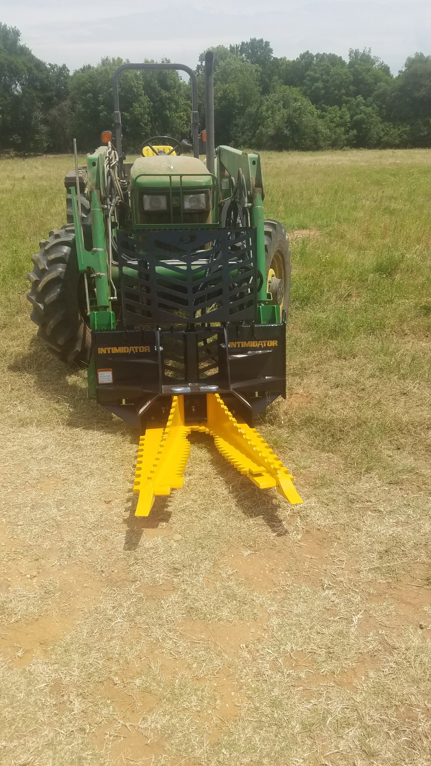

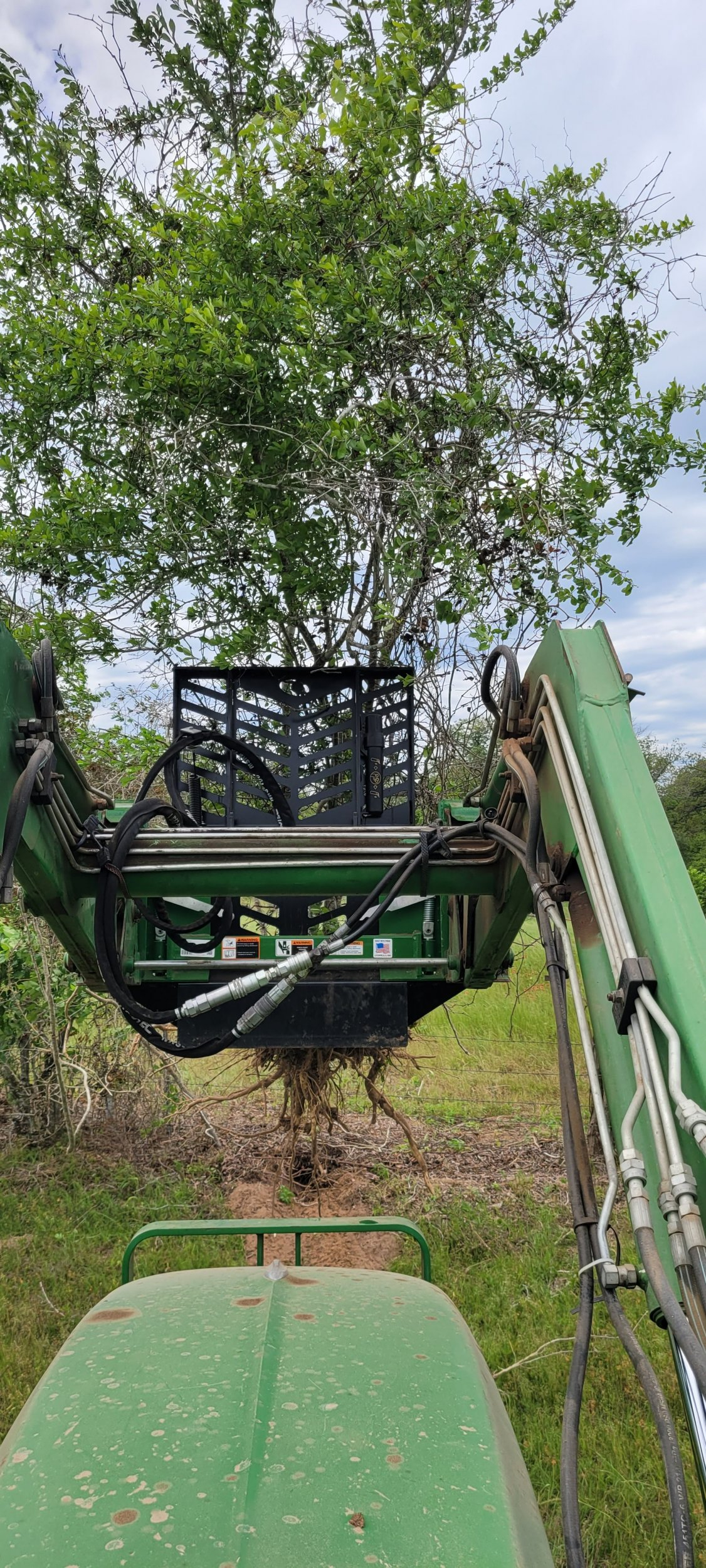

. View attachment 707929
I used mine the same way.
Puller on the back, grapple on the front
Cleared out several acres of 2-5” gum tree saplings. Worked great.
