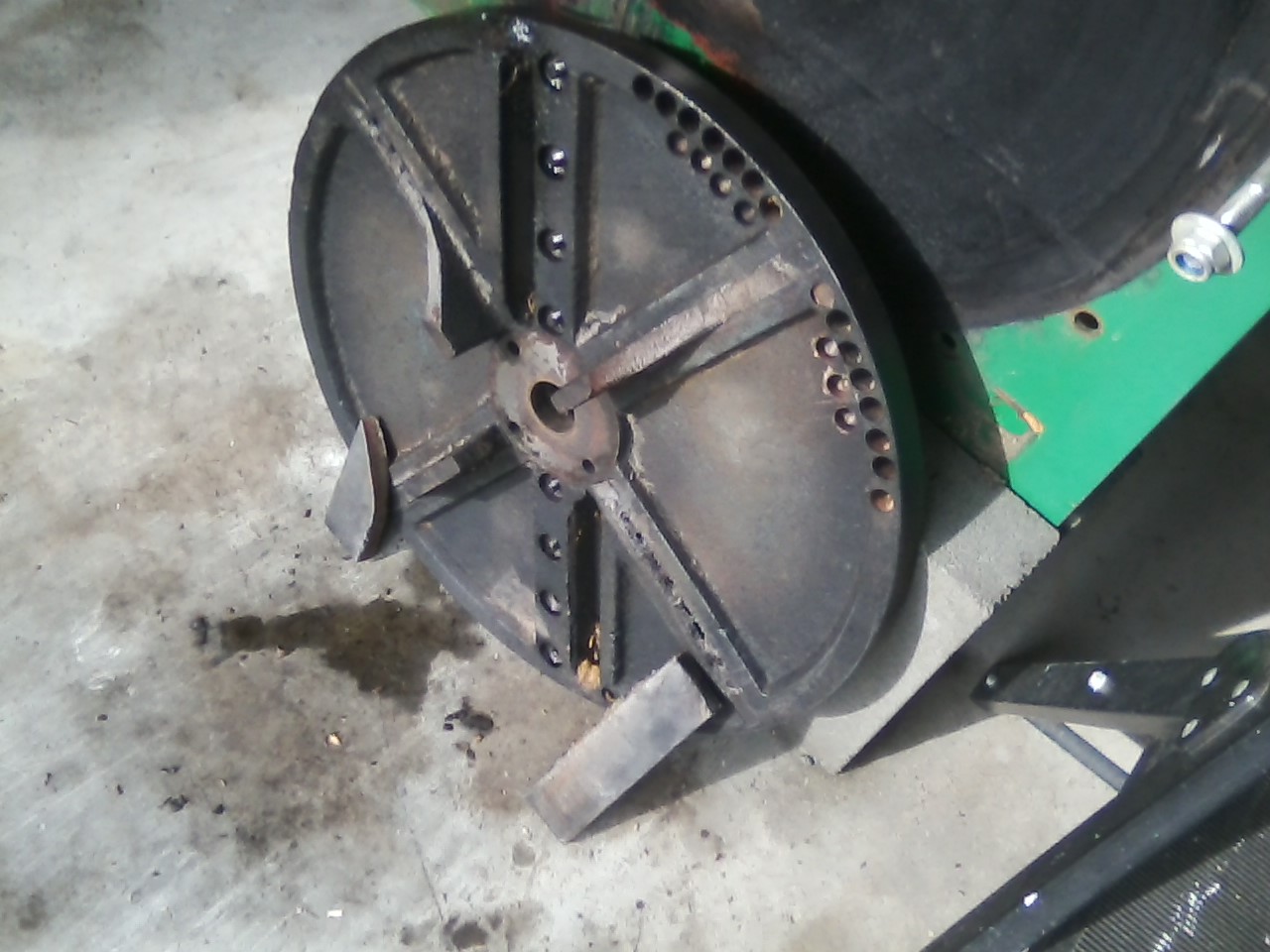

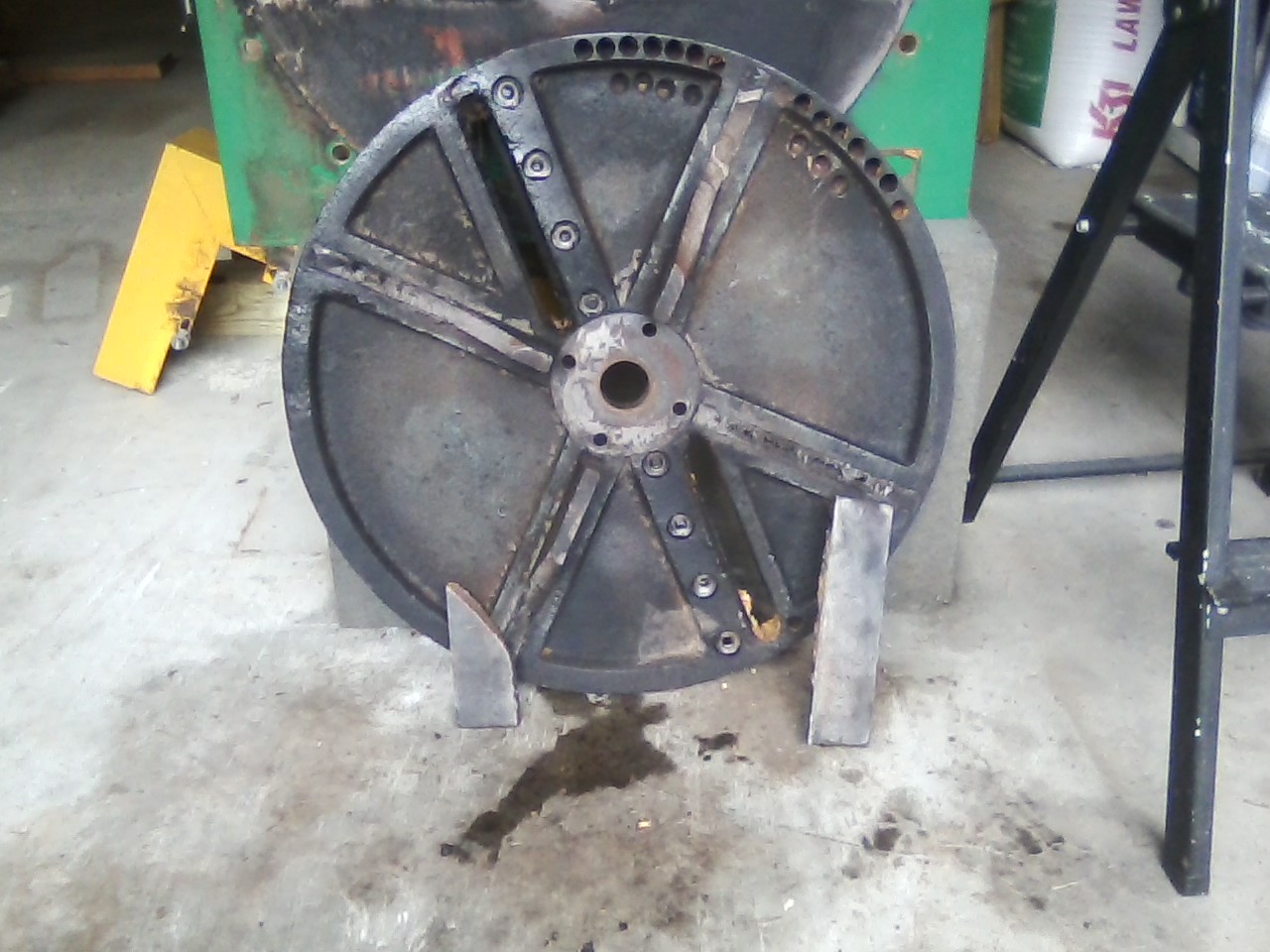

But to my update on the Liberty Implements WC-8A (I unfortunately bought):

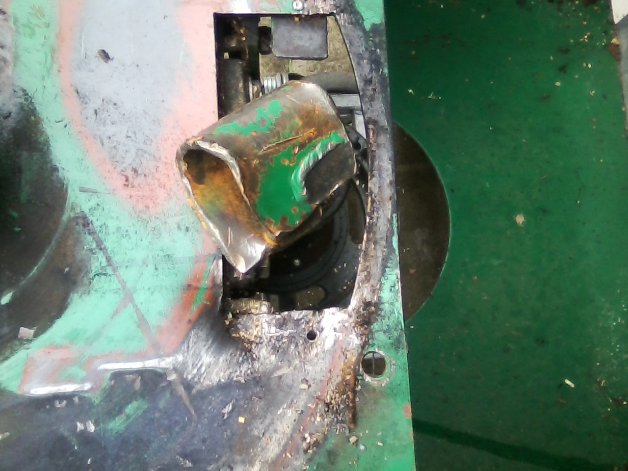

The welds on the bottom access door broke and the door fell inside the chipper! Darn bad design. Here are pictures of the result.
As you can see in the picture of the bottom door, it was folded in half and stuck in the chute. The fins from the flywheel where ejected through the chute... except the whole one... that stayed inside:eek:
I have tried for three days to get a parts list and availability of a new flywheel... no results... either parts people where not available, out on service call, etc...
I would not recommend anyone even considering Liberty Implements... or whatever they call themselves... BUYER BEWARE!
So, anyone know where I may be able to find a flywheel that will work as a replacement? Anybody know what it may cost... or should I just resign myself to having <$50 of scrap iron...

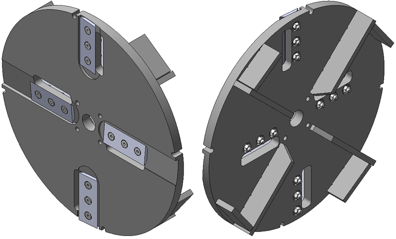

They went to a 4-blade flywheel on some of the 8" chippers. I imagine they cut a little smoother than the 2-blade like mine. I haven't used mine in 2 years. No telling what will come apart. I'll probably have to replace belts.

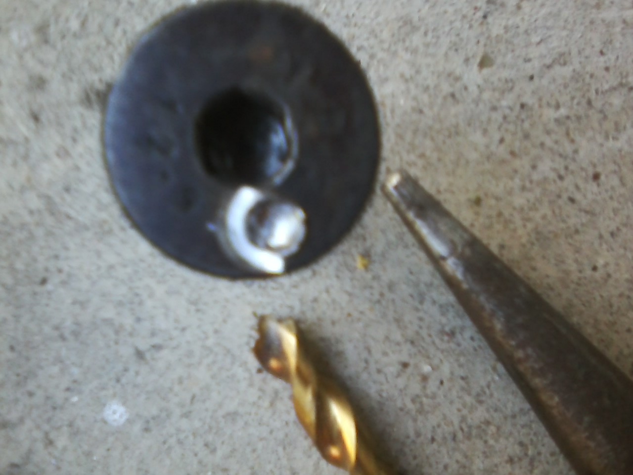

Update on repair... I was finally able to get the blades off the flywheel.
I broke two hex sockets (Husky from Home Depot... got them replaced for free... HD said I had to go direct to Husky, but when I called Husky they said HD sold do exchange).
I was able to brake the threads free by drilling a spot on the bolt head and used a punch and 2lb sledge hammer.
