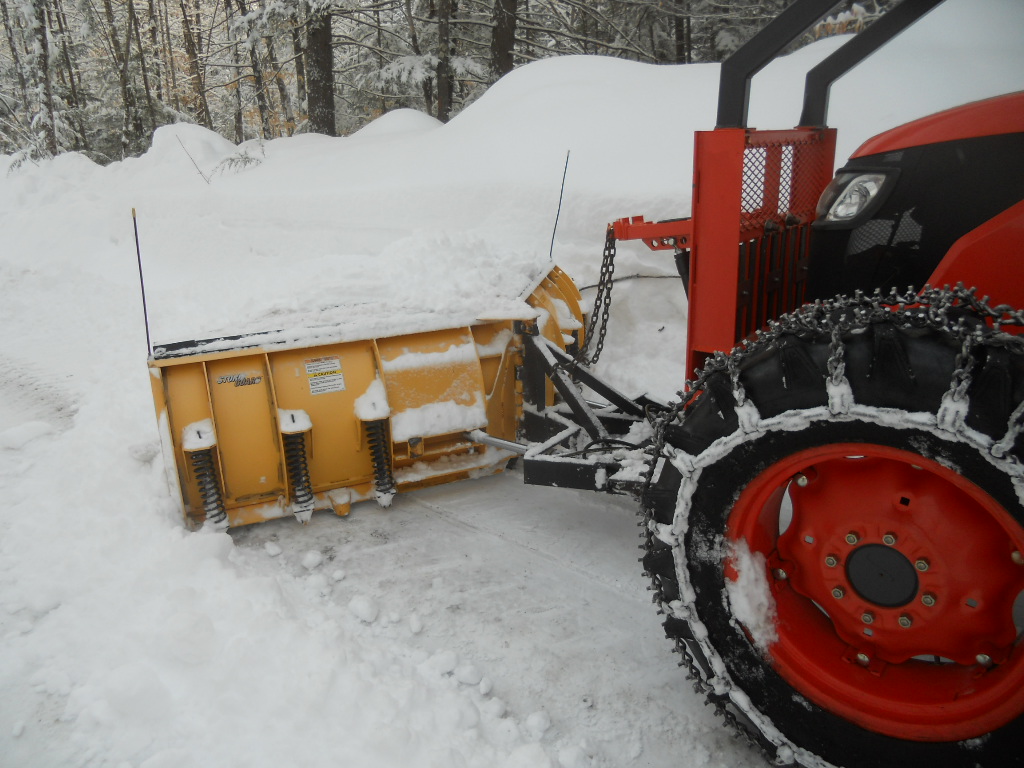

Hilbilly, since no one mentioned the only alternate to forward plowing with a blade is a frame mount..... here's mine. 9'6" v. I did this for several reasons, 1- I got that blade for $650! 2- I needed the loaders valve functions to operate it (once you try a "V" you'll never go back! 3- It's a lot easier to maintain steering with the blade 3' or more closer to your steering axle. 4- I don't like imposing plowing shock & sideway loads on my loader if avoidable.
View attachment 539112View attachment 539113
I built the frame mount and (without checking) I think store bought options are slim to none.

Rustyiron, I like all of your points. Your attachments don't open and I'd like to see how you set up your plow.
   / Anyone Bent Their FEL Using a Snow Plow #48
Oops. Pic of frame mount, hyd lines from loader & the blade attached.

RustyIron, very nice frame mount. How are you controlling your blade doesn't it take two controls for the v and one for the lift?
That is a much sturdier mount then hanging off the front end loader. Also with the lower positioning of the push points I believe it would be easier on the tractor.
