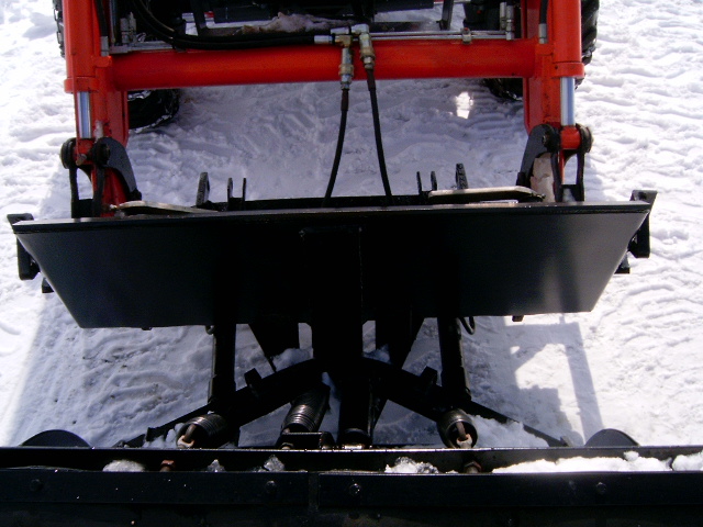

Rustyiron, you've got some real nice fabricating skills. That is a great and sturdy looking mounting system. I too am curious as to how you control what appears to be 3 functions.
grsthegreat, thanks for that.

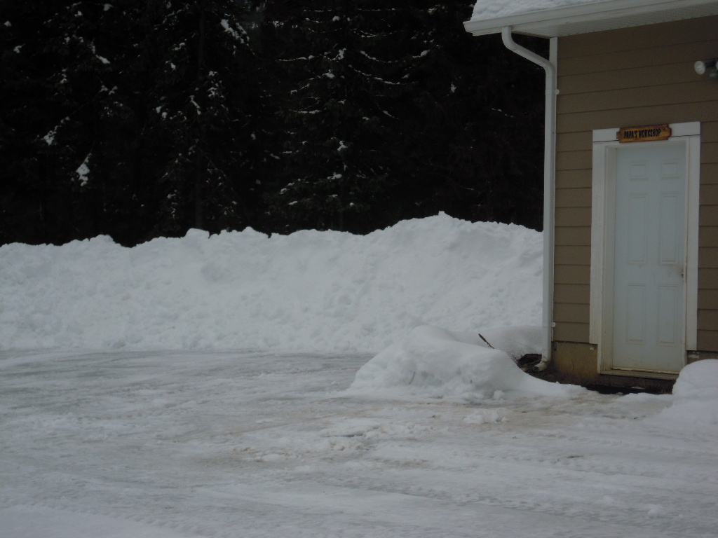

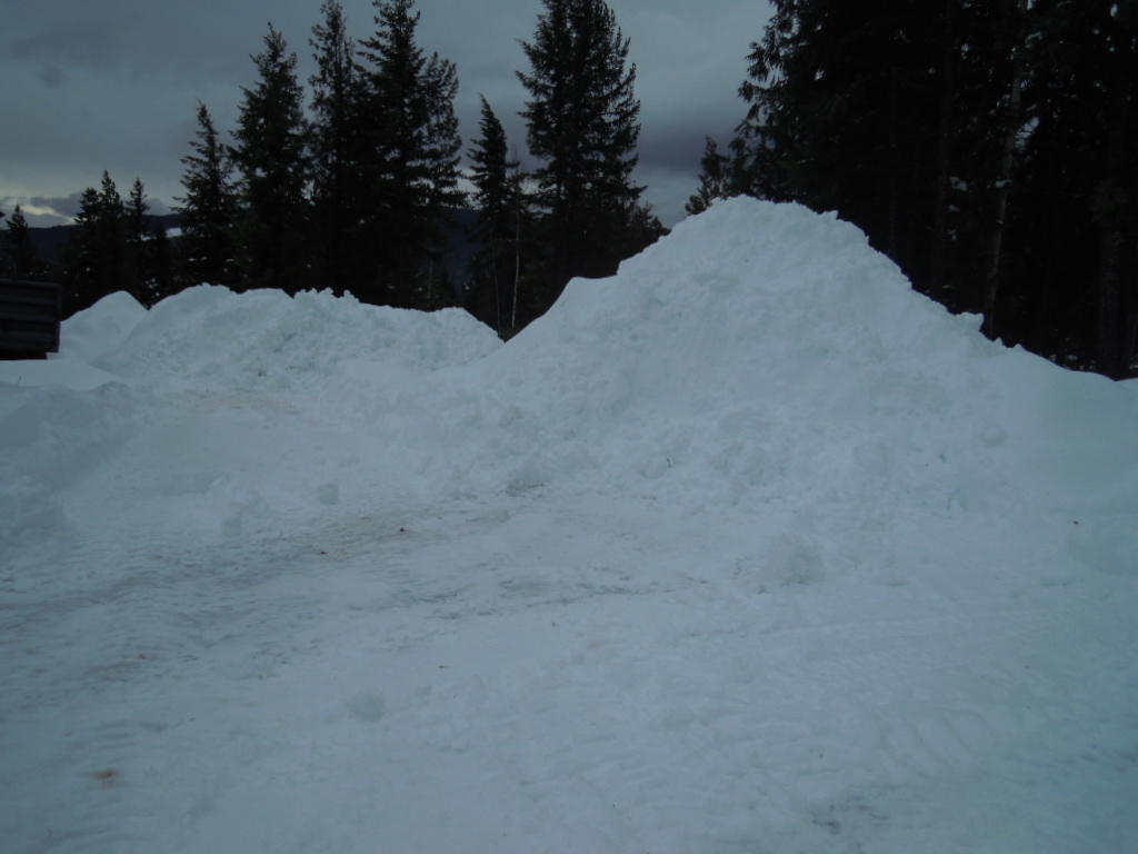

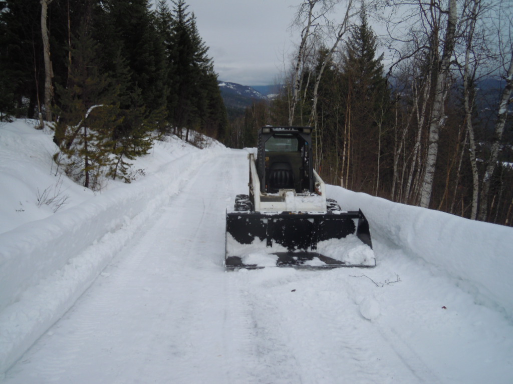

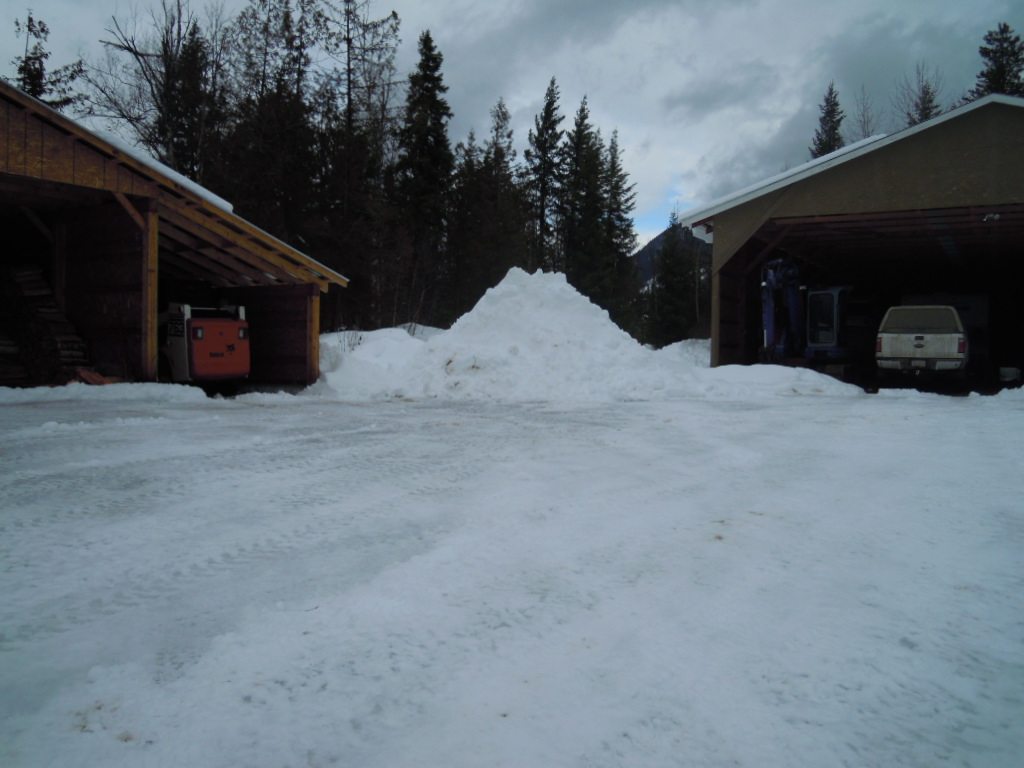

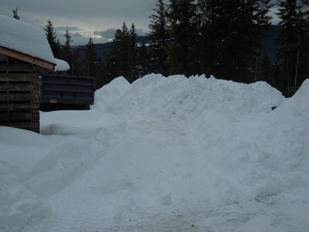

I still had some cleanup to do on the driveway after blowing snow yesterday. So I decided to play it safe and leave my poor, frail tractor in the barn :) and use the skidsteer. I put chains on the SS for the first time and that made a huge difference, especially with the ice that's under the snow. I could run along the edges and scoop up the snow the blower didn't get and spin on a dime and dump it over the bank. Worked great going down but not as well coming back up. The driveway is relatively flat for the top several hundred feet then an average of about 10% for about 3/4 mile and the bottom several hundred feet is about 15%. I still think the tractor is the better machine for this but I did give some thought to using the SS with a plow on it to skim off the tops of the banks and push them over the edge, since the SS is narrower than the tractor, it would take a bigger bite. May have to give that some more thought.
Also used the SS to move a bunch of snow away from the house. The piles are starting to get big.

RustyIron, very nice frame mount. How are you controlling your blade doesn't it take two controls for the v and one for the lift?
That is a much sturdier mount then hanging off the front end loader. Also with the lower positioning of the push points I believe it would be easier on the tractor.
Lou I have the 3rd function for the loader, that's the single 5th line in the pic that operates the s/a lift cyl. I put the left wing on the bucket motion (L- back / R- forward) and the right wing on the boom (up - forward / down - back) and the elec 2 button control on the joy stick for the blade lift cyl. I'm very happy with this set up except now I want one of those XV-2 fancy tall "flared" Vee!

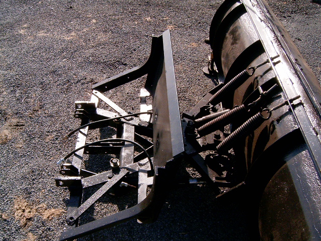

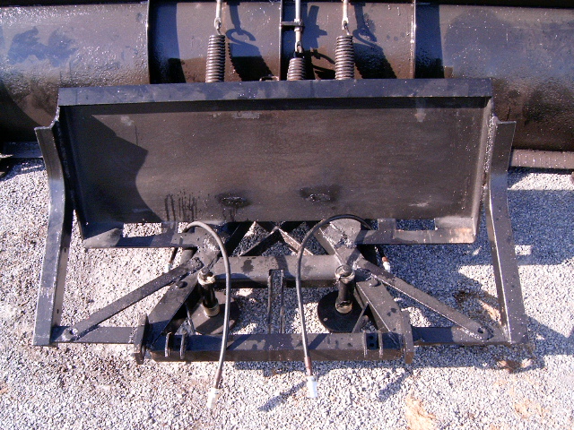

DK35Vince,
Do you have any pictures of your plow mounting system with the angle cylinders underneath. I like the idea of having the plow as close as possible to tractor. Thanks
This is all I have.
Not pretty but it works. I put skid shoes under the A frame to prevent the cylinders from dragging.

DK35 Vince,
I have no doubt the rig you have works well, and you designed it's frame to overcome a lot of the inherent flaws of a truck plow retrofit to a tractor loader, BUT Kioti DK-35's and 40's have strong loaders, as you know. I can't speak to what other tractors loader capacities are, and thus some may have issues with the extra framework weight of a properly retrofit truck plow. And not everyone is an expert welder or has someone to do the frame rework for them. If money isn't the overarching concern a HLA plow gets the job done once and done with easy access to parts, etc.

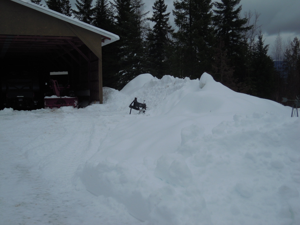

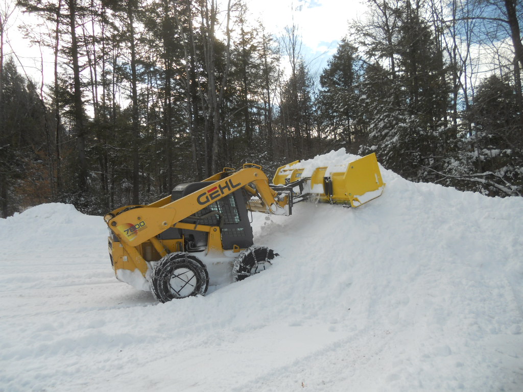

I also use a SS for my snow. It's great for pushing the banks back as it "reaches" out about 4' in front of the machine (unlike a bucket) and you can stay on the road with the machine. I have several open areas and a "pusher box" is amazing for that, much better than even a V blade. The blade pictured is a (8'6") "Snow Wolf" brand and the wings are removable for conventional plowing.
If you were to get a plow with the SS mount you'd have 2 machines it could be used on for different situations. There also a few plow companies that make a quick attaching "box" attachment Snow Removal Equipment | Snow Plowing Products | Kage Innovation and FastTach | SnowWolf Plows removal of my wings is a 45 minute job so I have another normal plow for the SS.
I have a long road also and with the pusher box there are areas that there just is no room to put it and I'll carry it a 100 feet or so with the pusher to a wider spot.
I think I understand your situation not wanting to blow an 1800' road every storm, blowers do a nice but very slow job and then there's your neck! Short of a 100+ HP tractor and a "pull" blower along with a huge pricetag, I think your multi machine approach is the next best thing.
