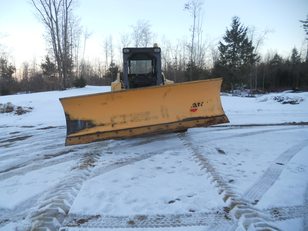

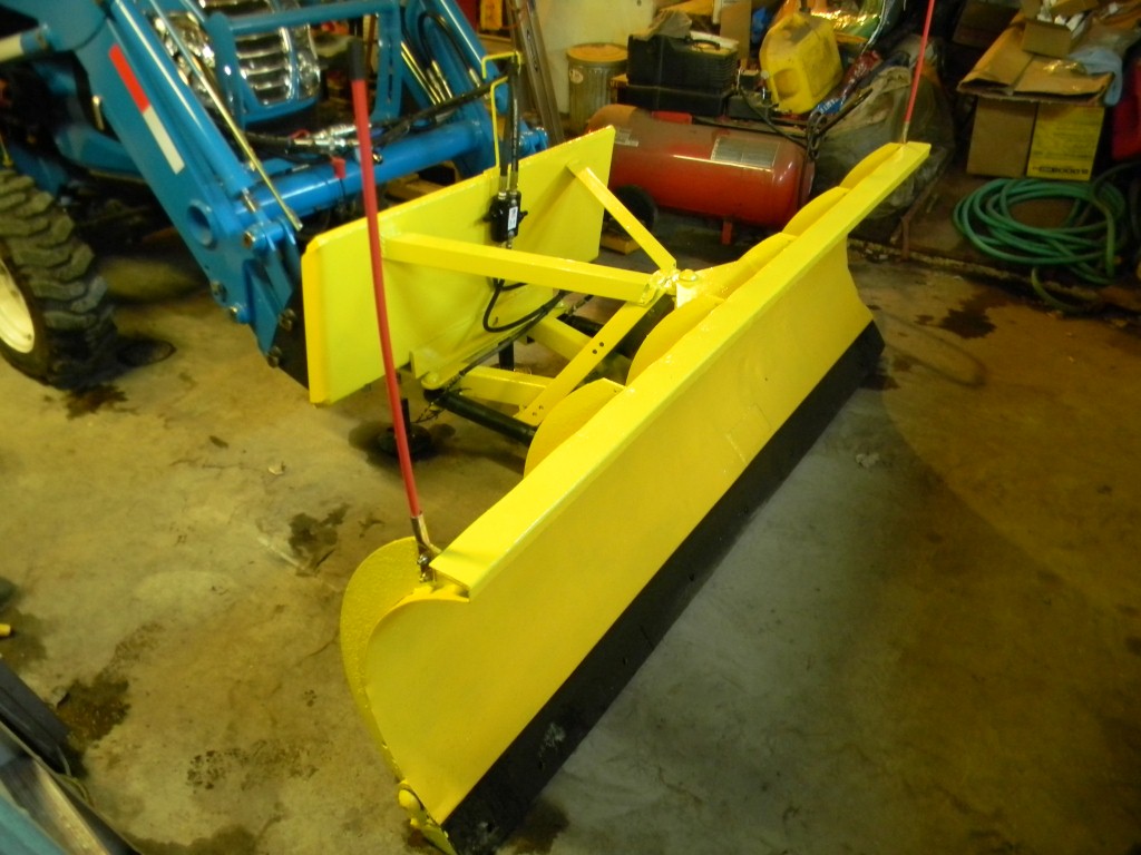

You must know some other "hillbilly" near you that welded up an older truck plow to fit a SS and chances are he made it like a truck plow that only the plows weight is on the blade and the loader arms only push. Very little to no learning curve with this type. Coyote machine makes some very valid points but do you keep it to the point it's not returnable to the dealer?

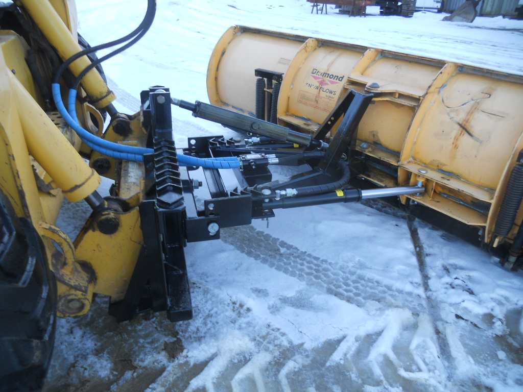

I'm sure you've seen them here, but if not here's a couple I made.
This is a "Diamond" 9'6"
Here's a 8' Fisher

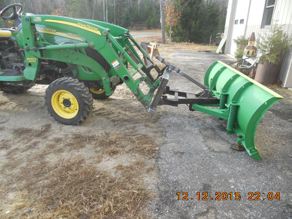

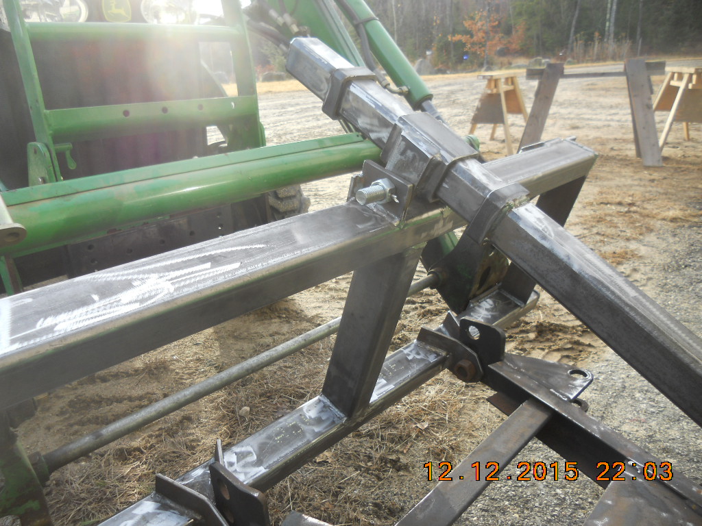

Both have a "top link" type thingy that I make for true blade floating of about 8-10" before it hits one of the stops. This allows for down pressure if you "roll" your bucket mount forward.
This should explain how the one on the JD works.

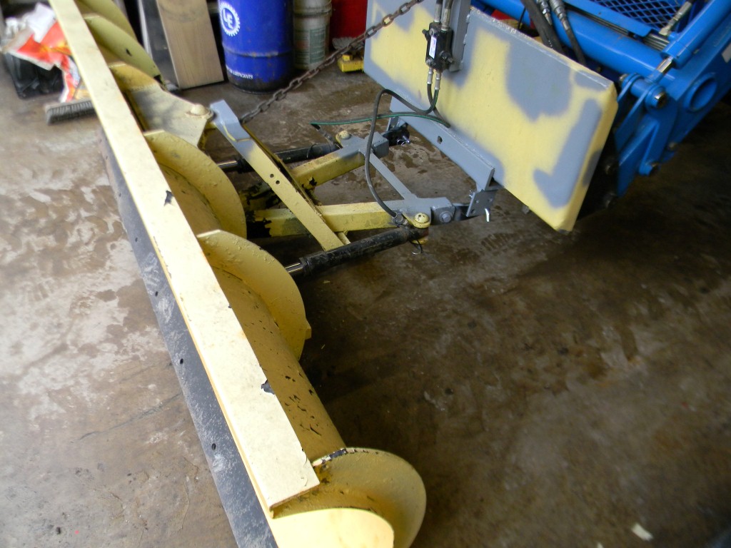

The yellow one on the first pic I did a little differently to allow for the horizontal rotation I built into the plow to follow the ground better. That tube just telescopes with the same action but within it's length with top link type balls on the ends.

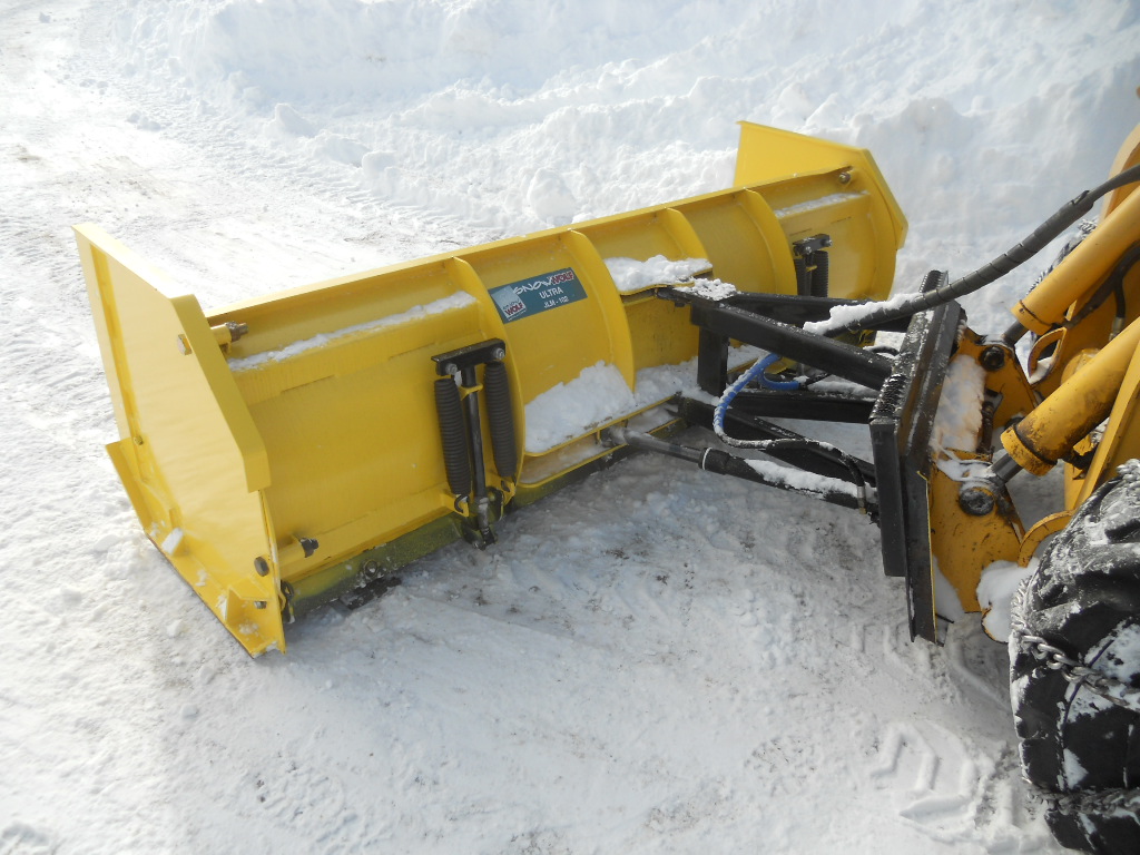

I went to my daughters place to try the plow some more. I already plowed everywhere at my place and in some areas several times, just trying to get the feel of this thing.
Her place has a short driveway of about 100' then an open area of about 150' x 100'. All of it gravel but fairly uniformly graded. I found that to be easier to control and without using the loader float there was less stress on the loader. For me, so far anyways, it seems this plow and my operation of it, are better suited to uniformly graded areas. When I got back I lowered the skid shoes ( to me lowering them means dropping them, by adding spacers under the bracket). Same result as you describe Coyote, just a different perspective I guess. Anyways I tried that for a short distance on my already cleared area in front of the house and still have the same issues, albeit the loader arms are a bit higher off the surface, which is good.
I have a question. Is it necessary to always use the skid shoes and have them riding on the surface. I ask because my son in law has a truck mounted plow and only uses the skid shoes until there is a solid base for the plow to ride on and then removes the shoes. The plow rides nicely on the hard surface without shoes. I wonder if that would work with this plow, if it had a float system like the truck plow or is it due to the geometry of the plow. I note this plow has a very shallow angle of approach and seems to be designed to slice the snow rather than scrape it. I'm going to take a closer look at the son in laws plow tomorrow.
The HLA series plows don't use a chain like a regular truck plow. I looked on their site at different models and don't see any way it could float up / down. They do have some lateral float but not the former. IMO the HLA would be perfect for plowing a flat surface like a parking lot or paved (or level) driveway.
On the truck plow style the bottom A frame would connect to the QA plate with 2 pins and have a center lift chain. When used on a tractor the operator lowers the loader arms until the A-frame is level to the ground with plow shoes touching the ground then use the curl function to allow the chain to have slack. That way the plow is riding on the shoes allowing it to float up or down due to terrain. Your SIL leaves the shoes on because the ground isn't frozen in the beginning of the season then removes them when ground is frozen. I leave my plow shoes on the whole season because the ground thaws on days like we had today (50 deg F)
In your case with your HLA it appears that without a floating plow blade and not having a level driveway what happens is when the rear of the tractor goes up the plow blade in front digs down. If the blade floated it would not do that.
When I first added a truck plow to QA plate my blade was fixed solid to the plate and no float and did the same digging. I quickly modified mine to allow it to float.
I've attached pics of my first attempt fixed and later modified into a floating blade.
