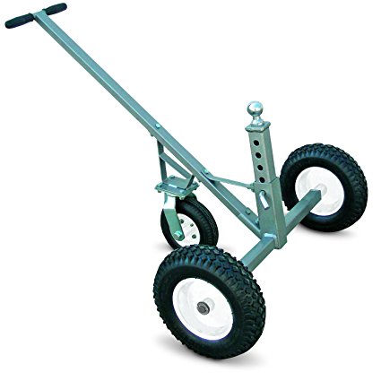

Can you adapt this style trailer mover to the BCS?
