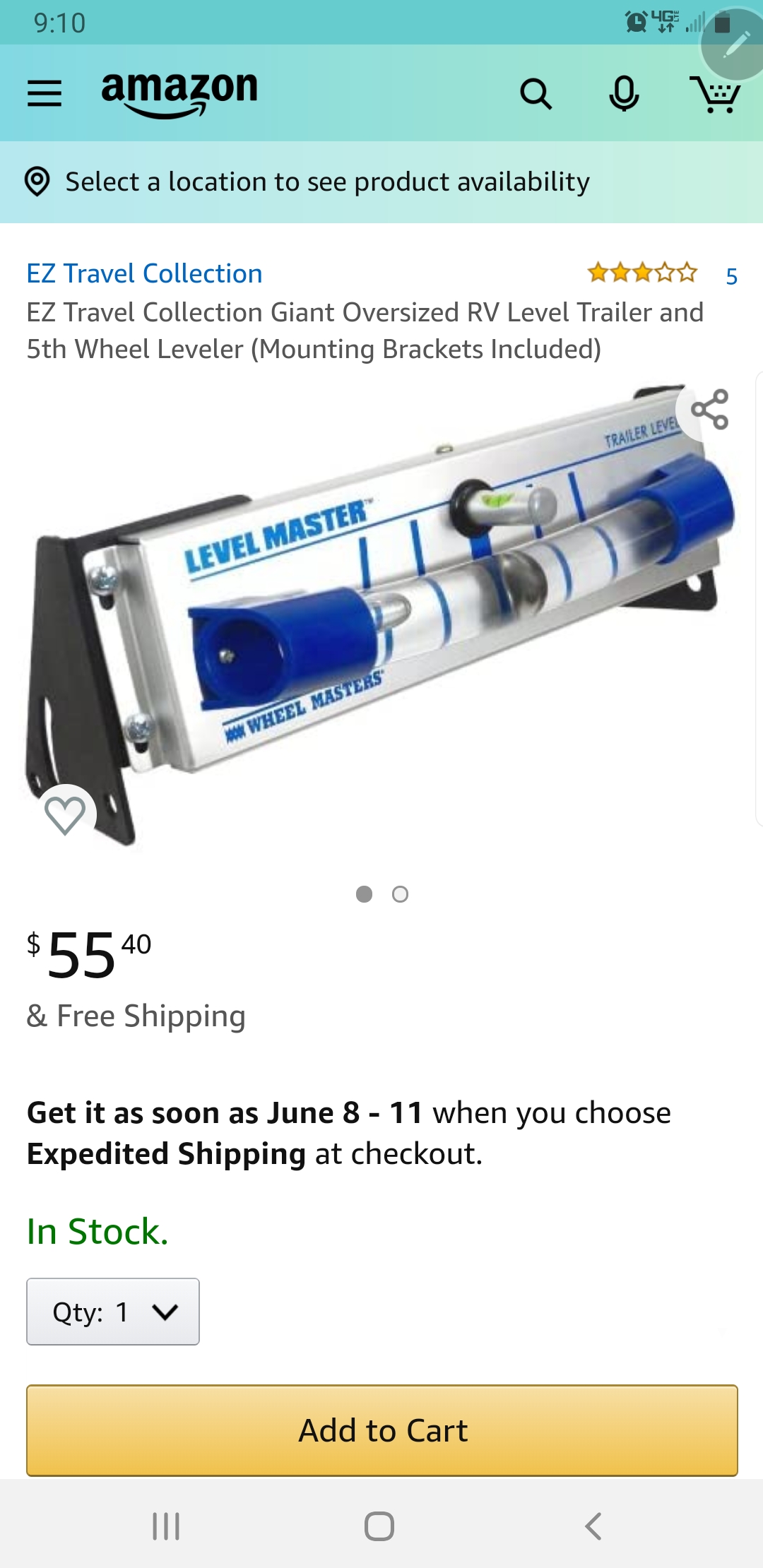

I have a mountain, with twisty mountain roads going up and down and winding all around, 128 acres of land my wife bought. I'm wondering if mounting an oversized level like this;
Would maybe help me figure out how to grade out all the roads for water run off. The roads aren't flat at all and they are bermed all over. It's kinda like a dirt road course, except it's not a circle. It would be fun to haul *** on it with a jeep.
Really I'm just trying to get an idea of how I'm gonna do what I need to do to route water where it needs to go, and stop eroding my roads. A big level on the box blade seemed like it would help. I've got top and tilt.
Any ideas?

Probably not. You will be adjusting the box blade forward, backwards, and possibly side to side to match what you need to do. Smooth, dig, scarify the surface. You do not mention if you have top and tilt hydraulic function, but that would be my first choice to put on the tractor to do what you want. Makes it easy to adjust the position of the blade as you are working.

I think that it would be handy to have it mounted on the box blade to show side to side level. I'm assuming that it is large enough to see and read easily.
Some folks mount them on the tractor as a safety monitor so having it on the box blade could serve that purpose also.
This is one of those ideas that make we wonder "why didn't I think of that?"

It measures 11" wide and I think it could be easily read for side to side.
The berms on our roads make it really challenging.

The bubble might break up into lots of little bubbles due to vibration, and be hard/impossible to read. I occasionally have that problem with bubble levels in other applications. Worth a try though.
A lot of the box blade work I do, angles are all relative, and you may as well just set your angles locally with the tilt cylinder, relative to the tractor wheels on the ground. A bubble level is going to give you an absolute angle, relative to gravity. It won't be of consistent use if the road is sloped and changes slope.

I was thinking i would mostly use it for a gage at the beginning, so I could set my bb down and know which way the road was sloped. It's not easy to tell when you're inbetween trees and the road is eroded and bermed. I didn't think about the bubbles breaking up. Especially on a big level like that. That may be a concern.
   / Anyone ever mount a level to there box blade for grading out roads? #8
If that's the purpose, no need to attach it. Just set a torpedo level on it, adjust, stick the level in your pocket and carry on.

If your 3PH has hydraulic T&T or even if it doesn't just park the tractor where it is sitting level and mark an indicator on the side link where it is level with the static side and use the mark as a guide...

Like Alex Trebek says - "the three P's". Practice, practice, practice. Any type of level will only indicate when the implement is level with the world. Not how it should be angled to properly get the job accomplished.

Yup. Really the only possible reason I could see for a level with a grading implement is to get the tractor and implement parallel with each other, and that'd only be needed if there was no flat surface available anywhere to adjust on. The tractor would have to be jacked up on the low side till it was level and then the implement could be leveled. I can't imagine a scenario where that kind of precision would be needed, but that'd be a way to do it if desired.

I'm a little surprised to see the "less than positive" comments for this idea as the OP is simply wanting to know which way the water is going to run. Yes, you can usually have a pretty good idea which way the terrain is sloped but I've been surprised a few times when "breaking out the bubble". Then all bets are off when trying to do this in rugged country.

I've considered doing this a few times ...haven't done so yet, but I've also considered just adding a simple plumb bob which may be easier to see from the tractor seat (and potentially easier to create from scratch).
Either would likely be much cheaper than a GPS receivers made for such things.
I'm assuming you're considering this because you're wanting to understand what slope to add to the road relative to gravity not just to determine level to the tractor/existing road surface (if the latter a pair of devices - or measurements would likely be needed so both the tractor and the box blade could be measured relative to the world in an absolute sense, and then compared to each other).
I'm actually intrigued by that level in the picture since it looks to be indicating level with the center at the bottom than the top of the arch, which makes me think it's using something other than air for indicating level. From what I've typically seen levels using air bubbles would normally be bent the other way in order to use the buoyancy of the air to indicate level. In that picture it almost looks like an object/substance denser than water is being used to indicate level with center point being the lowest point rather than the highest.

Then I'd have to get on and off the tractor repeatedly. I've already tried a magnetic torpedo level, it falls off almost immediately.
@8182, that plumb bob ain't a bad idea

Short of using a level to determine slope for safety, most terrain is just too undulating to make a level useful for anything. Even flatwork requires a slope.

I maintain "twisty mountain roads going up and down and winding all around"...and I've never needed anything other than my box blade, rear blade or rake to tell me that it is doing what I want...
...I know which way I want the water to run off...I merely adjust the side link to cut more aggressively or entirely on that side until it creates the desired pitch or crown...The side of the implement that is not cutting is always going to end up being higher than the side that is being cut...
If you do this on a perfectly level lane to start...every pass will exponentially increase the pitch etc. because after the first pass the tractor itself will be on the angle the first (and successive passes) pass creates...

I don't believe a level on the BB will help. First, you don't want the road to be level. It won't shed water and develop potholes. When grading the road, you want to put a crown in the middle. You can do this by setting you blade a bit high on the left, while you work on the right. Then on the return trip, again working the right, the left side of the BB will leave a crown.
If you have long stretches of slope, you want to put diagonal swales to carry off some of the water every so often. Volumes of running water works against you. You must divert and spread the water from your road.
