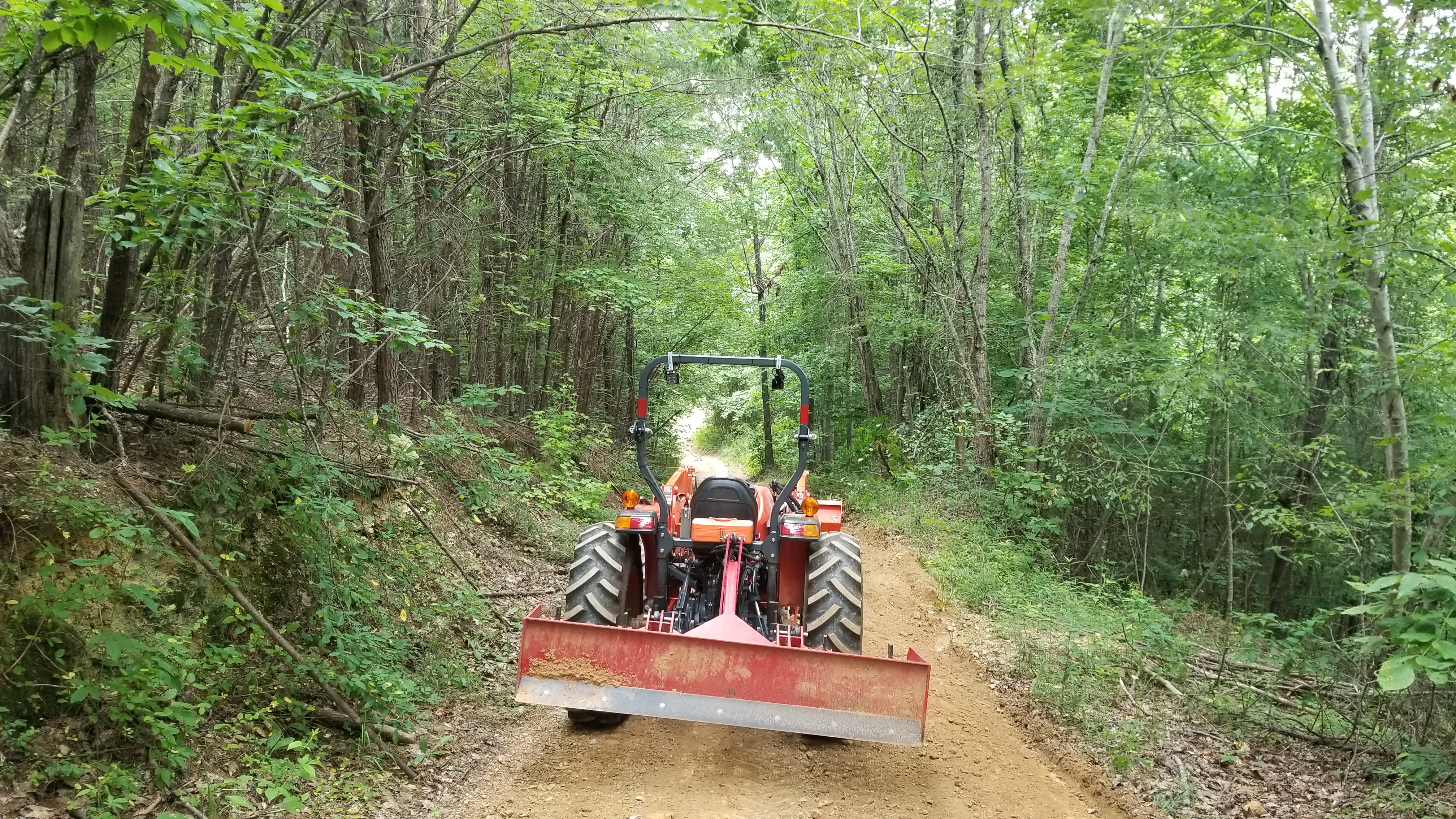

Anyone ever mount a level to there box blade for grading out roads?

I don't believe a level on the BB will help. First, you don't want the road to be level. It won't shed water and develop potholes. When grading the road, you want to put a crown in the middle. You can do this by setting you blade a bit high on the left, while you work on the right. Then on the return trip, again working the right, the left side of the BB will leave a crown.
If you have long stretches of slope, you want to put diagonal swales to carry off some of the water every so often. Volumes of running water works against you. You must divert and spread the water from your road.
A level will tell me what parts of the road are currently level, or sloped to one side or the other.
The road is sometimes bermed at an angle and the ditch that I create will be on one side only. I won't be creating a crown on every surface of every road. I've utilized some diagonal swales. I haven't made any that completely cross the road though. That seems like it would be hard to maintain. I'll have to research that concept more. I have numerous areas where a flow already crosses the road in a natural diagonal. They get deeper quick.

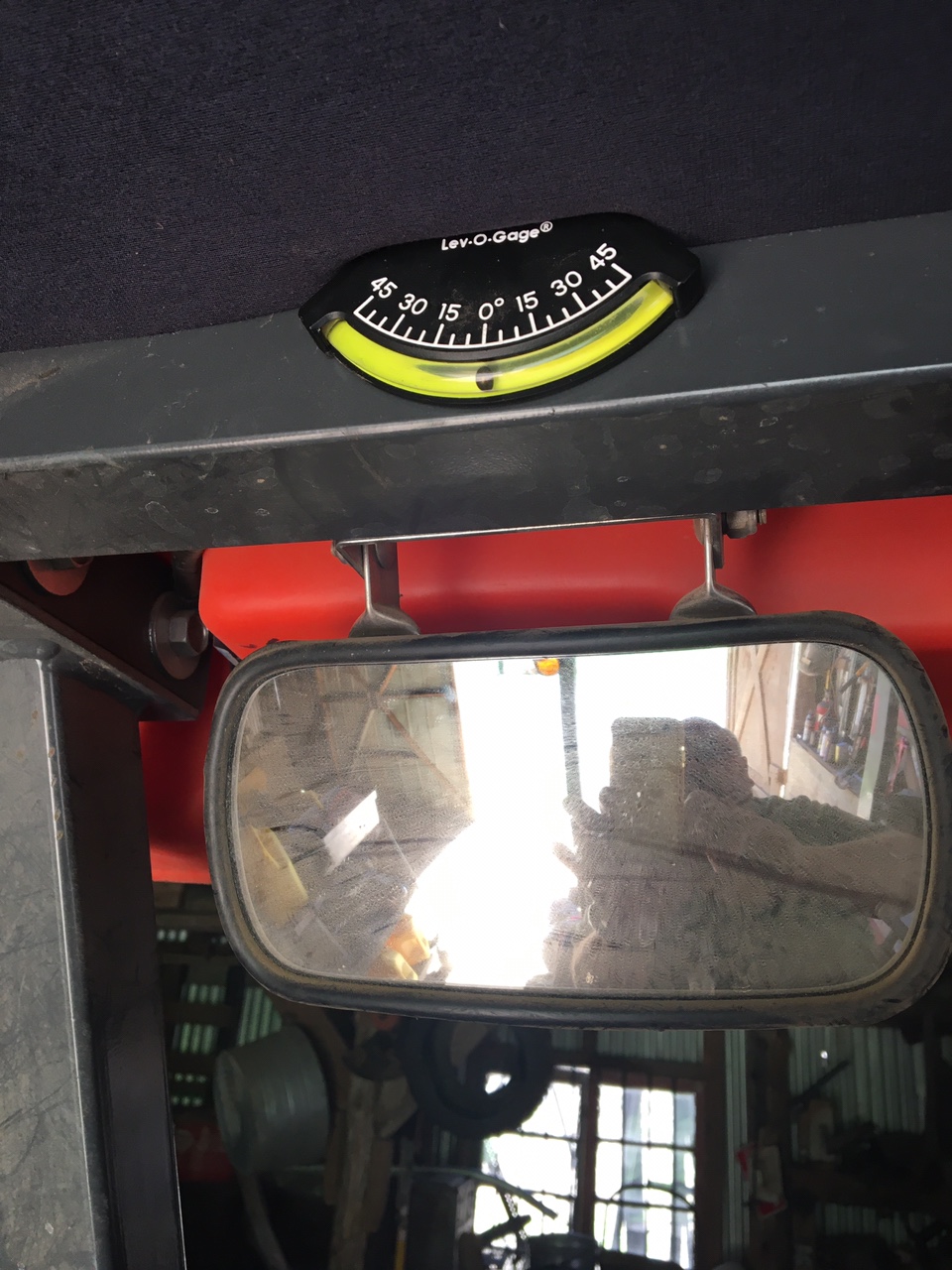

Have that same level on my 27 year old airstream RV trailer. Yes it’s a steel ball in the big tube. The graduation marks are how many inches of blocks to go under the tires to make it level side to side. Inches drop/rise per 8’. Small center bubble level front to back.
With any gauge have be able to read the scale and understand the measurement. Not sure where you mount the RV gauge to see it on a box blade while using? On some parts of my driveway the side slope would exceed the RV gauge range.
Have lev-o-gauges on the tractor ROPS View attachment 658801

I just ordered one of these. Gonna mount it separately on the tractor and then I'm gonna get one of the big ones and mount it on the box blade. I've tried not using one, but there is just no way to figure it out when you're going up and down and making ditches and the road gets wide and narrow...it's just to much to figure out the grading without some help. I hadn't previously thought of using two levels, but now it seems natural. The tractor needs one also.
