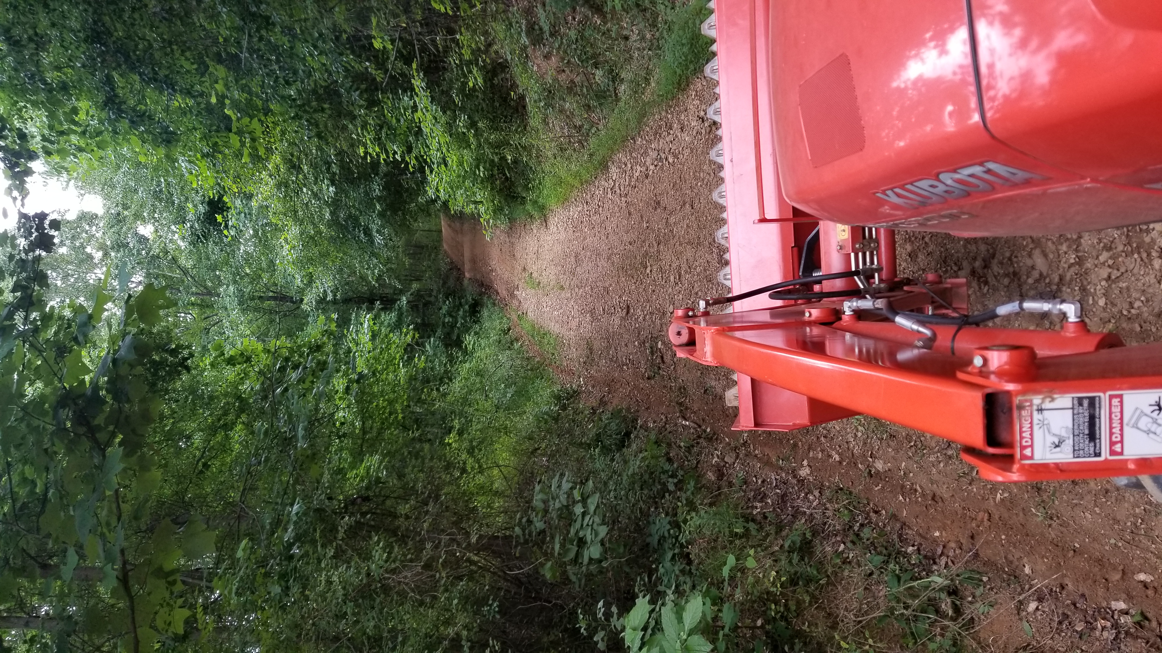

Majority of my driveway is like your photo, a step cut into the bank. Have to slope the road bed and my slope looks more than yours. Got to get the water off the road before it can make a stream. Frequent cutouts on the downhill side to divert water away from road. I grade to remove the crown caused by driving on it. Very little of of driveway can I crown or slope to both sides.
An all weathers driveway and sees a heavy truck from time to time is going to need more rock.

The slope doesn't show good in the photo, but it's too steep to drive a truck and trailer full of home materials up without some super traction tires.
FIL's Ford 250 couldn't get a 45hp tractor on a trailer up this hill.

If the rock seen in the photo is all natural, then it appears that you have a red clay/rick base.
The simple answer to the above question is YES!
But if it is red clay, more is not better! A light rain fall will be fine to work behind. A heavy rainfall will cause any type of clay base to ball up. If it is bake hard and dry, you will only move what is loose on the top.
Gravel soon would improve the traction in my opinion, even slightly damp clay can be slicker than a greased pig.

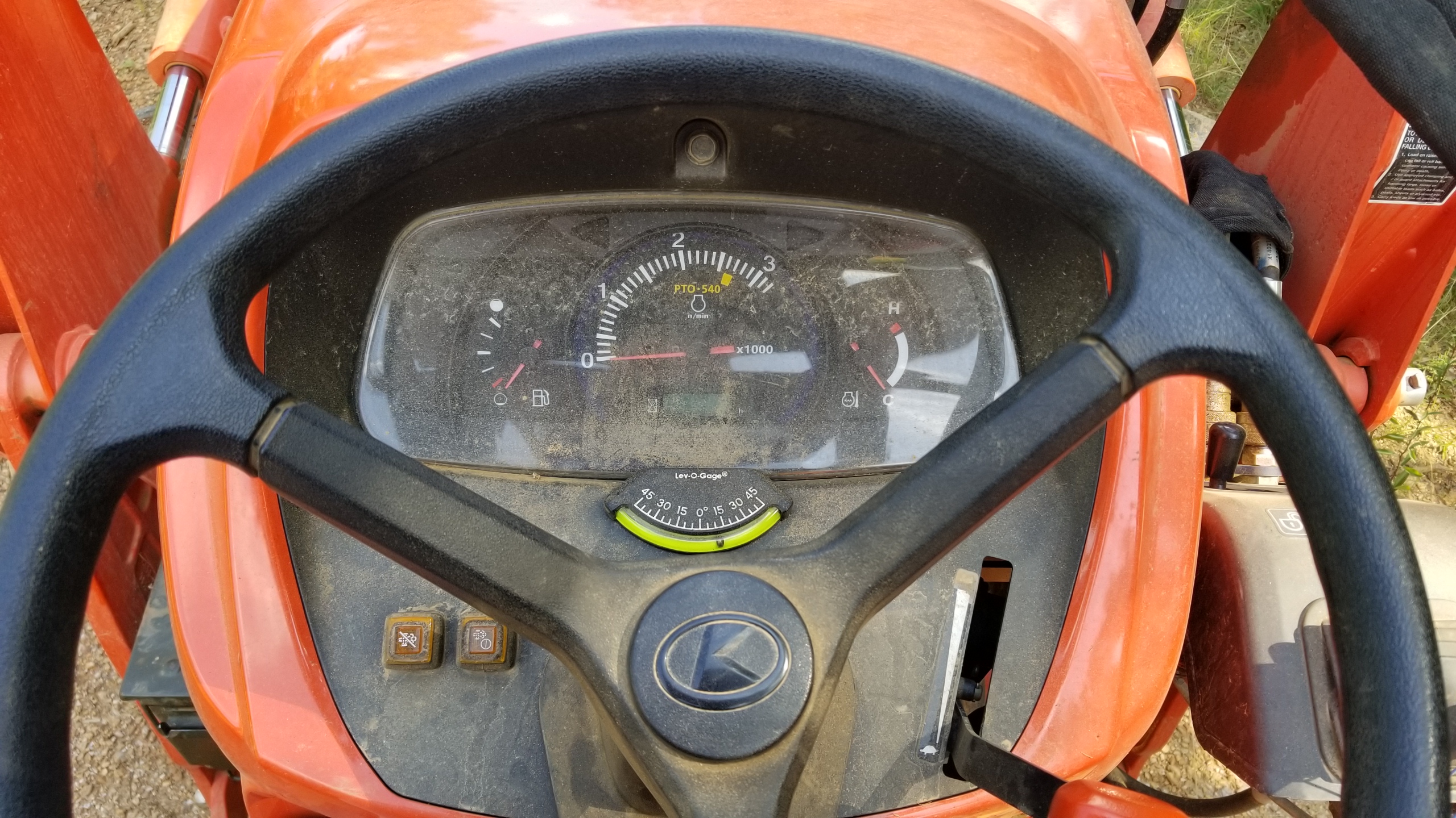

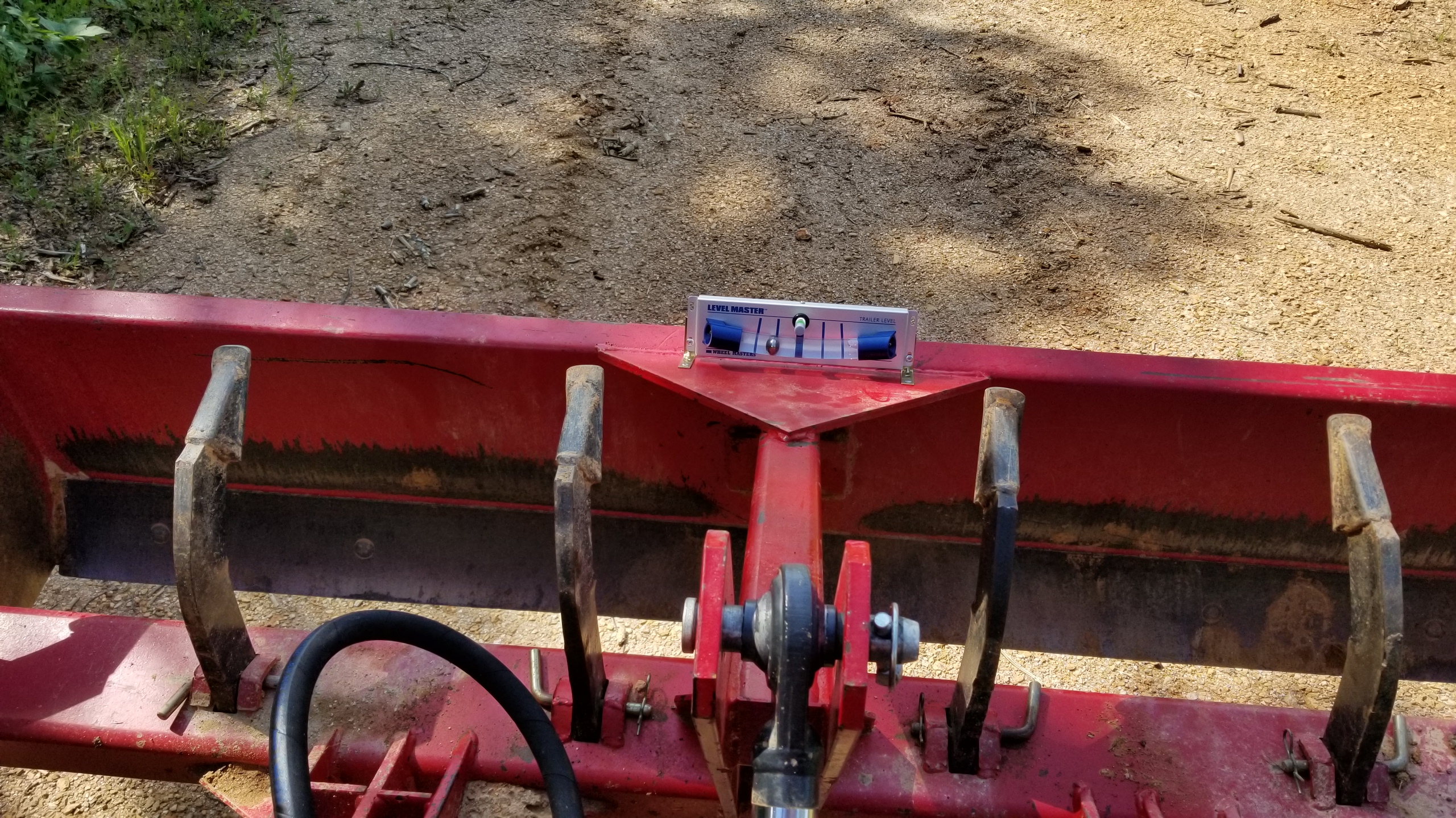

So thanks to the suggestions itt, I decided one on the dash of the tractor and one on the implement would be helpful. I hope the one on the implement can last out in the sun. I have my doubts.
