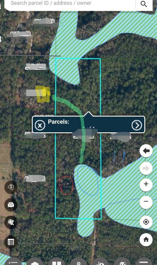

I was hoping you would show up on this Lineman. Any experience with this?
The map attached; the yellow blob would be a likely home site; the green-teal would be a trail; and the blue circle would be kinda the preferred pond location, but the red circle (which IS upland) would also work well.
I know you do a mix of contracted work; you build an farm ponds or borrow pits? Not asking you to out yourself if you did something shady, and not looking for a bid :)View attachment 871071
I don't dig ponds, but I have pumped some down and put in some spillways and over flow pipes nothing more but the one thing I do know is if asking questions do it in general not in specifics and do not give them the location specifics or you will have more people and more departments from more agency's than you ever knew existed in the middle of your business, the county I live in broke me a long time ago from asking questions that I didn't already know the answer to, which is why I said it's always better to ask for forgiveness than permission.
