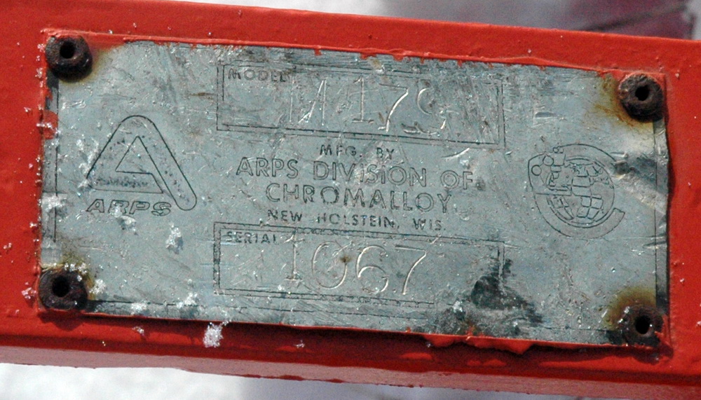

Not sure of the age, but it's probably 20-30yrs or more.
Unfortunately the seller painted it recently, but said it just had some surface rust on it prior to painting it.
I've sent the manufacturer an inquiry, but not response yet.

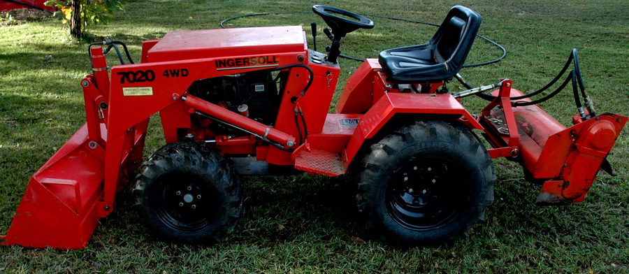

Will be used with an Ingersoll 7020 (4wd). 20hp and spprox 2,000 lbs (wheel weights not shown in pic).
I took some measurements and it will fit very nicely on the cat 0 hitch.

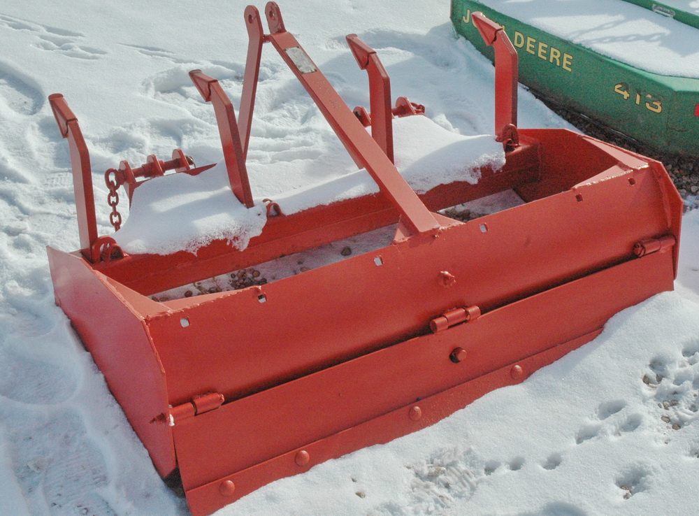

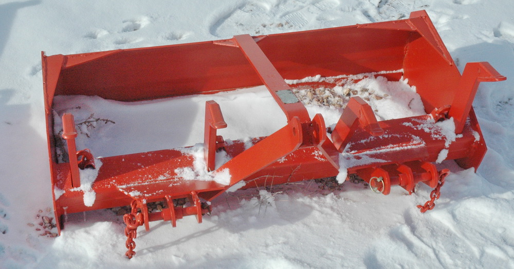

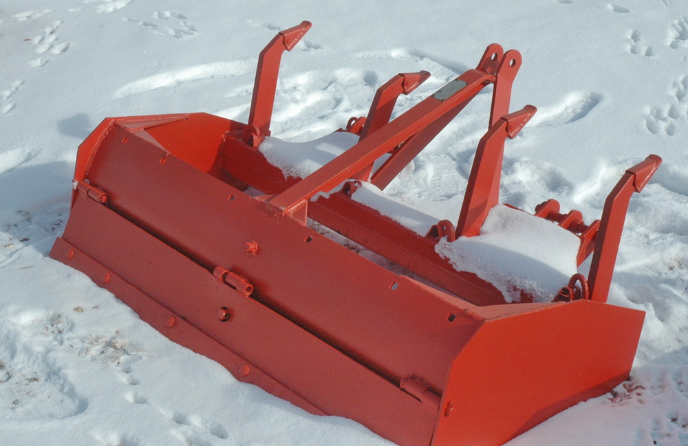

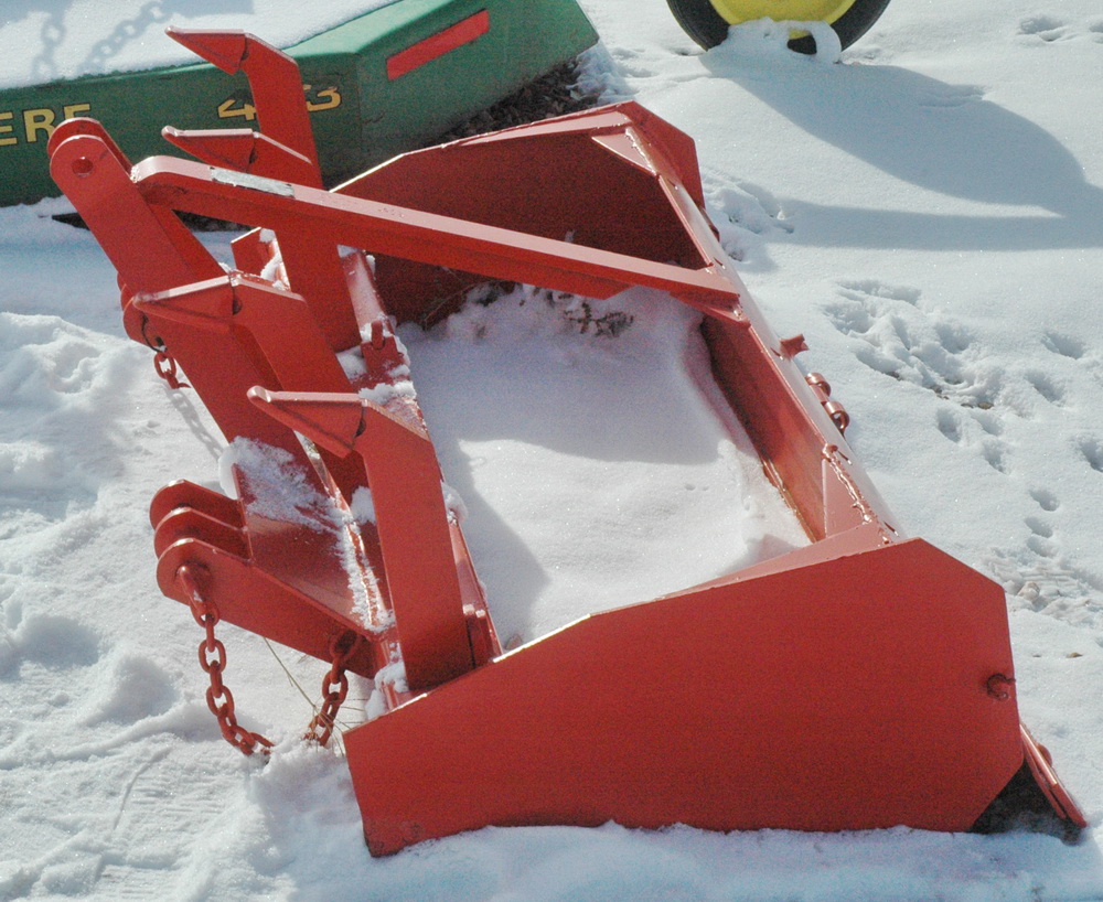

Here are some pics I shot today...
   / Anyone ever see/use a box scraper/box blade like this one ? #2
I've never seen one of those, but it looks heavy duty for its size and well built. I like the hinged rear tailgate.
Do you know if the tailgate can be locked shut? Being able to lock it shut is really handy for fine grading. It keeps the front facing blade from digging in as aggressively (especially if you lengthen the top link so the box blade is tilted back a bit).
I would jump on it if the price is right. It looks to be built better than most modern ones that I see in a 4' size.
It should fit your little Ingersoll (which I think is really cool). If you dig aggressively with it, it will probably stop your little tractor dead in its tracks, but should work fine if used moderately.

Yes, can be locked down or up completely.
That's what I noticed too... the current crop (not all, but most) of cat 0 box blades seem pretty flimsy.
The attachment points seem pretty beefy for a cat 0 implement.

Looks like a very well-made piece of equipment. I'm thinking your tractor would handle it well. My Kubota B2150 (22 hp after allowing for HST) handles a 5' Howse hinged box blade with no problems.
A negotiating point for you (seller may already have factored this in) is that it won't work with a quick-hitch adapter, which I gather you don't intend to use anyway. Could be converted, but it would require fabricating and welding heavy gussets on either side of the center strut, then cutting out the section within the toplink bracket.
