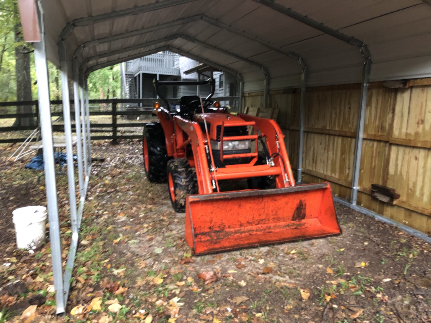

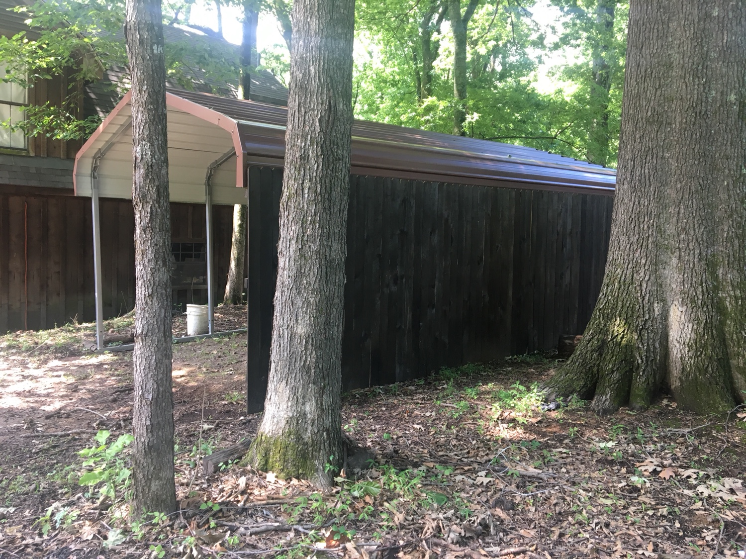

I love my metal carport. $710 delivered to my house.
Got 6’ wood fencing section, stained it and it blends in with the shop behind it!
Now that I have been told ALL L series Kubota tractors have the same key, I want to enclose the ends with at least a heavy duty bar that will prevent someone from driving off.....
